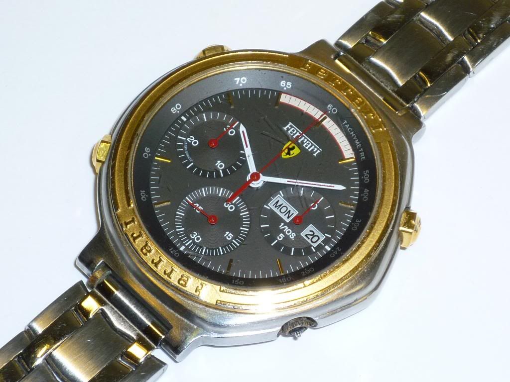

One of them is a Cartier Ferrari Formula belonging to Nathan Beehl. You may remember this thread, where I wrote back in January:
As I wrote in my email, it looks like I'm only going to be able to fix this one. My tentative plans to fit the Junghans pushers to your other watch have been kyboshed. I simply can't get the case-back undone. It's absolutely solid and won't budge, even with aerosol freezer.

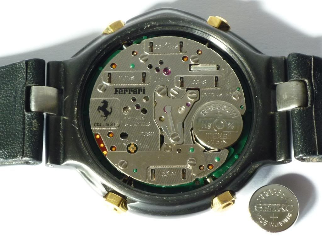

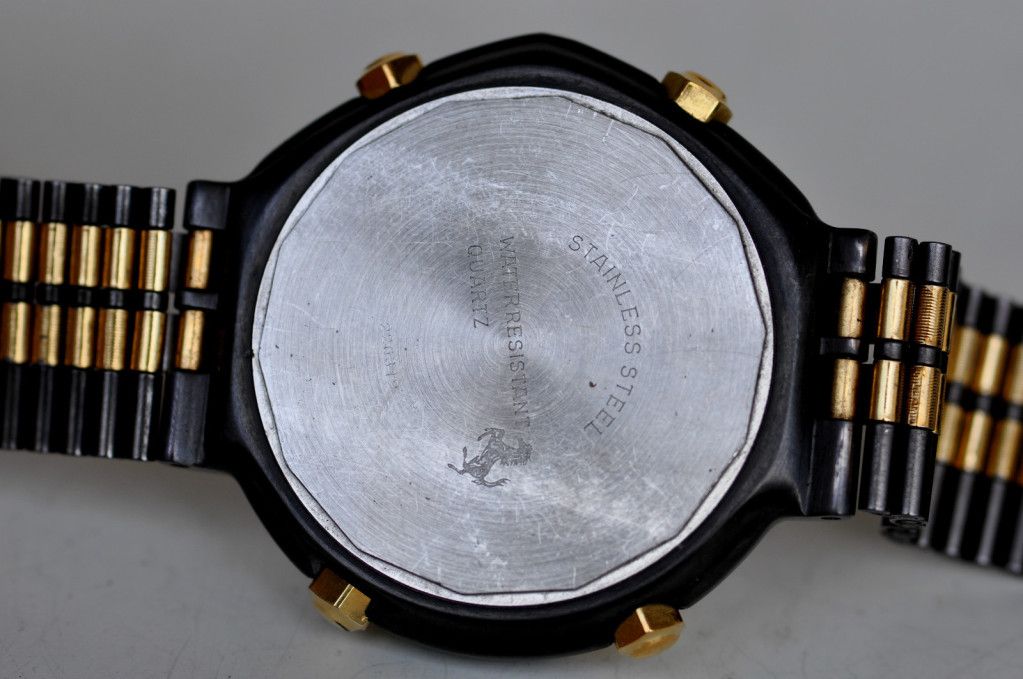

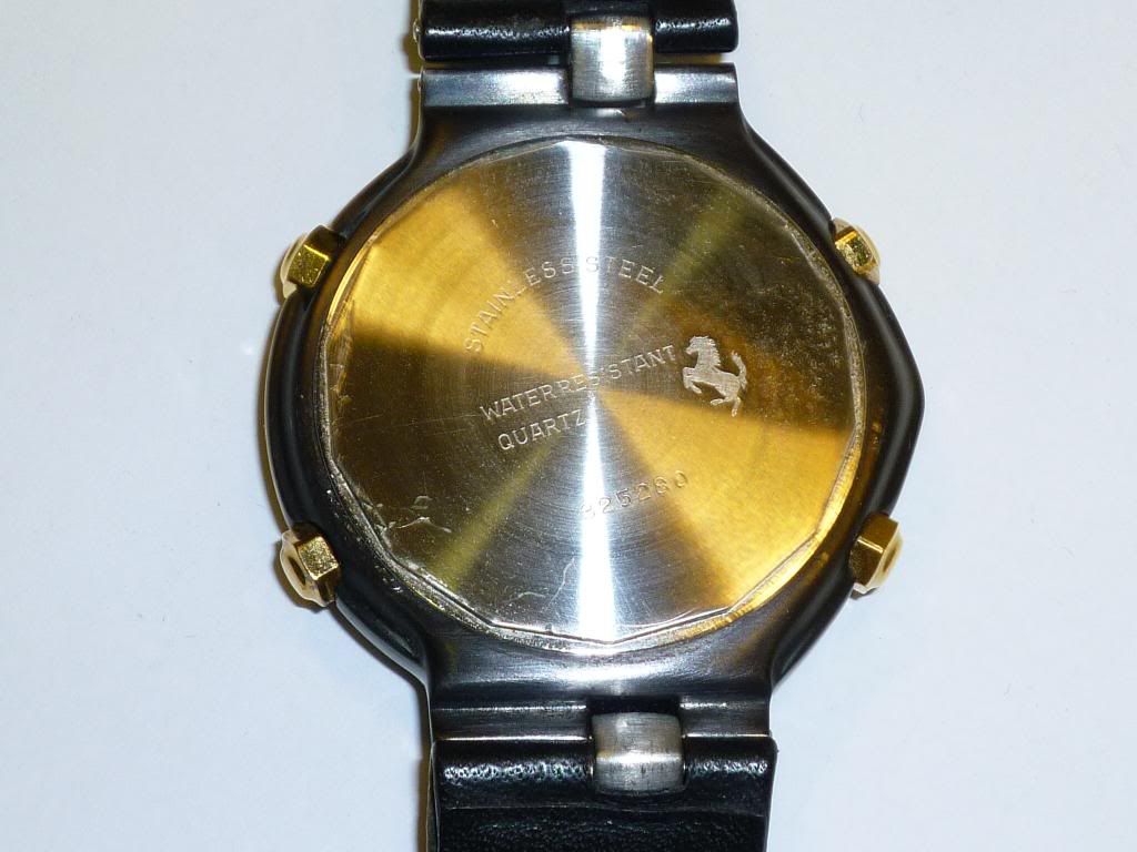

I suspect whoever refitted it (after the last battery change) used the proprietary Cartier case-back wrench - to extremely good effect. Apart from the fact it's done up murder tight, there are no extraneous marks on it at all. It's almost pristine - unlike your other one.

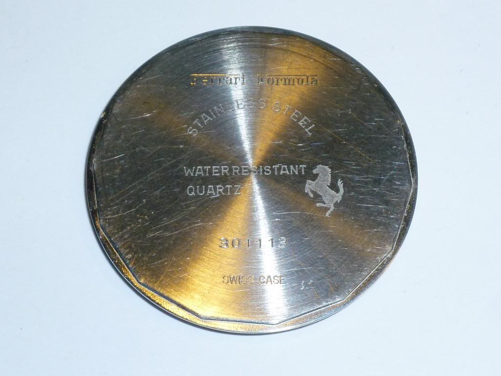

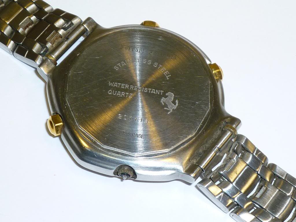

For those of you who aren't familiar with the Cartier Ferrari Formula case-back, here's a (library) shot of what they look like:
The circular flange sits flush with the back of the watch case. The very slightly raised area (<0.5mm) is a tetradecagon (14-sided) measuring 32.0mm across the flats. Basically, if it won't unscrew using a 'sticky ball', you need the proprietary Cartier wrench.

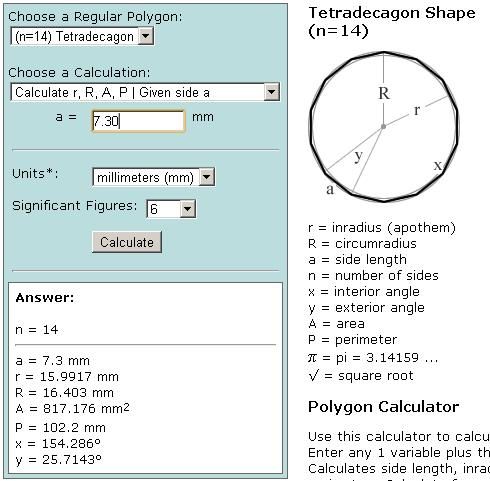

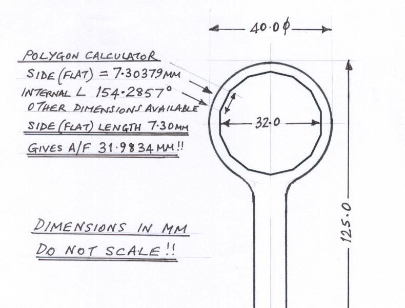

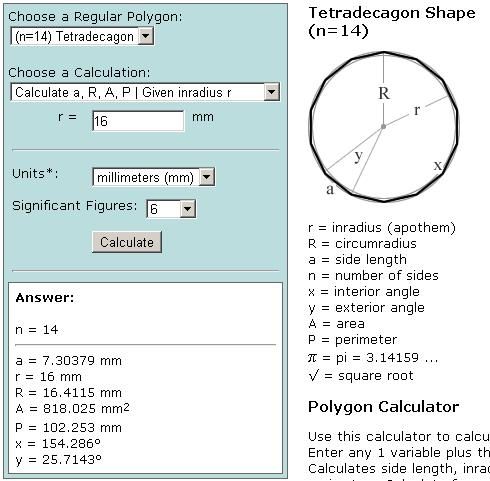

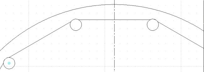

In February, I did my own 'back of a fag packet' sketch of how I thought such a tool might look:
The Polygon Calculator I used was similar to this one: http://www.calculatorsoup.com/calculators/geometry-plane/polygon.php
In a nutshell, it was going to look very much like one of those flat spanners you used to get supplied in bicycle tool kits years ago ....
Except that this one was going to be rather more precise. ;)
I'd planned to have the prototype made in 3mm thick 316L Stainless Steel using the EDM Wire Cutting technique - for accuracy.

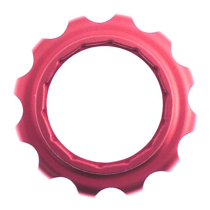

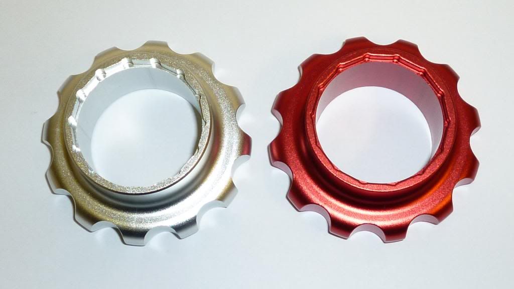

This morning, to my surprise, I received an email from Thomas:

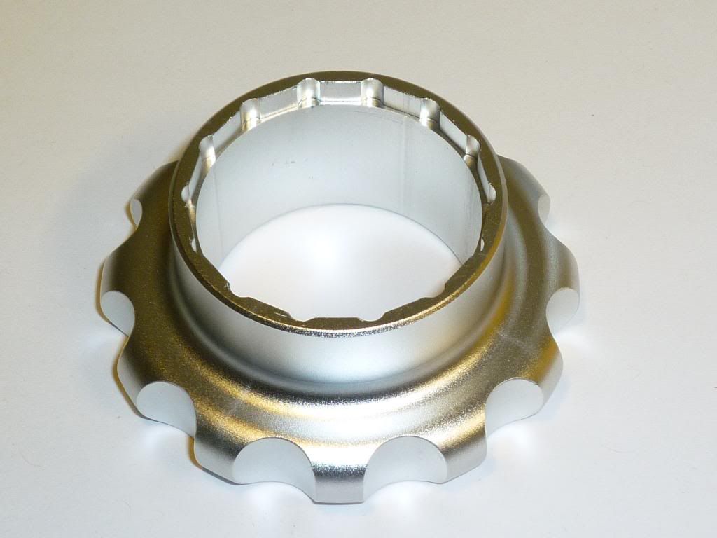

Hello Paul,
How are you ??? Good news for you, the Opener of Cartier Ferrari Formula is finished ( attached picture ).
The original plan had been to send the prototype case-back opener to BigglesMcLee in Hong Kong for appraisal. See his thread.
But as he posted on 2nd June that his watch is now sorted, I've asked Thomas to post it to me instead. I have the greater need. :D
September 28, 2013 at 4:55 AM Flag Quote & Reply
You'll note in the above photo that the WatchmeHK's prototype doesn't have precisely machined corner angles (as I'd have preferred).
This doesn't entirely come as a surprise. ;)
Back in March, prior to contacting Thomas, I'd been talking to Bryan Hibbins about my plans for such a tool. In one email, he wrote:
Paul,
I'd drill the corners out with a 1.5mm dia drill prior to milling the edges.
And would ask a good machine shop to quote for CNC milling. Gotta be cheaper.
You should easily be able to get a quote for £xx tops for machining up a few tools.
I know from past experience EDM can be VERY expensive. It used to cost the gaffer silly money when our firm had tooling EDM'd!
Bry.

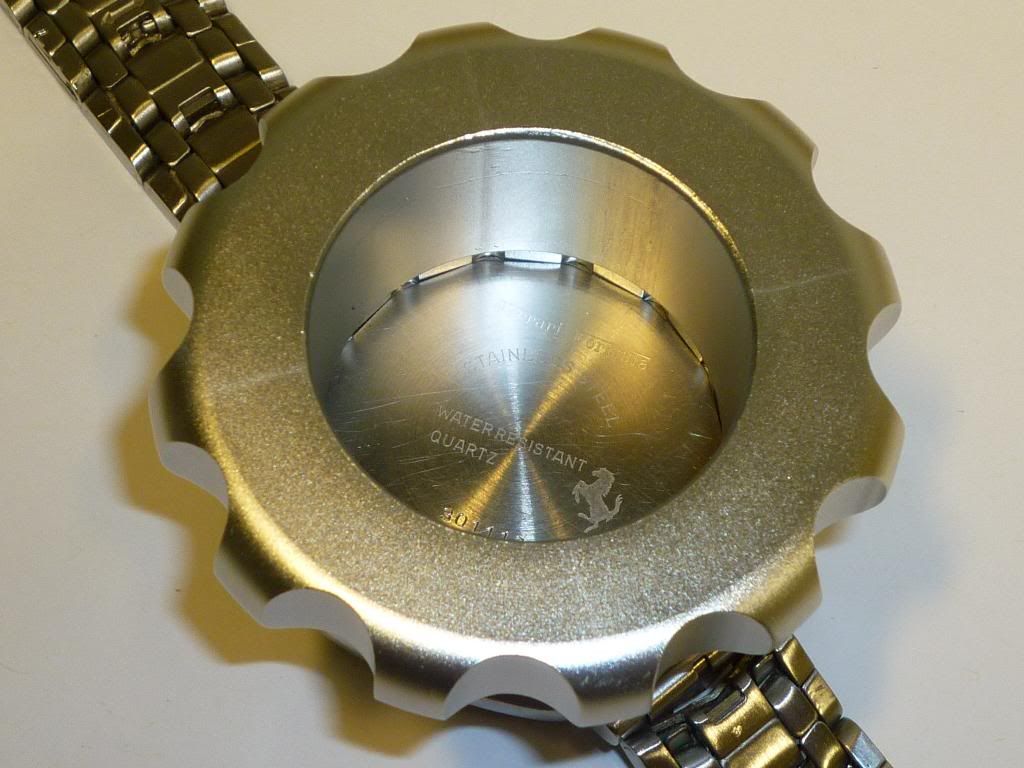

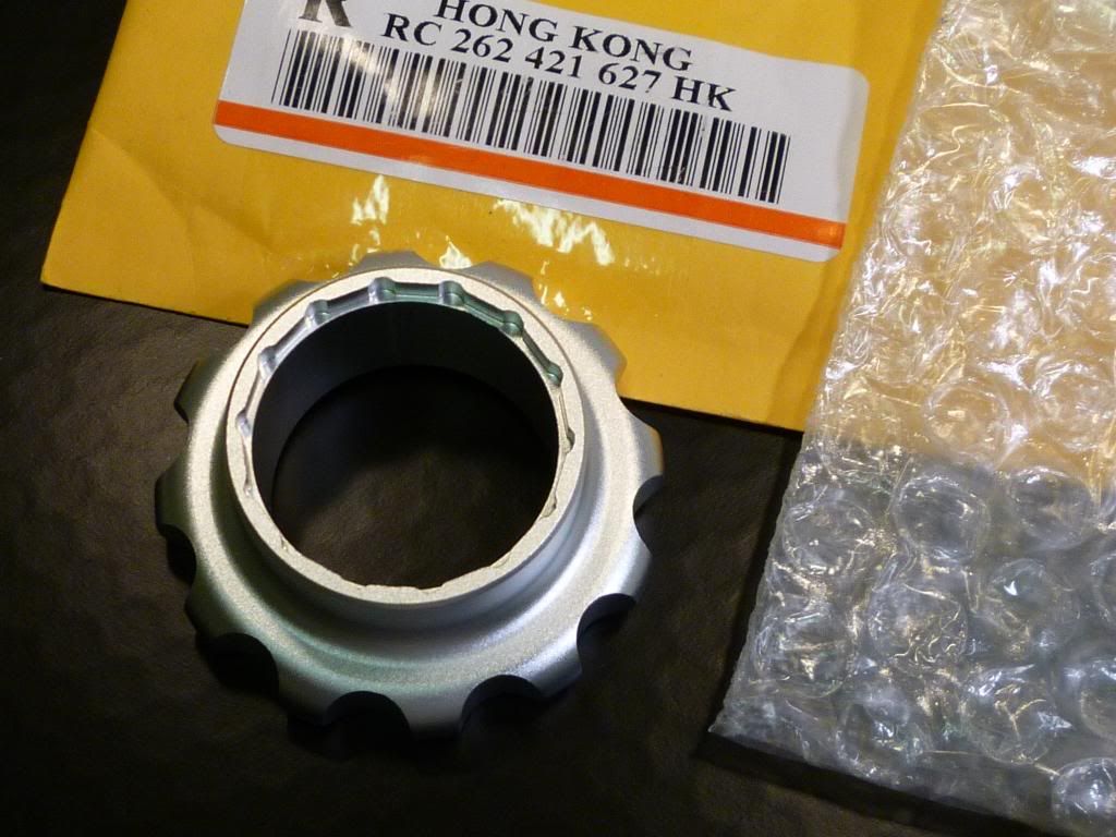

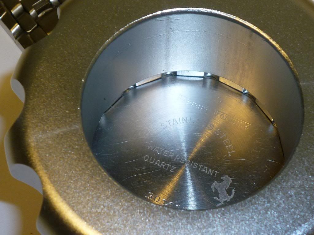

It's always nice to get packages in the post. :) This one wasn't exactly a surprise, but had taken rather longer to arrive than expected:
First impression is that it's well made, machined to accurate tolerances, a decent weight and fits nicely in the palm or between fingers.
I am going to make one small recommendation to Thomas, before he goes into full production with it. Of more anon. ;)
It's not likely to be before next weekend, when I give it the 'acid test' and attempt to use it to undo Nathan's recalcitrant case-back, but I was itching to try it out on something. So I selected one of my own Cartier Ferrari Formula chrono's - one with a case-back which was already a bit marked, deliberately. I'd bought this watch, which allegedly once belonged to someone involved in F1, on eBay for a very reasonable £205, back in September 2011. The gamble was that it was sold with a flat battery. Turned out to be squeaky clean inside.

At the time, the case-back had unscrewed fairly easily and once I'd replaced the battery, greased the seal and threads, I tightened it up, best I could, using a 'Sticky Ball'. But I was never completely happy that it was as tight as it could be. Here's how it looked before:
Here's how it looks now after using WatchmeHK's tool, with both watch and tool just held in my bare hands, to tighten it up a bit more:
Rotated almost another complete flat. :)

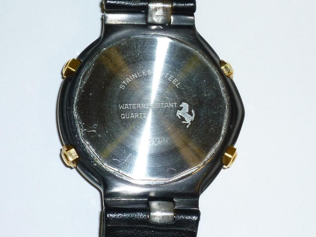

This is Nathan's other watch that is providing the (tough) challenge - also suffering from a missing pusher button (and a dinged one).
It has a few other issues besides, which I hope to be able to sort out in due course: a flat battery (normally the easiest thing to fix - IF you can get the case-back undone, that is) and scratched crystal. It's also badly fitted with a non-original after-market Rowi two-tone bracelet. This watch case, having the early style full width 12mm lug cut-out (and undrilled lugs) would originally have been supplied fitted with a notched leather strap. If I can figure out how to get the Rowi bracelet off, I may see if I can find something that fits better.
Here's a shot of that case-back, which had so far defeated my efforts to unscrew it. I'd tried a sticky ball (and using aerosol freezer, to make the threads contract, but wiping off the 'frost', before trying the sticky ball again). In fact I'd tried it a few times - all to no avail. :(

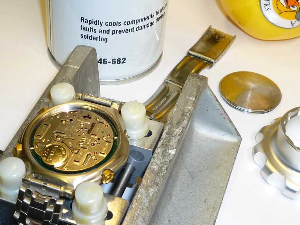

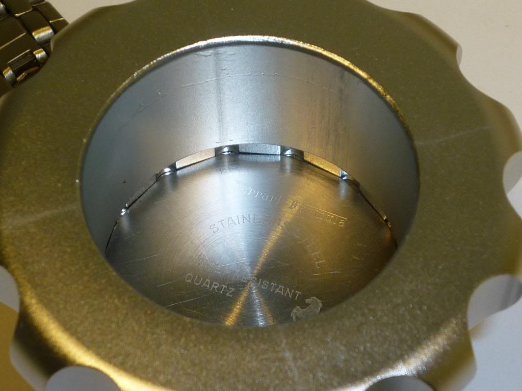

Knowing already that this case-back was screwed on absolutely solidly (God only knows how they'd put it back on that tightly, unless they had access to a proprietory Cartier case-back wrench), it was with some trepidation that I approached the task. Before I gave it any 'welly', I dropped the tool onto the case-back just to see how well it actually fitted. As I hinted before, there is some slight 'play'.
Rotated Clockwise:Rotated Anti-Clockwise:
November 9, 2013 at 1:02 PM Flag Quote & Reply
That radial 'play' looks a lot worse than it actually is, but I'll expand on it at the end of this series of posts. ;)

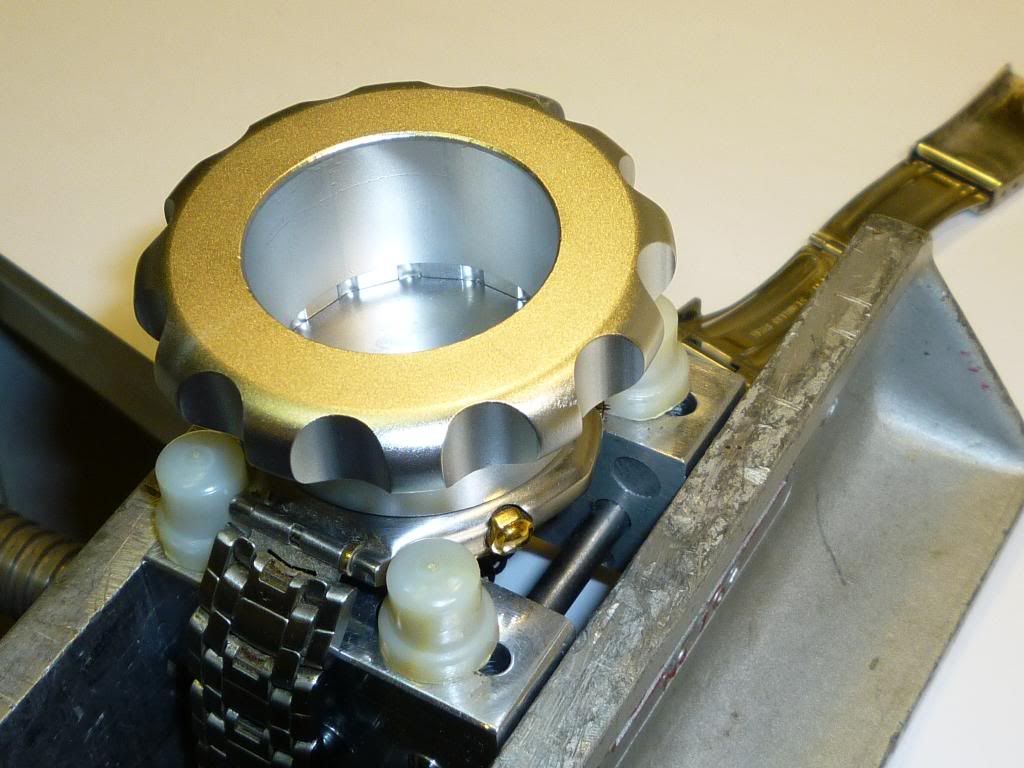

I first tried holding the watch in a towel (my palm open), with the tool held and rotated between my  fingers, gripping it tightly. No way.
Then I tried holding it in a watch case vice (in the same towel) - again no go. Then again, giving it a quick squirt of aerosol freezer. :(
There was only one thing for it - the same set-up I use when unscrewing obstinate Seiko 7Axx case-backs (using a Jaxa copy tool) -
Mount the watch case vice in a bench-mounted aluminium jawed vice (a Stanley No. 702); Give it some freezer and a LOT of 'welly'.
After a good l-o-n-g squirt of aerosol freezer (it looked like the Antarctic inside the case-back tool), and bearing down on the tool with both hands, to make sure it couldn't slip, I finally managed to persuade the case-back to unscrew. Perhaps it was because I didn't have the leverage you'd get when using a Jaxa 3-prong case-back tool, but it seemed like damned hard work for a minute or two.
November 9, 2013 at 1:25 PM Flag Quote & Reply
The prototype tool came away relatively unscathed after being given this 'ultimate test' - save for a couple of light marks on two facets:

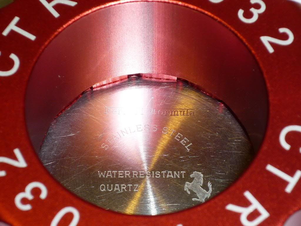

The case-back (once it had de-frosted) looked none the worse for wear:

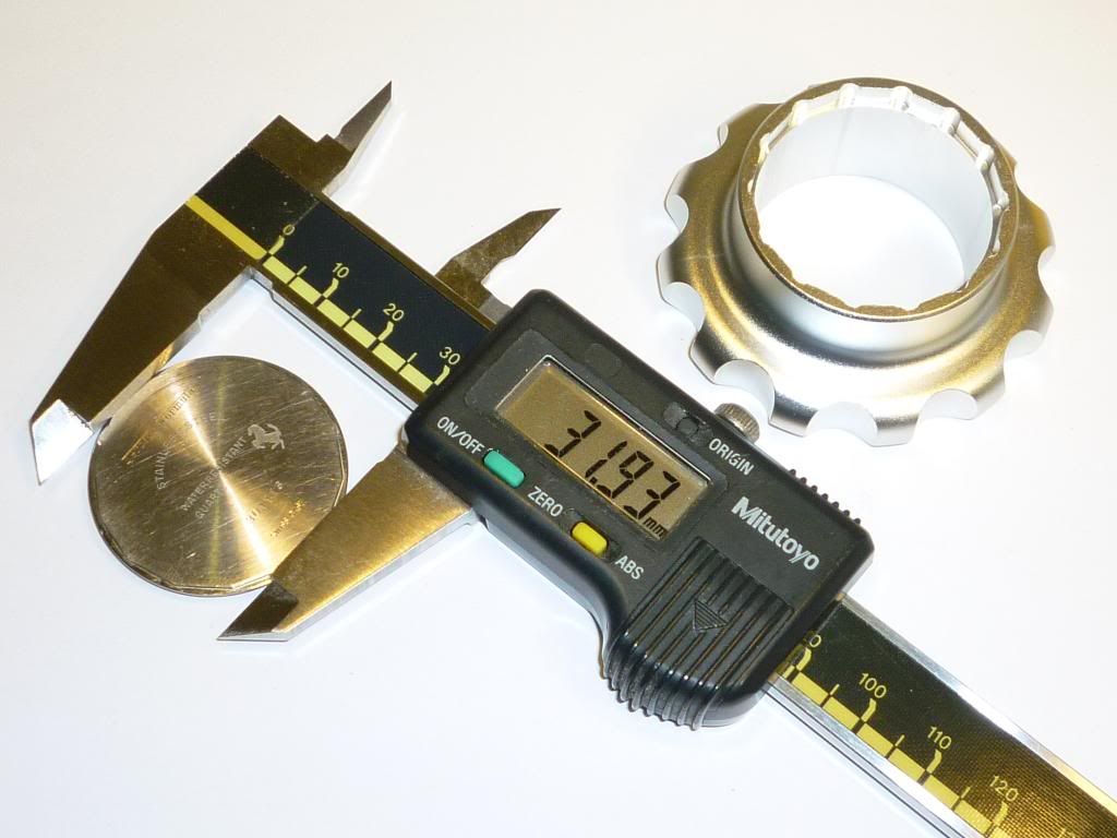

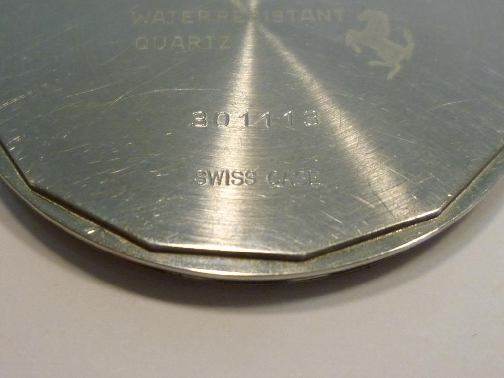

As a sanity check, I measured it across the flats and found that the smallest distance was 31.93mm (as shown by the vernier gauge).
The largest sides I measured were 31.98mm across. I then measured (best as one can) across the flats of the tool: 31.93 to 32.06mm.
So Thomas' machining tolerances are within +/- 0.06mm - which considering what he charges for these tools is quite respectable.

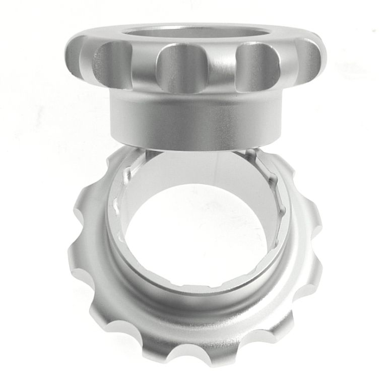

One consideration in designing such a tool, is that it needs to be relatively easy to fit onto the case-back by an amateur user.
The other issue is allowing for worn corners. Nathan's case-back still had reasonably sharp defined edges, but as with all of these, there's a slight taper to the edges - and that raised tetradecagonal area, which is all the tool has to act on, is less than 0.5mm high.
Where I would recommend this tool could be improved, is by considerably reducing the size of the corner drillings. As you can see from the tables in my second post, in 'a perfect world' the 14 inside faces of such a tool would measure 7.30mm. In Thomas' prototype tool, because of the over-sized drillings, the few sides I measured were only 5.0mm long. I believe by reducing size of the corner drillings, it should be possible to extend the inside faces to at least 6.0mm or maybe even 6.5mm, thereby giving the tool a better 'purchase'. ;)

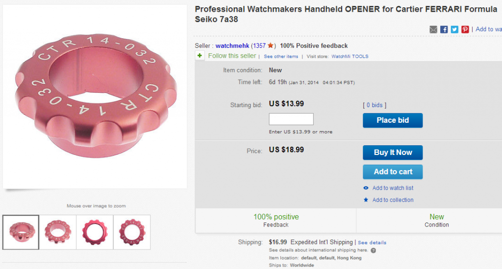

Well, perhaps I ought to change it to: Available Now !
http://www.ebay.com/itm/251433225527

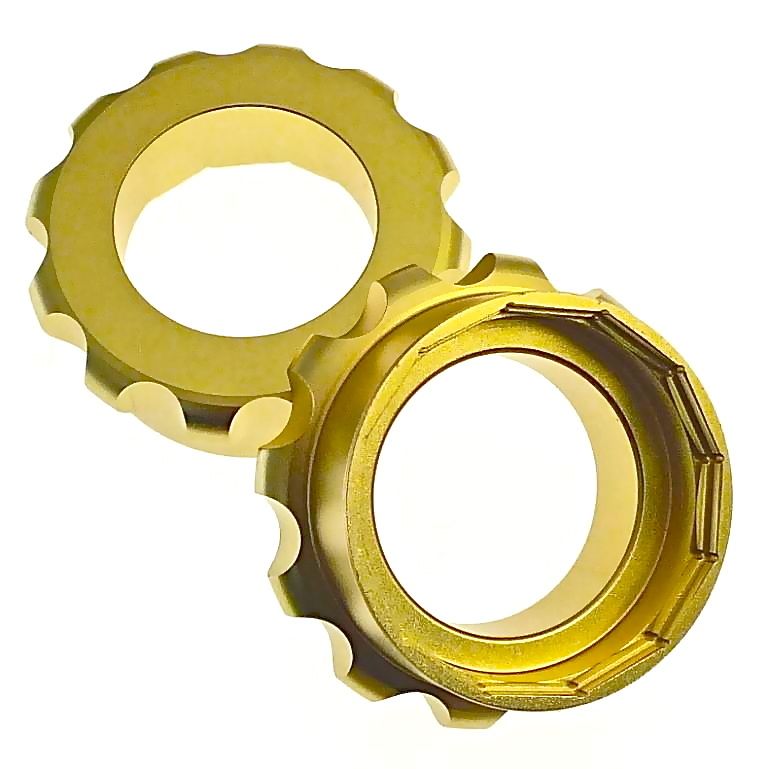

Looks like Thomas took on board my recommendation about significantly reducing the size of the corner driilings too.

Yes, perhaps the shipping charges are a bit excessive, Simon, but given the effort that Thomas had put into manufacturing the tool ....
I thought the least I could do was to order one myself - if only to see how it compares with his prototype tool. So I did. :P
It arrived yesterday. Here it is alongside the prototype. You can see the much reduced corner drillings / longer mating faces ....
The transition between the corner drillings and the flat edges of the mating surfaces is less well defined, but as best I could measure them, on the production tool they're each well over 6.0mm long - almost 6.5mm (as I'd suggested to Thomas in my last email).
As a result, there is absolutely ZERO evidence of radial play - compared to what I'd percieved on the prototype tool. :)
In fact, if there's any slight criticism to be made of Thomas's production version, the tool proved a very tight fit on this Ferrari Formula case-back I tried it on, as a test - I suspect partly due to the couple of extra thou' added by the lovely metallic red anodized coating.

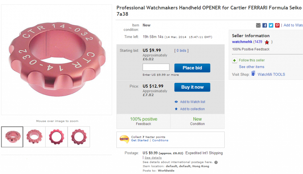

March 8, 2014 at 5:09 AM Flag Quote & Reply
Sir Alan at January 24, 2014 at 12:50 PM
Great news Paul.
Given the shipping charges are almost the same as the cost of the tool, perhaps we should be looking at a group buy?
Or just wait till Thomas drops the price (and shipping charges) a bit. ;)
http://www.ebay.co.uk/itm/251471015294
