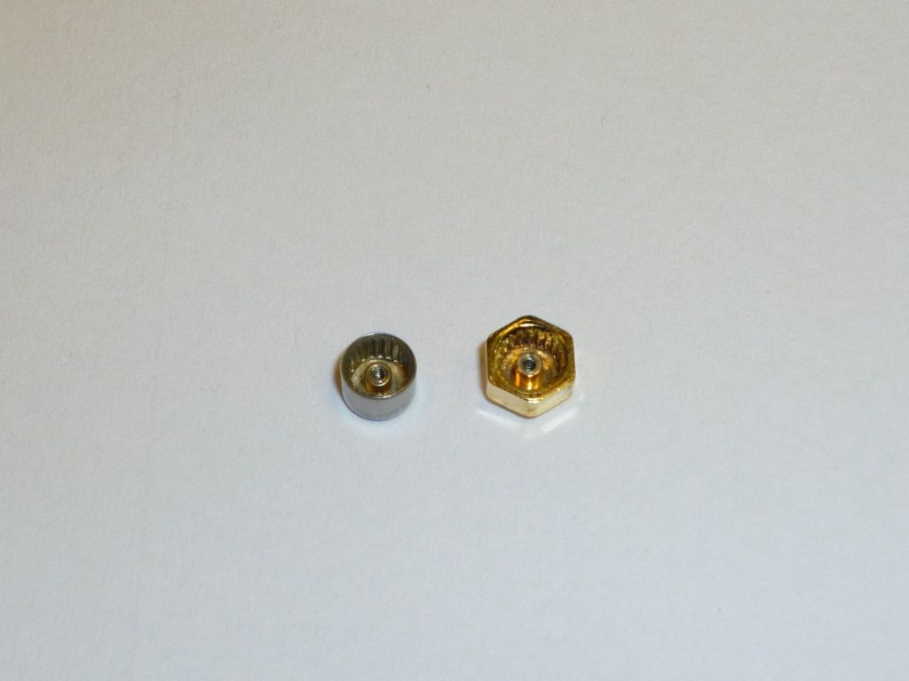

What gave me the (wrong) idea was seeing those vaguely similar-looking pushers with hexagonal ends, used on the 7A48-7010. :roll:
But, of course, the hex-head pushers used on the Cartier Ferrari Formula chrono's are of totally different construction / method of retention to Seiko 7Axx's. Funnily enough, some Yema N8's use a similar type of pusher to the Cartier Ferrari Formulas. At the time, Nathan Beehl ('Piloti') was talking about sending me one of his (he has two with missing pusher buttons), so I could have a look, and take some measurements, with a view to possibly getting some replacement pusher button caps machined up. He never did, and I'm not about to take one of my own apart (all 3 have their full complement), to find out how the pushers are fitted to the watch case, but I suspect they're the screw-in or press-in type; two-piece assemblies, topped off with that vulnerable separate gold-plated hex-head cap.

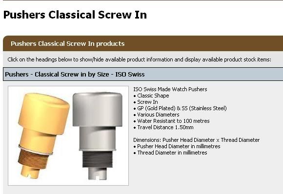

So what is he using as 'adaptable' replacement pusher assemblies ?
I'd hazard a guess at off-the-shelf ISO-Swiss pushers, something like these:
http://www.cousinsuk.com/catalog/4/660/725.aspx or possibly: http://www.cousinsuk.com/catalog/4/660/2031.aspx (if they do push in).
The screw-in pushers may be £17.95 + VAT each from Cousins (cheaper to the trade, obviously), but given the prices Philippe Boyer appears to be selling the watches for, even fitting three of them, it's still but a small dent in his profit margins. Food for thought.

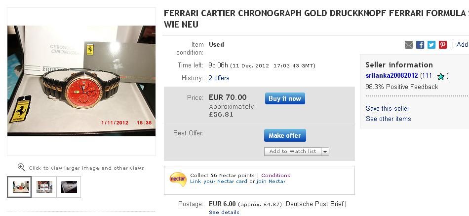

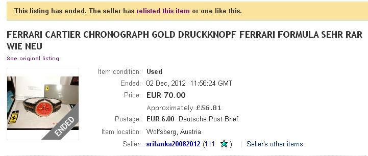

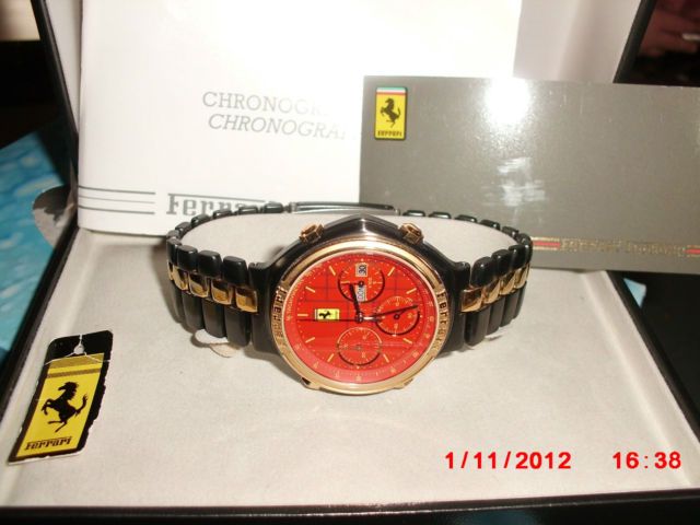

Interestingly, an eBay seller 'srilanka20082012', who appears to deal in Cartier Ferrari Formula chrono's, just added this new listing:
http://www.ebay.co.uk/itm/140893105023
Although a little confusing at first glance, because the first photo is from another of his recently ended auctions:
This listing is actually for a (presumably single) used spare pusher (or crown). See his third photo:
The description is vaguely worded (typical of this seller); see the Q&A from a German potential buyer  :roll: - but translates roughly as:
Here offer only the pusher button for all FERRARI CHRONOGRAPH very rare and hard to find.
Only the golden button is being sold. A value-enhancing part for the watch when all are original.
A bit steep (understatement) at 70 Euros apiece, but I'm sure there are a few owners who'll be willing to pay his price for 'originality'.
December 2, 2012 at 6:49 AM Flag Quote & Reply
Well that didn't take long. :roll:
Re-listed almost immediately: http://www.ebay.co.uk/itm/140893342680 and once again: http://www.ebay.co.uk/itm/140893412246

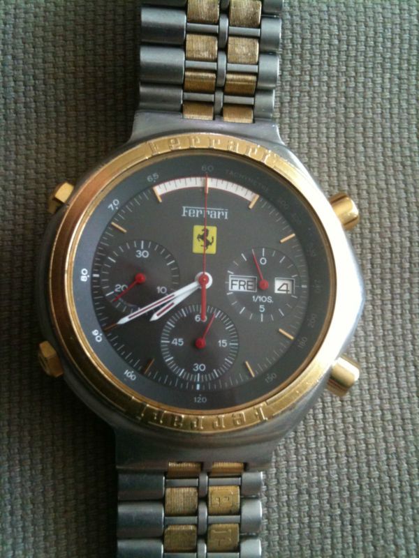

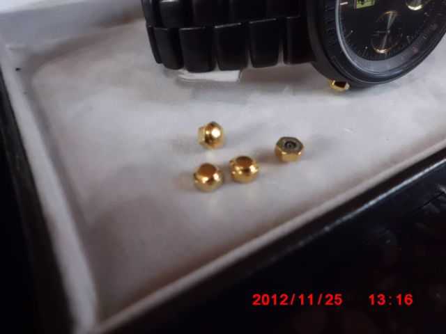

As I mentioned in my first post, I'd been talking to Ferrari aficionado Nathan Beehl about his Cartier Ferrari Formula chronographs.
He had two of the same model, both missing a hex nut pusher cap. We later discussed the possibility of robbing one pusher from the 'lesser' of the two watches to make good the other; then fitting the 'lesser' watch with two aftermarket pushers. We hadn't spoken in a little while, and unbeknownst to me, Nathan had bought two of those pusher buttons from German eBay seller srilanka20082012.
I had a look through their feedback; didn't spot Nathan's eBay ID, but did notice a comment left by another buyer 'f512bbcartier':
good but would like the pin associated with the druckknopf, I would pay for it. Hmm. Interesting.

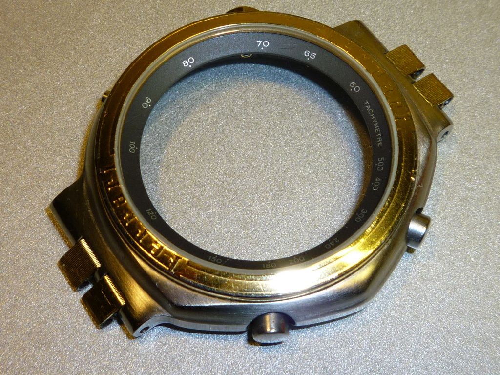

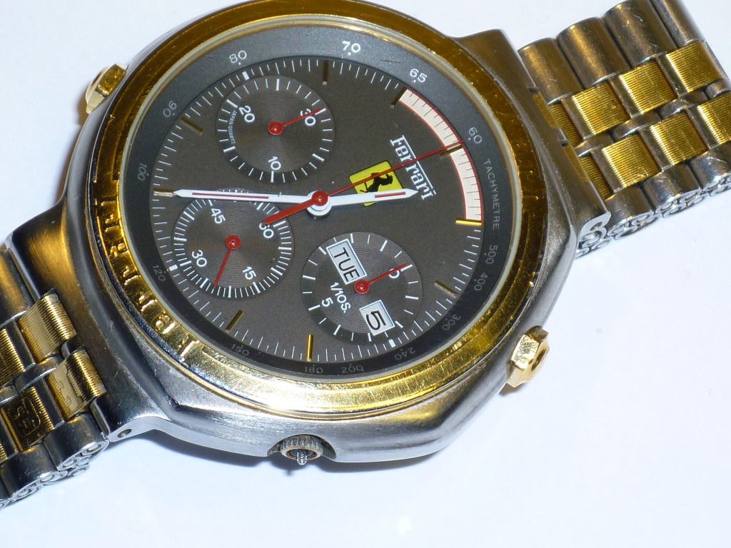

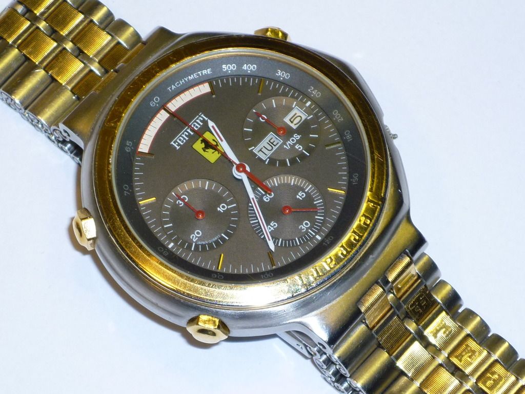

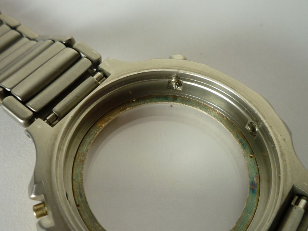

They're both the same model; both missing the hex nut pusher cap at 4 o'clock. This is the better of the two (on the original bracelet):
January 16, 2013 at 5:51 PM Flag Quote & Reply

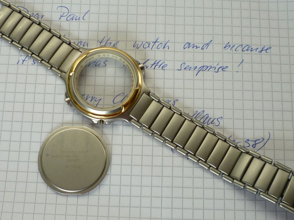

From all the various eBay listing photos I'd seen of Cartier Ferrari Formula chronographs with missing pusher buttons, I still hadn't quite been able to discern exactly what I was looking at - but now I know. I was particularly pleased with my second photo above. 8)
These pusher assemblies are very similar to those used on the Junghans High Tech 24/4610 (another re-branded '7A38').
Except the Junghans pusher buttons are much smaller. In fact, this style of screw-in pusher is quite common (except on Seiko 7Axx's).
The outward facing portion of the main pusher housing is splined, and screws into the case using one of these type of tools:

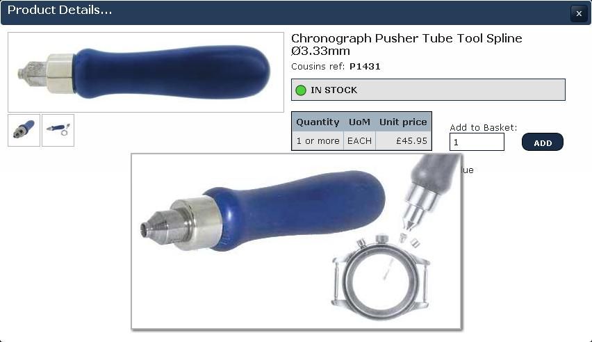

http://www.cousinsuk.com/catalog/tools/pusher-or-tube-removing-and-fitting-tools/chronograph-pusher-tube-fitting-removing-tools
Unfortunately the Cartier Ferrari pusher body's splines measure 3.3mm Ø rather than 3.0mm Ø, so that means this one:
Fortunately, thanks to Nathan having bought a couple of original buttons, it now looks like I'm not going to need to invest in one. :D

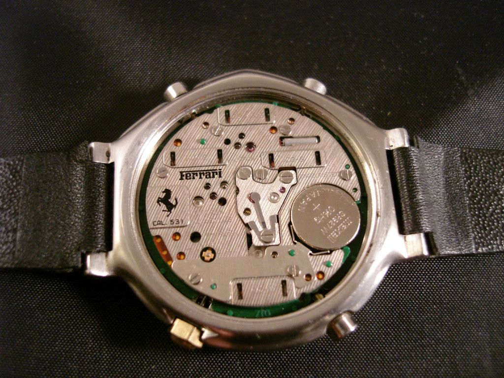

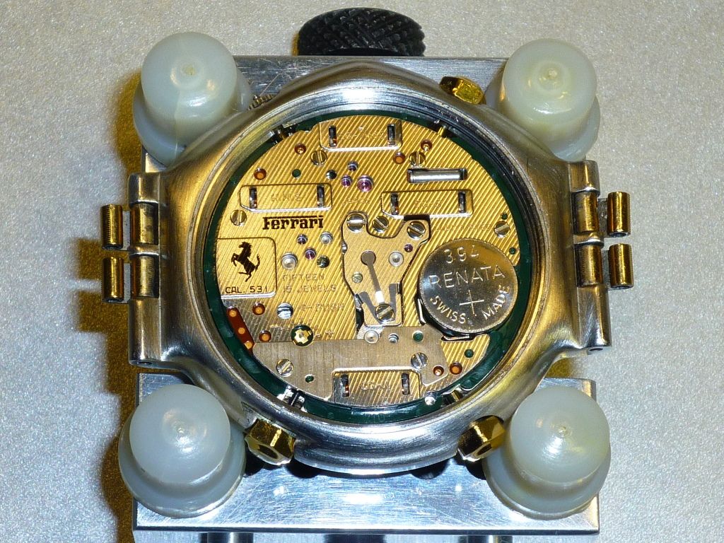

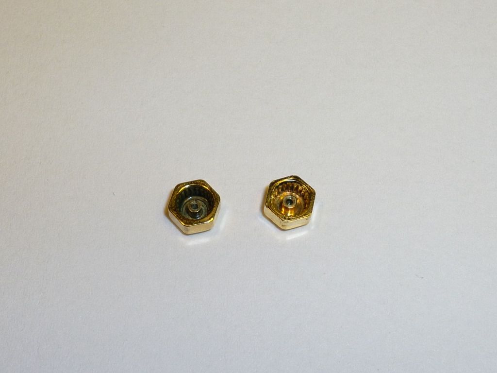

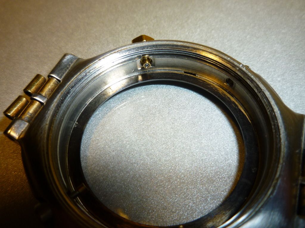

I suspected that the button on the right was actually a crown, rather than a pusher button - but until I dismantled Nathan's watch, which I did this afternoon, I couldn't say for certain. I've chucked in a couple of extra photos for Nathan's benefit, as much as anybody else's.
Unfortunately the usual caveat of lack of natural daylight applies, hence my use of flash - my apologies for the low quality.
I'm pleased to say the case-back of this one unscrewed fairly easily, just using a sticky ball (without recourse to aerosol freezer). :)
I've removed the bracelet by splitting it at the first link, rather than pushing out the case joining pin, because these come out easier.
Nice clean movement. At the bottom of the case you can see the crown / stem thread and a pusher shaft making contact with the lever.

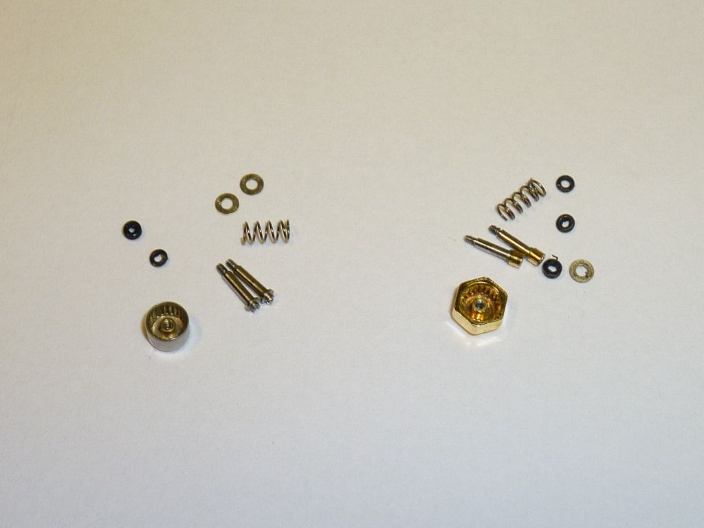

The ends of the pusher shafts are exactly what I'd expected to find, with a small screw slot - just rather smaller than I'd anticipated:
I removed the two o'clock pusher button and shaft components from Nathan's watch to compare it with the spare button supplied:
The one on the left had since been soaked in WD40 for 24 hours, in a semi-successful attempt to remove the verdigris. If I'd paid as much as Nathan did, for a secondhand pusher in that condition, the eBay seller would have received a scathing negative feedback. :mad:
By comparison, the pusher button on the right, that came off Nathan's watch, barely needed 5 minutes in the ultrasonic cleaning tank.
On the right of the next photo is the crown and stem removed from Nathan's watch:
I was hoping it would be the same as the other pusher button supplied him by 'srilanka20082012' (which I believe is actually a crown).
They're different: Nathan's crown has just a white nylon 'Hytrel' gasket, whereas the other one has a larger diameter 'Hytrel' gasket, plus an O-ring fitted. I suspect it's a later manufacturing variation for improved water resistance. The (longer) post length are both the same and this one supplied to Nathan as a 'pusher button' doesn't have the internal splines - so it can't be anything but a crown, IMO.

Here's a photo I took when I was working on one of mine, back in December 2011. The pusher screw slot on these is slightly larger.
I'd bought a second Junghans High Tech 24/4610 in November 2011. As a complete surprise and a very generous gesture, the German eBay seller, Klaus 'bergjodler58' enclosed an additional almost mint case and bracelet with it, completely free of charge:
So after I'd re-built the watch I ended up with a couple of spare pushers. Well, almost enough components. I lost a couple of bits. :(
The next photo shows most of my spare Junghans pusher components (on left), compared to Nathan's Cartier Ferrari bits (at right):
Just the two pusher buttons:
Here's two of those Junghans pusher buttons loosely trial fitted to Nathan's watch case (using the Cartier Ferrari pusher shafts):
January 19, 2013 at 1:22 PM Flag Quote & Reply

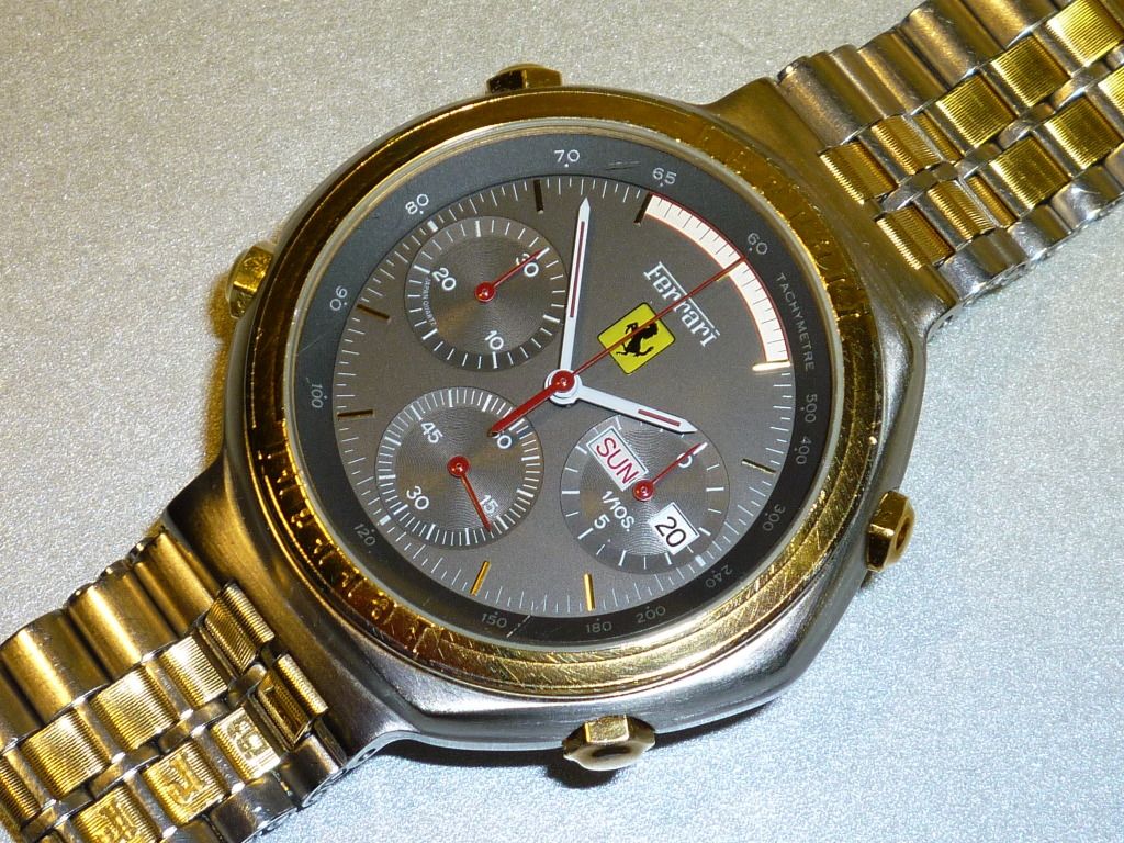

If you've studied the photos of Cartier Ferrari Formula chrono's which I've posted in the earlier part of this thread (as examples), then you'll possibly have noticed they were all black anodised finish and had been fitted with gold plated replacement round pushers.
I've since gone through my various Cartier Ferrari sub-folders of (hundreds of) photos of that I've saved and haven't found any others.
(That is apart from this red-dialed 'bitza' currently offered by Chronographe.fr, which we'd already discussed in the other thread).
A couple of weekends ago, when I was 'experimenting' with one Nathan's watches, I suggested that it might be possible to use another brand's (specifically a Junghans High Tech 7A38) pusher caps in place of the Cartier Ferrari 'hex nut' pusher buttons (as opposed to swapping the complete pusher assembly) - as a cheaper and simpler solution. Nathan's watch is a stainless two-tone; the Junghans' pushers I trial fitted were silver anodised stainless. They not only fitted easily, but worked - both functionally and aesthetically, IMO.
Lo and behold, less than two weeks after I'd posted that photo, a Cartier Ferrari Formula was listed by a US eBay seller ....
and was almost immediately flagged up by another member in this (subsequently re-titled) thread in the eBay forum section:

The eBay seller's description sounded deliberately vague:
Vintage Ferrari Chronograph watch Stainless and gold color case, Please look at the pictures as they illustrate the cosmetic condition of the item. keep in mind the item is used and has some minor scratches. Item is sold as is without return, so be certain you want the item before bidding. It is working and the chrono functions work as they should. Based on what I have looked up online this particular model was made By Cartier however I have not seen any markings to that effect on the case or the movement, but please do your research before bidding. The watch keeps good time and works great, but I am selling as is and as found. It measures approximately 41.00mm by 45.00mm lug to lug. Thank you and good luck.
No mention was made of the three replacement pusher caps fitted. Here's just a couple of the dozen listing photos:
Obviously just a complete coincidence, Right ? :/ As the saying goes: Imitation (read plagiarism) is the sincerest form of flattery.
So go ahead - call me a cynic if you like. See if I care. :P
Hello friend,
I'm looking for pushers for FERRARI FORMULA by Cartier, hexagonal gold pushers, if you have this parts available or a web adress for buy it ?
Thanks for response
Brgds/ Toscane
