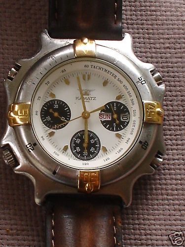

This is a Kamatz 517000 I bought on eBay recently. From the seller's description I had a feeling it was going to need a bit of work:

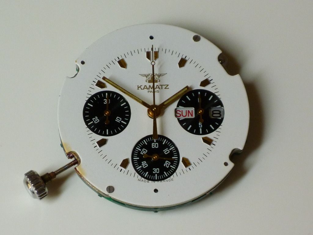

Although the watch is roughly the same overall size as the Cartier Ferrari Formula (40mm across), the crystal and dial face are much smaller (visible) diameter. However, pop the movement out, and you'll find it's exactly the same overall 31.2mm diameter, and that the subdials (which are much smaller than those in either your 7A38-7000 or Cartier Ferrari Formula) are on the same 15.0mm centres.
Note the two small screws which hold the dial to the movement. The cut-outs on the Kamatz dial will be very similar to those of your Cartier Ferrari dial. The two small holes in the dial at 12 o'clock and 6 o'clock are to locate the plastic Tachymeter dial ring spacer.
As you can see from the photo, the movement has suffered from water damage - ingress through the screw-down crown. :roll: I've got everything working now (including the rusted-up pushers in the watch case), but I think I may still have to do a full strip and re-build.

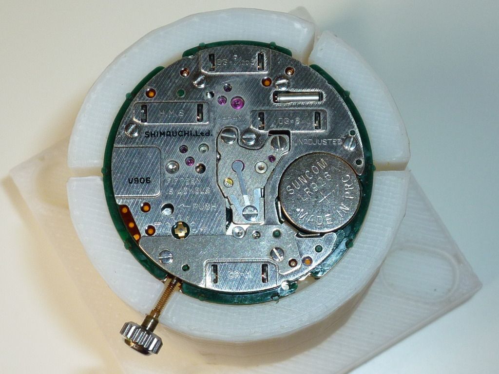

Here's a shot of movement from the other side:
Note this movement is printed Shimauchi Ltd. V906 in the same places where yours has Ferrari, Prancing Horse logo and Cal. 531.
This differently signed version of the 7A38 movement was used by C.G.H. (in effect Seiko France) in the Yema, Jaz and Kamatz N8's.
You could directly swap all and any components between this movement and a Seiko 7A38(A), Ferrari Cal. 531, Orient J3920, etc. ;)
