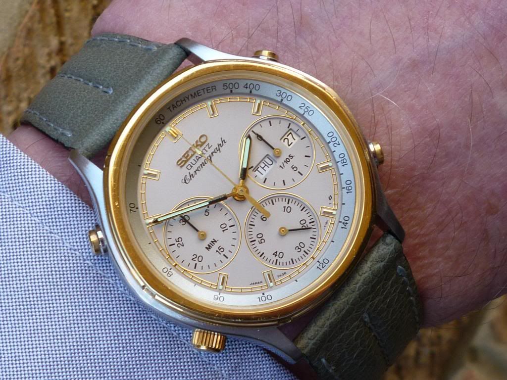

Maybe this isn't exactly the right thread for this post. :/
Perhaps I should start another thread just to flag up all the two-tone 7A38-7020's, -702A's and -702H's that I see with this 'botch'. :roll:
http://www.ebay.co.uk/itm/281163646855
Here is beautiful vintage Seiko Sports 100 Analog Chronograph 7A38-702H in great condition. It very heavy, all stainless steel. This watch is a really cool, all functions work well. During the 80's they were selling for around $600. The crystal is brand new, and it has been recently serviced by certified watchmaker. This watch has one of the best movements Seiko ever made. This watch is build for lifetime! The original band was damaged but is easily replaced with one of your choosing with a measurement of 10mm in between the lugs. It has multiple functions, stopwatch, tachymeter,day and date and is stylish to boot. Happy Bidding!
What the seller fails to mention in his description is that all the presumably worn gold plating has been polished off the bezel, leaving the little gold dummy rivets. Which can look really cool - and indeed this one appears to have been done nicely - but it ain't right !
September 6, 2013 at 3:03 PM Flag Quote & Reply

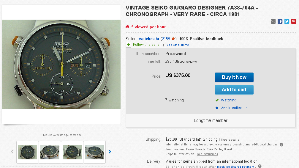

Just spotted this completely stripped 'stainless' 7A38-704B listed on eBay.com by Filipino arch-watch-botchers apol_of_your_eyes.
http://www.ebay.com/itm/370982416794
I guess that makes it authentically buffed then !

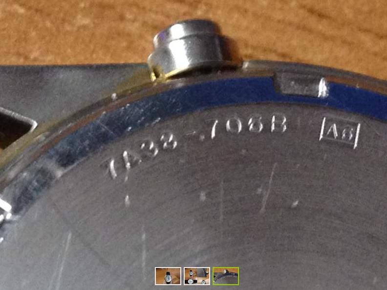

Be very careful of this one listed on eBay Italy earlier this evening - it's not quite what it seems.
To the uninitiated, it may, at first glance, look like a stainless 7A38-7060 (on an incorrect bracelet), but it's not - look closer ....
http://www.ebay.co.uk/itm/221454992344
Dalla mia collezione privata vendo:
Cronografo Seiko 7A38, 15 rubini, cassa e bracciale in acciaio (non dell'epoca), con quadrante intatto silver.
Il diametro è di 39mm, esclusa corona e pulsanti. Giorno della settimana in italiano e inglese.
Funziona perfettamente. Le foto sono dell'orologio in vendita e sono parte integrante dell'inserzione.
The first clue that something's not quite right is in the apparent colour of the edges of the dial batons and centres of the main hands.
Notice the (wrong) direction of the brushing on the bottom right hand lug in the above photo.
The damning evidence is in the seller's last photo, showing the case-back stampings: 7A38-706B BASE METAL ST. STEEL BACK.
It was once a gold-tone 7A38-706B, like this:
Except it's been almost completely stripped of its gold plating. Look closely and you can still see a couple of tiny traces they missed.

To quote myself from higher up the page:
Maybe this isn't exactly the right thread for this post:/
I still haven't. :roll:
In fact, there have been so many two-tone 7A38-702x's listed on eBay over the last year or so, with stripped bezels, it got to the point where I assumed most readers would recognise such a modified watch if they saw one, so I simply haven't bothered mentioning them.
Here's a classic example on eBay Germany at the moment, which was first listed at the end of November.
http://www.ebay.co.uk/itm/151493301227
Quite nicely done too - maybe the top surface face of the bezel could have done with another couple of thou' skimming off to remove all traces of the old gold plating (between 2 and 4 o'clock). Regardless - it's stupidly over-priced, so it shouldn't tempt anybody.

For those not familiar with the model (there are plenty of photos in the WRUW thread), here's a couple of my two-tone 7A38-7260's.
On the correct original Seiko grey leather strap:
and on the light grey lizard strap which I prefer:

Crikey. It's been over a year since I've updated this thread. I guess there may have been a few 'horrors' offered by the usual Filipino watch botchers that I've omitted to mention in the interim. But I couldn't let this over-polished turd, purporting to be a 7A38-704A, listed yesterday evening by the arch Brazilian watch botchers, pass without comment. The grey PVD over black chrome coating has been almost completely stripped and the whole watch polished in the best Filipino watch botching manner. I say 'almost' because evidence of the watch's original finish remains on the crown and in the joints between the bracelet links. Truly an appalling mess. :(
http://www.ebay.co.uk/itm/262222818682
There can really only be one question: Why ???????? :lol:
If anyone reading this post is in any doubt as to how this watch might once have looked (in its correct original grey PVD finish) ....
Check out: http://www.ebay.co.uk/itm/181975003135 - It may be ludicrously over-priced, but it serves as a decent example. ;)
