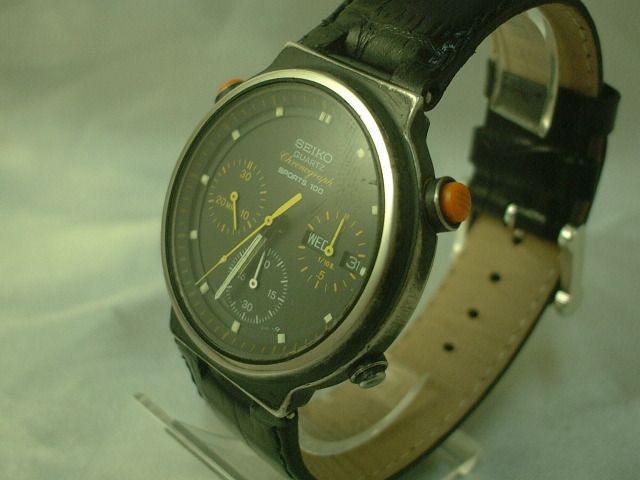

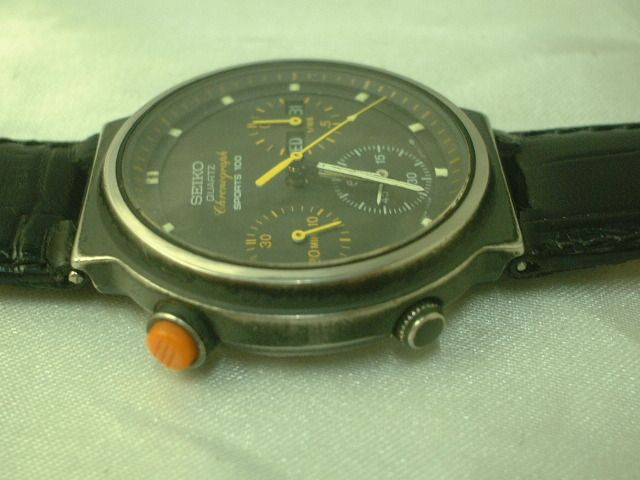

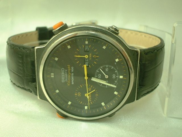

A number of people have fitted them with leather straps (notched in the middle). This is a 7A38-704C:
Can't say it looks particularly good, but it'll get it back on your wrist.

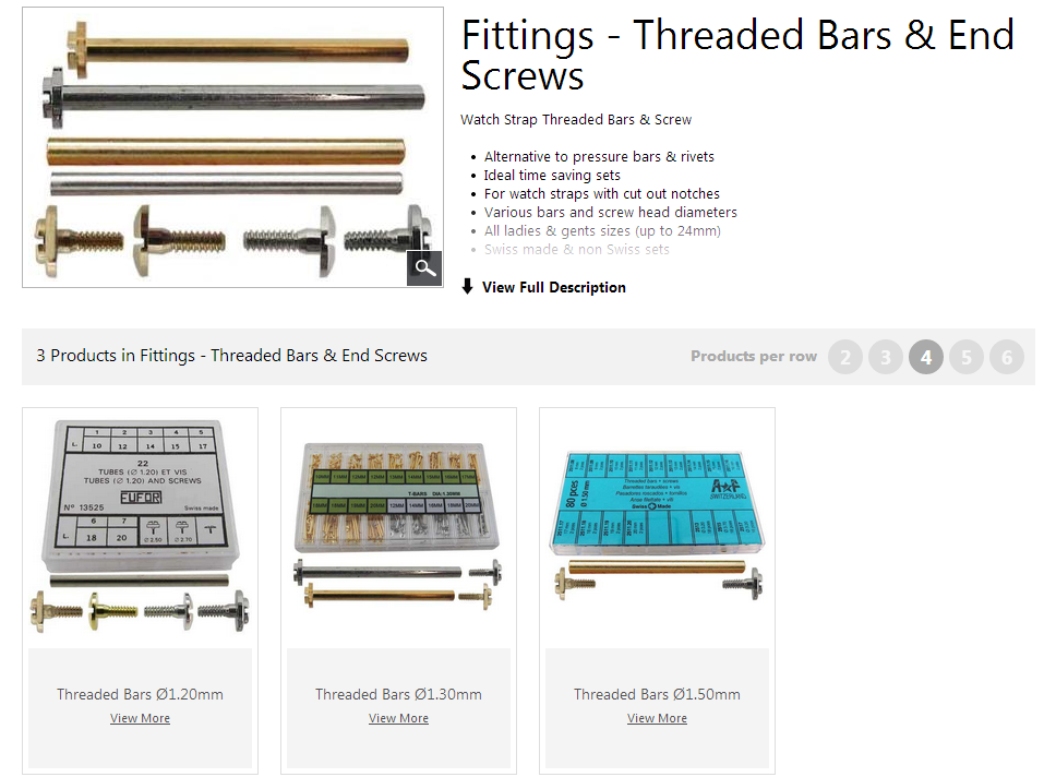

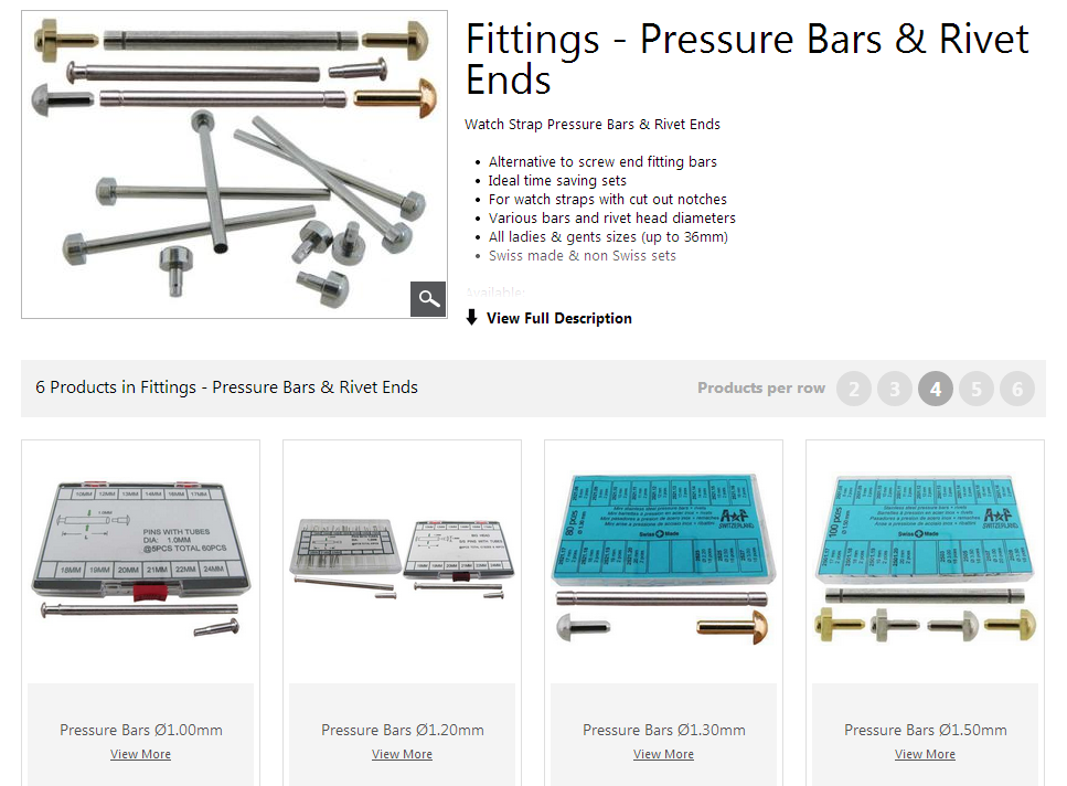

I'd recommend using threaded screw bars. Cousins UK offer a variety of sizes / styles and lengths:
http://www.cousinsuk.com/catalog/watch-straps-bracelets-fittings/fittings-threaded-bars-end-screws
The watch case (bracelet) fixing tubes on the 7A38-704x will accept 1.2mm diameter. ;)
As stated on Cousins' page, you could also use pressure bars and rivets as an alternative fixing. In fact that might be a tidier solution.

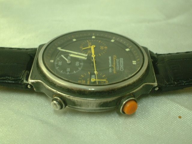

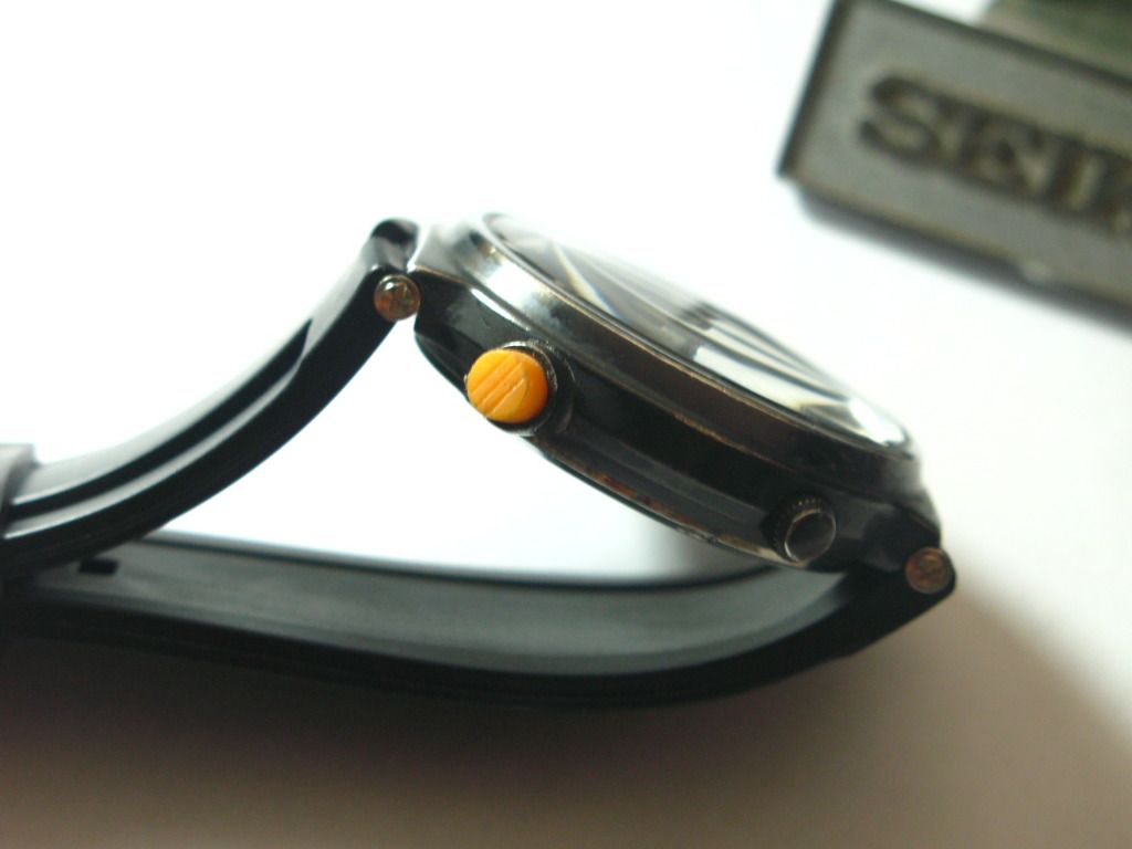

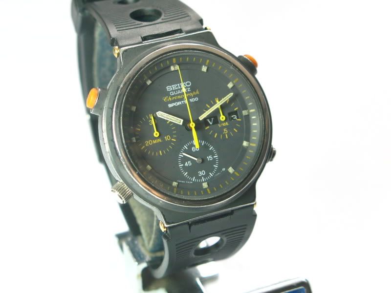

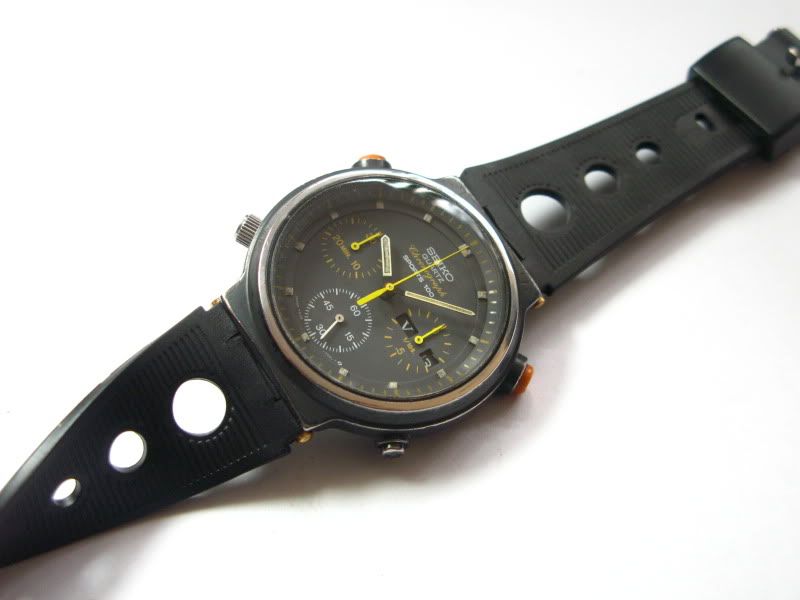

On this tired 7A38-704A offered by José 'Watchcooking' Sotto in February 2010, fitted with a rubber strap, he'd used Pressure Bars:
But on this similarly tired-looking 7A38-704A (with a homemade pusher) on a rubber strap in July 2011, he used Threaded Bars ! :lol:

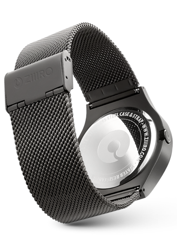

How about the grey PVD 21mm? wide 'mesh' bracelet used on the Ziiiro Celeste for example ?

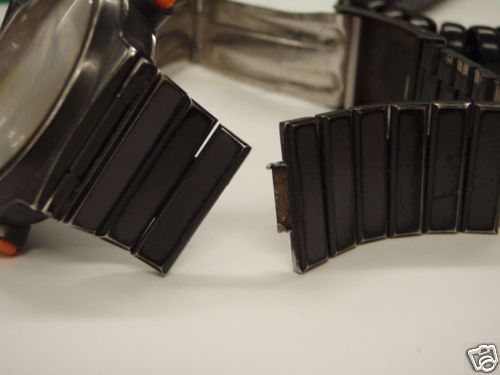

This thread reminded me of a tatty 7A38-704A listed on eBay in January 2010 by a UK seller.
I remember trading a few messages with the seller at the time. He even asked me if I could repair it for him at one stage. :|
His bracelet wasn't so badly stretched, but he'd caught the bracelet on something and ripped one connecting link clean out. :(

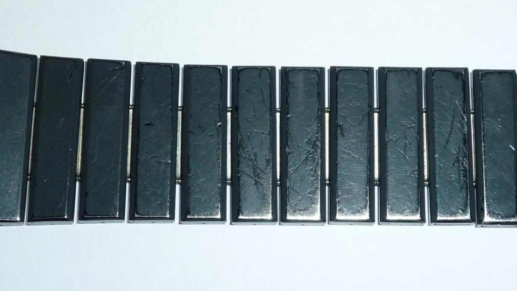

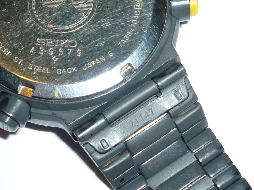

They do stretch though. This is the bracelet on my 'yellowed' 7A38-704C 'beater'. It's still eminently wearable, but I treat it with care.

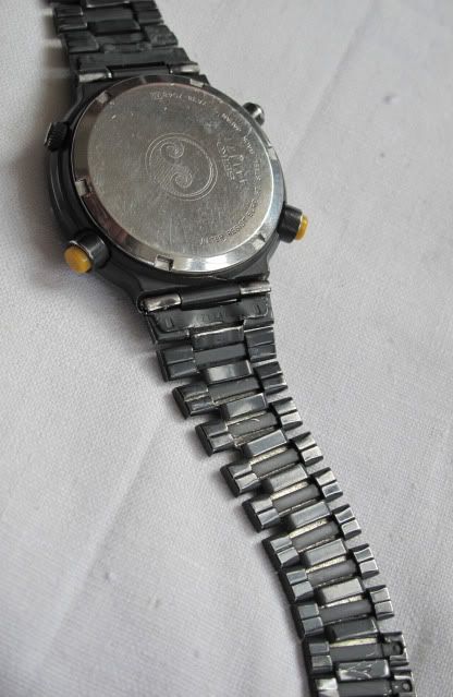

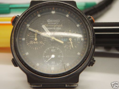

This is the most badly stretched (and still not broken) Z1147 bracelet I've ever seen. Offered by some wishful German on SCWF. :roll:
If you can't remember where that photo came from - and you fancy a good laugh :lol: check out this old thread:roll:

So we need to look at other possible alternatives. Hence my tongue in cheek suggestion above of the ZIIIRO Celeste bracelet.

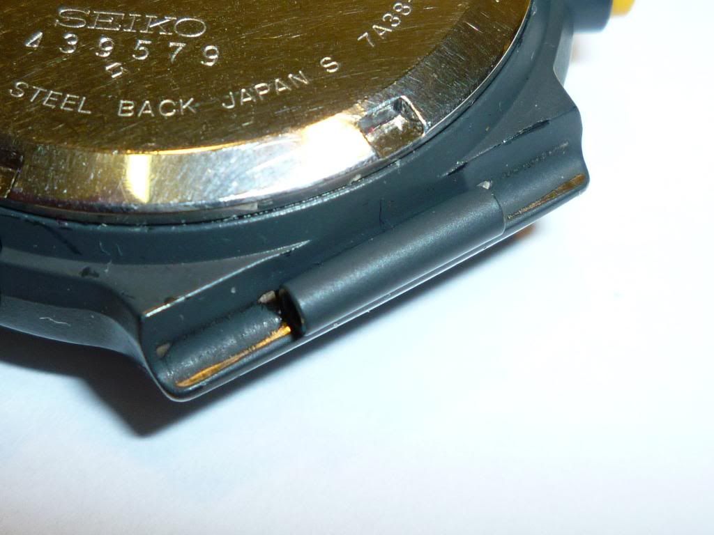

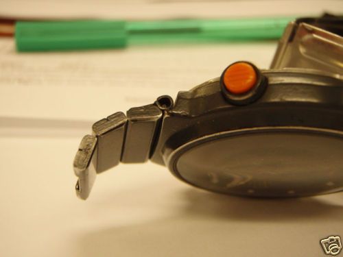

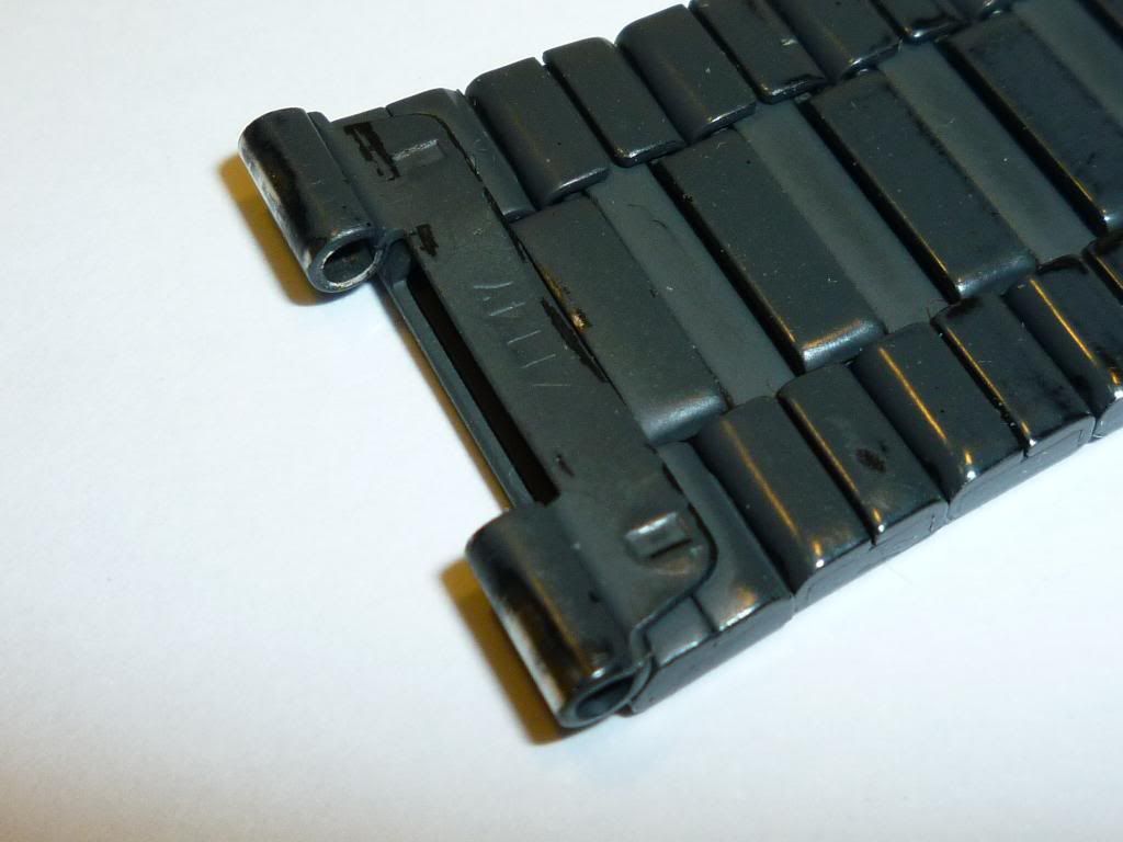

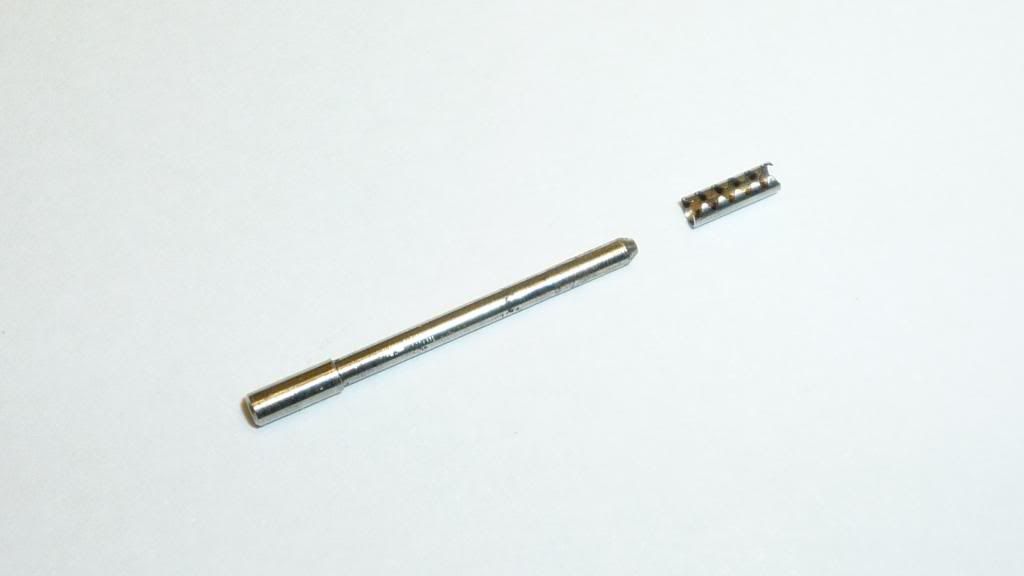

For those not familiar with the 'pin and tube' method of bracelet attachment, here's a few close-up photos of my 7A38-704C beater.
The overall width across the watch case to bracelet 'hinge' is almost exactly 21.0mm.
The central tube which is part of the watch case is exactly 10mm wide, approx. 2.5mm Ø O.D. and 1.2mm Ø bore.
The radiused recesses either side of it have diameters of approx 2.7mm (maybe 3mm absolute max.) - not that easy to measure.
The folded tubes that form the Z1147 bracelet's attachment points are approx. 5.5mm long and 2.6mm Ø O.D. with a bore of 1.5mm Ø.
This is the pin Seiko p/n 81601169, whose shank measures 1.15mm Ø, with its serrated split collar / tube / pipe, Seiko p/n 81180189.

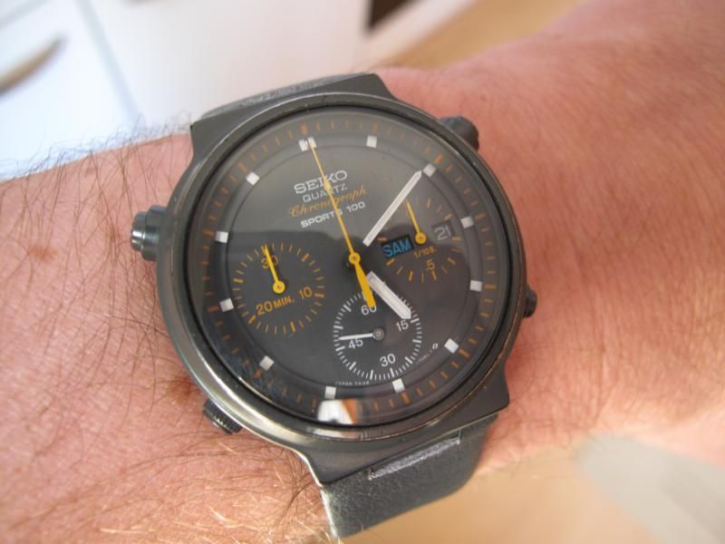

Here is a pic of the 7A28-7079 bracelet fitted to my 7A38-704A.
As can obviously be seen, the bracelet is currently too wide, I will need to re-taper the bracelet.
As I intend to keep this one, I am going to sand/bead blast the case and bracelet to match.
I am reading the current thread on sand blasting with interest.
Should make an interesting Franken.  8)
March 15, 2014 at 8:57 AM Flag Quote & Reply
