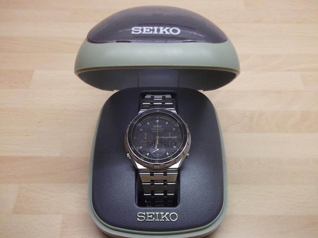

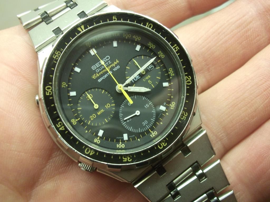

hi well i had to go and pick the watch up from the post office today so thay got me for the vat at £28.03 and £8.00 fee for the post office .also had to pick a box i got for as well .anyway got it home and got it out of the box .loolk nice but had a lot of dna on the braclet case and the bazel would not move ,that too had a lot suff in it in the end i got it to move very nicely did a bit of a clean up of the watch & bracelet looks so much better now.but not good a photo of the dial yet .will try to get a good one on wensday .i have seen some 7a38 with a box like this one so i got it ,but i may not be what it sould have been in.watch seems ok but i would like gone over to make sure all is well.i hope you like it i do and have had on most of the day.all the best woody. | |

![]() Member Posts: 458 |
Really nice Woody - I like these bigger 7Axx watches The movement photo looks nice and clean, but ..... the 'finger' over the main chrono hand driving shaft is slightly displaced, so won't be helping. Best to re-seat it correctly. | |

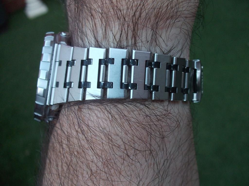

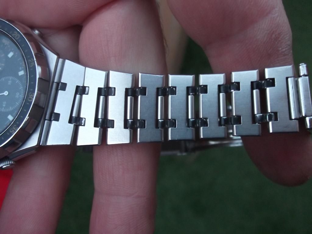

Very nice indeed, Ian. Thanks for sharing your super photos. As I suspected and you've shown in a couple of your photos, there's a bit of stretch in the bracelet, but that's not unusual for this model. It is possible to carefully pinch up those little black connecting links with a pair of pliers, but with your hairy arms you may want to leave it the way it is. Simon is correct about that finger tension spring. It's a very common problem, usually caused by clumsy watchmakers, and if you don't re-seat it properly it will be detrimental to the chrono' sweep hand operation. See this thread: | |

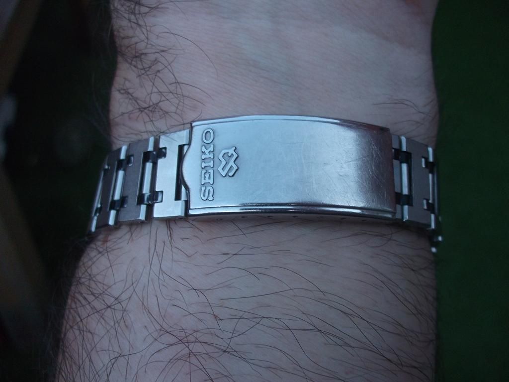

Case-back markings: Double Wave Caseback; 7A38-705A [A0] SEIKO; STAINLESS STEEL; WATER RESISTANT; JAPAN Q. Bracelet is Seiko p/n Z1148S. Underside of joining links are stamped Z1148. Silver anodized with black painted interconnecting links. The bracelet tapers from 23mm to 16mm at the clasp. Adjustment links are retained by / pivot on 0.9mm diameter split pins. Bracelet to watch case fixings are by Pin and Tube, Seiko part numbers 81601169 and 81180109. Bracelet is fitted with the period standard 7-hole adjustable Z-fold type clasp, measuring 35mm x 16mm; cover stamped Seiko SQ.
Production dates: Serial numbers usually seen are 43xxxx or 44xxxx - March and April, 1984 and one with 51xxxx - January 1985. Geography: Nominally a world-wide export model, sightings of the 7A38-705A are more globally distributed than the 7A38-7050. Buyers Tips: The Z1148S bracelet used on the 7A38-705A (and 7A38-7050) is the weakest link. The main link sections are quite sustantial, but the small black interconnecting links, apart from losing their black paint very easily, are very prone to stretching, twisting and opening out. Like many other bluff-ended case designs, the sharp corners on the upper ends ot the watch case are vulnerable to knocks. Unlike its 'Peppermint Green' 7A38-7050 sibling, the original Orange bezel inlay colours, chronograph hands and dial printing of the 7A38-705A appear very prone to fading with age and exposure to sunlight. Indeed, as with the 7A38-6020 diver, both versions of which use a similar acrylic resin insert, in the worst cases, the bezel lettering can actually be faded to white. It's not unusual to see used examples where the dial printing and hands have faded, sometimes unevenly, to a pale yellow. Price Guide: $150 - $550 dependant upon condition. Rarity Factor: 4/5 - Very Hard To Find (in good condition). | |

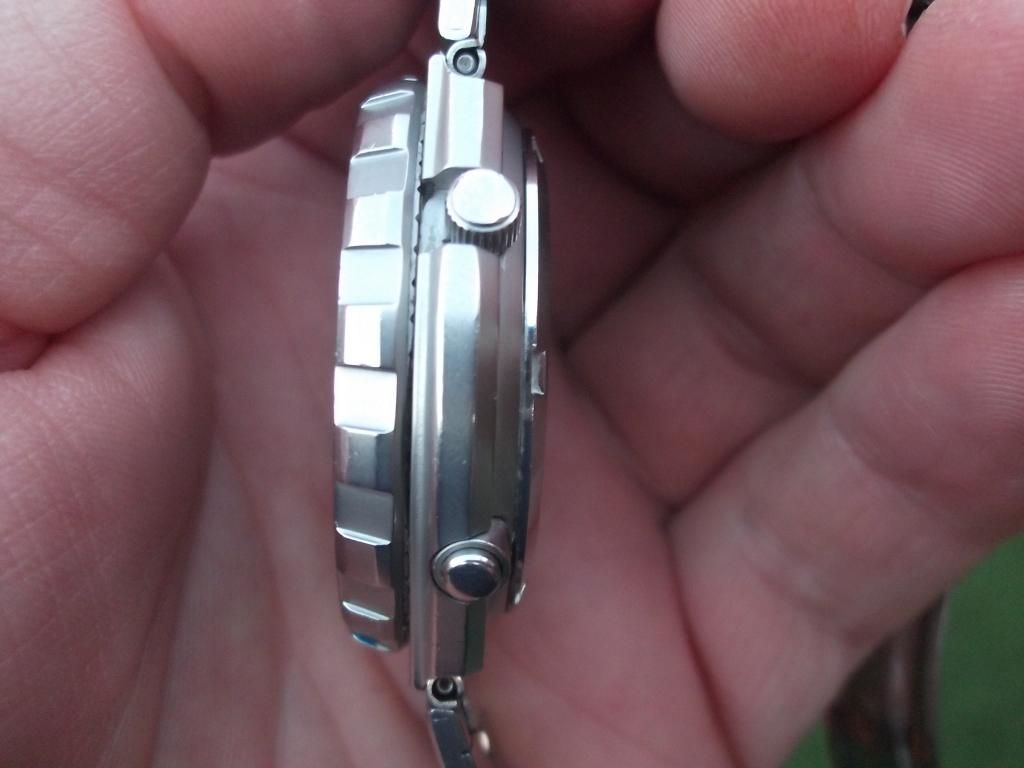

hi thank you both very much for your help had a better go on the watch today and the crono hand is very jittery and will not zero right and the buttons are a bit stiff still work ,so it needs looking at help please as i can do any work on watches .i do not want to send it back as it may be hard to get one agian + all the post and vat that i have payed out .i just took a few more photos to see in thay are any good .all the best woody77 | |

hi all some more photos of the watch.

Hi Woody. The stiff buttons is a simple fix (assuming no corrosion inside or badly bent pushers). The jittery chrono hand, in my experience is not (necessarily). I think for a real watchmaker, someone who can strip the movement down, diagnose and replace whatever parts might be faulty (assuming they can source them), then this would be simple. The 7Axx movement is a real pleasure to work on. However, that's not me!!! I'm just a 'tinkerer' and I've only been doing it for a year or so. If you look in some of the posts I've made, I have done a lot of strip downs with a pretty good success rate. However, the jittery hand syndrome is not one I have a guaranteed solution to. What I've been doing (where I've got a great condition watch externally) if I can't fix it, is to swap the movement from a donor watch. This is relatively simple - a dial and hands swap. But, of course you need a donor movement that is known to be good. I'll take a look at it if you want, and see what I can do. But it might be that you'll need to source a donor movement. PM me if you're interested. Simon | |

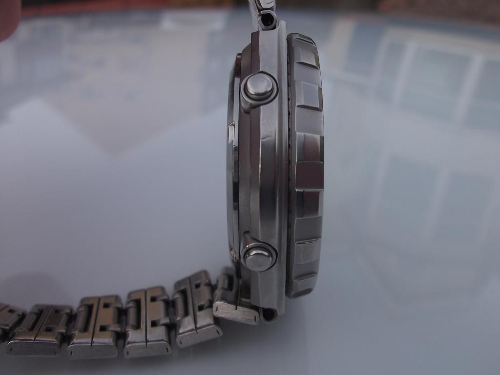

The stiff buttons is a simple fix (assuming no corrosion inside or badly bent pushers). Simon. May I add that the pusher buttons on the 7A38-7050 / -705x don't actually work quite as well on as on some other models. Perhaps it's a design flaw, but if you look at the photos on the previous page you'll see they don't protude very far outside their cups. I experimented with fitting (and then removing) the small stainless washers on one of my 7A38-7050's. Two of the pusher shafts were also bent (right at their extreme ends where the circlips fit) too - a sign that a previous owner had been a little too firm with them. | |
