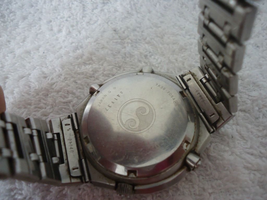

This typically tired, well worn and faded example listed on eBay yesterday by a French seller is the first I've seen in over 6 months:
http://www.ebay.co.uk/itm/252133815074
Montre Vintage SEIKO CHRONOGRAPH SPORTS 100 Modèle 7A38 - 705A
Diamètre: 42 mm ( hors couronne )
Bel état, Toute d'origine, Pile neuve remplacer par mon horloger
Voir photos qui font partie intégralement du descriptif de l'objet en vente
Frais d'envoi groupé en cas de plusieurs achats.
Envoi soigné et rapide des reception du paiement.
Bonne enchères a tous et a toutes!!!!!!!!!!!!!!!!
Paiement chèque ou virement bancaire,si remise en mains propres réglement en espèce uniquement.
The seller's idea of 'Bel état' (literally beautiful condition) and mine, differ somewhat. :roll:
With an optimistic opening bid price of 200 Euros and no PayPal - I'm quite content to wait another 6 months. Merci, mais non merci.

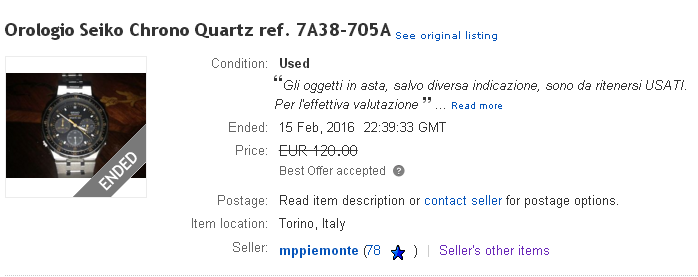

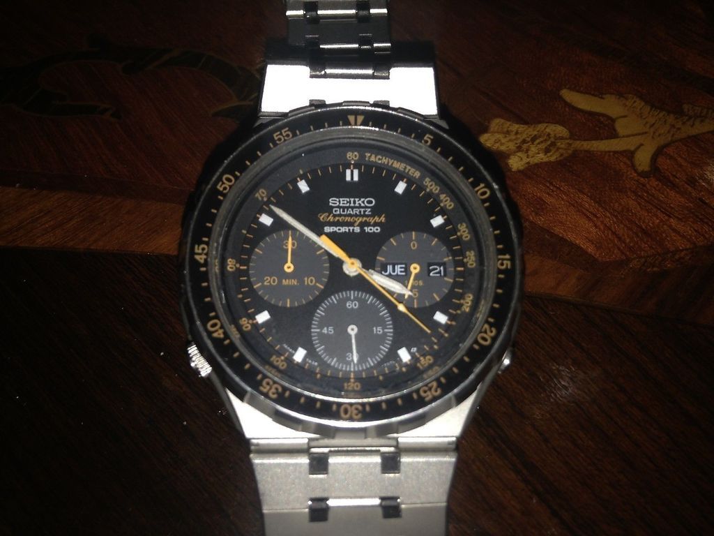

Meanwhile, I think I've finally found my own 'cheap beater' 7A38-705A. :D
It was certainly cheap enough, compared to other recent examples, though it may actually turn out to be a half decent example.
Late on Monday night, just before I hit the sack, I decided to run a quick worldwide eBay search on Seiko 7A38 - and found this.
http://www.ebay.co.uk/itm/161978910089
There was only the one photo and no proper description as such, just the Seller's Notes in the Item Specifics box, which translate as:
Objects in auction, unless otherwise stated, are to be considered USED. For the effective evaluation of the condition of the object at auction are authentic photographs, so do not hesitate to ask for more if you are unsure.
Needless to say, I didn't hesitate to hit the Buy-it-Now button. Don't think I've moved quite so quickly in a long time. :lol:
Although I didn't waste a second researching him before I hit the button, it turns out that the seller: Metalli Preziosi Piemonte SRL is a Brick and Mortar establishment in Turin, dealing in watches, jewellery and precious metals: http://www.metallipreziosipiemonte.com/
February 17, 2016 at 6:52 AM Flag Quote & Reply

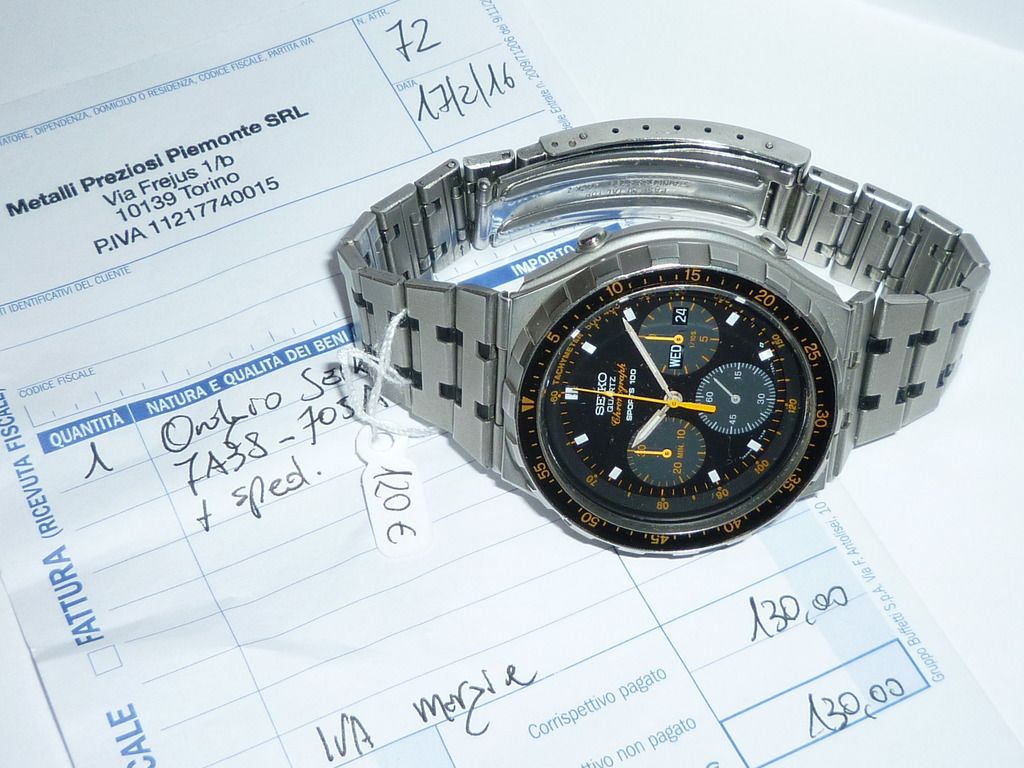

Despite the fact it shows 'Best Offer accepted' in the screen print above, which I took just after I'd hit the B-I-N button (and the ended item summary below), I did actually pay the full 120 Euros Buy-it-Now price, without a quibble. Besides, there was no time for haggling. The seller only charged 10 Euros shipping, total 130 Euros, which compared to Woody's example, that started off this thread ($155 US + $60 shipping + 20% VAT and Customs clearance charges), makes it a somewhat cheaper late night impulse bargain buy.
http://www.ebay.co.uk/itm/251212003884

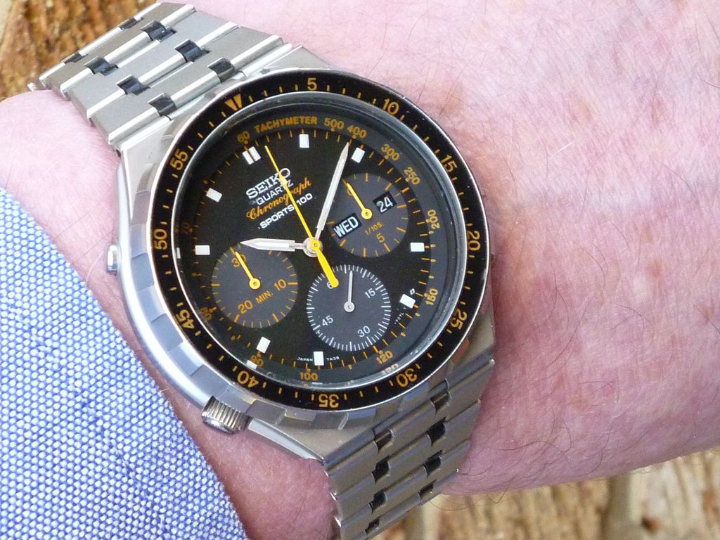

Oh, Yes - and this one's in rather better condition, too. :D
The only minor problem with it that I've noticed (other than some light 'Desk Diver' marks on the clasp) is that the 4 o'clock pusher button is inoperable. It depresses, but doesn't travel very far, nor do anything. Hence why I wan't able to zero the chronograph sweep second hand, before I took these photos. Not unusual with this case design. I've experienced similar problems with a 7A38-7050 in the past. Their pusher operation is never particularly positive, even at the best of times. I'll take a few more photos at the weekend, once I've sorted it and given the watch a light clean.
Here's the obligatory Q&D wrist shot:

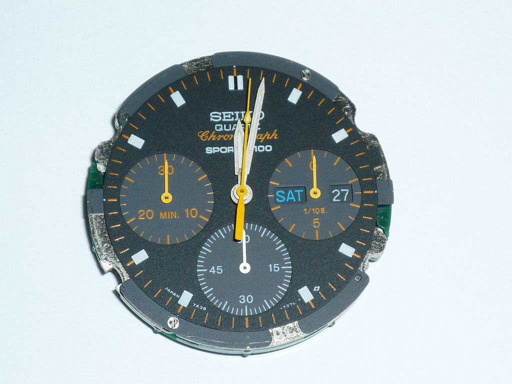

This lunchtime, I set about sorting out the inoperable 4 o'clock pusher issue, giving the watch a light overall clean at the same time.
The movement was nice and clean, showing no evidence of battery acid leaks or moisture ingress. It was fitted with an under-sized Renata # 395 battery, which I subsequently replaced with a Seizaiken SR936SW (# 394).
Athough both pushers on this side are making contact with the switch lever actuators, note how little travel is available. :/
Nice clean 707L dial, with no sign of fading. :)
Both switch actuators on this side of the movement looked OK, too. Perversely, if anything there was a slight amount of wear on cam of the 2 o'clock lever (as opposed to the 4 o'clock, which didn't work and looked like new). :/
Both ends of the pusher shafts were straight and showed minimal signs of wear. Note the tiny scratch on the crystal. :(
Indeed, when I stripped them out, there was hardly any dirt in the pushers or their cups in the watch case.
As the pusher O-ring seals were tired and worn, I took the opportunity to replace them - using the Cousin's cheapie substitute parts, which I discovered last year, rather than Labanda's reproduction p/n EC0060B0A, which I also had in stock.
February 27, 2016 at 10:43 AM Flag Quote & Reply
That, with a light application of silicone grease to the pusher shafts seems to have done the trick. 8) So I nailed it back together.

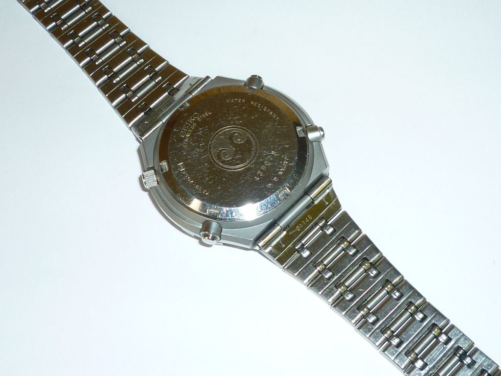

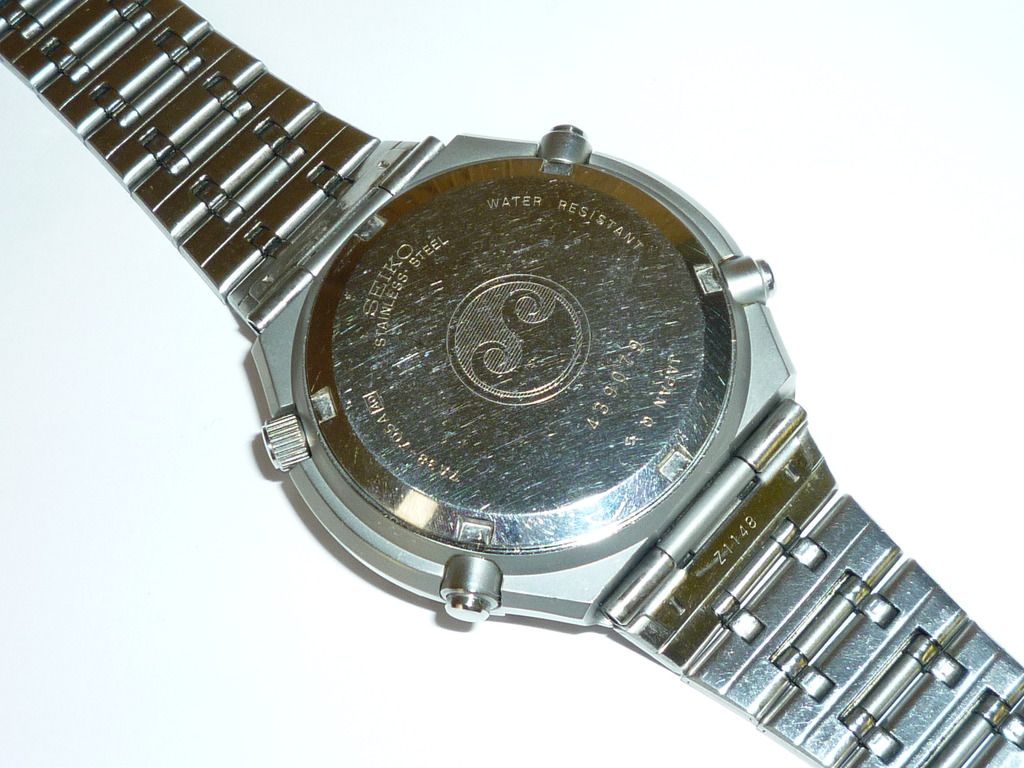

The case-back is covered in light scratches, probably the result of allowing the Z-fold clasp to rub against it when not being worn.
I haven't decided yet, but I may give it a light polishing. :/

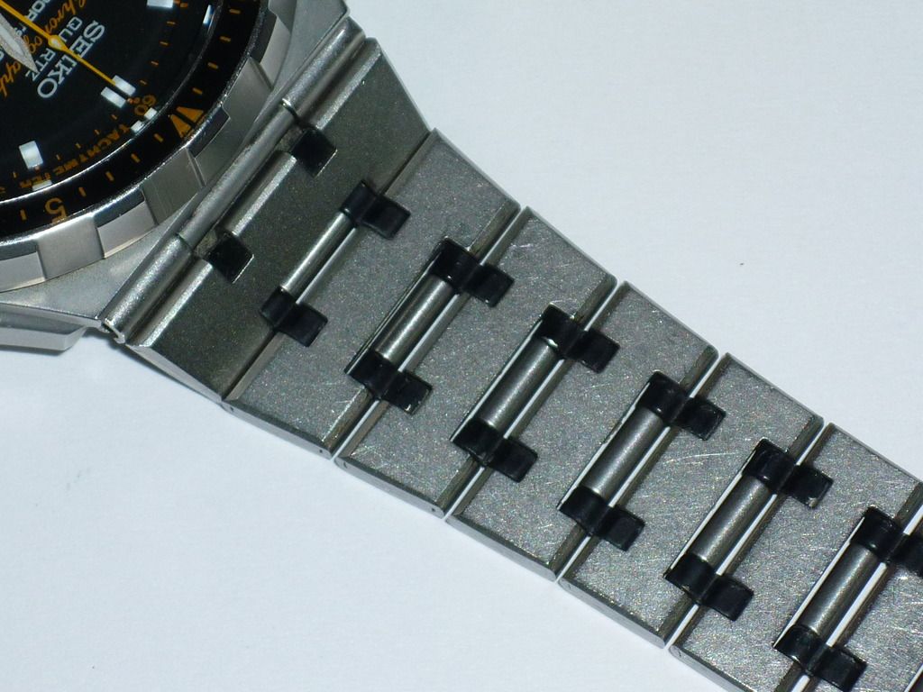

All evidence of the original matt black paint on the underside of the small bracelet interconnecing links is completely worn away.
Yet on the topsides, it's almost completely intact. :)
There's only very minimal stretch between the bracelet links too. :)

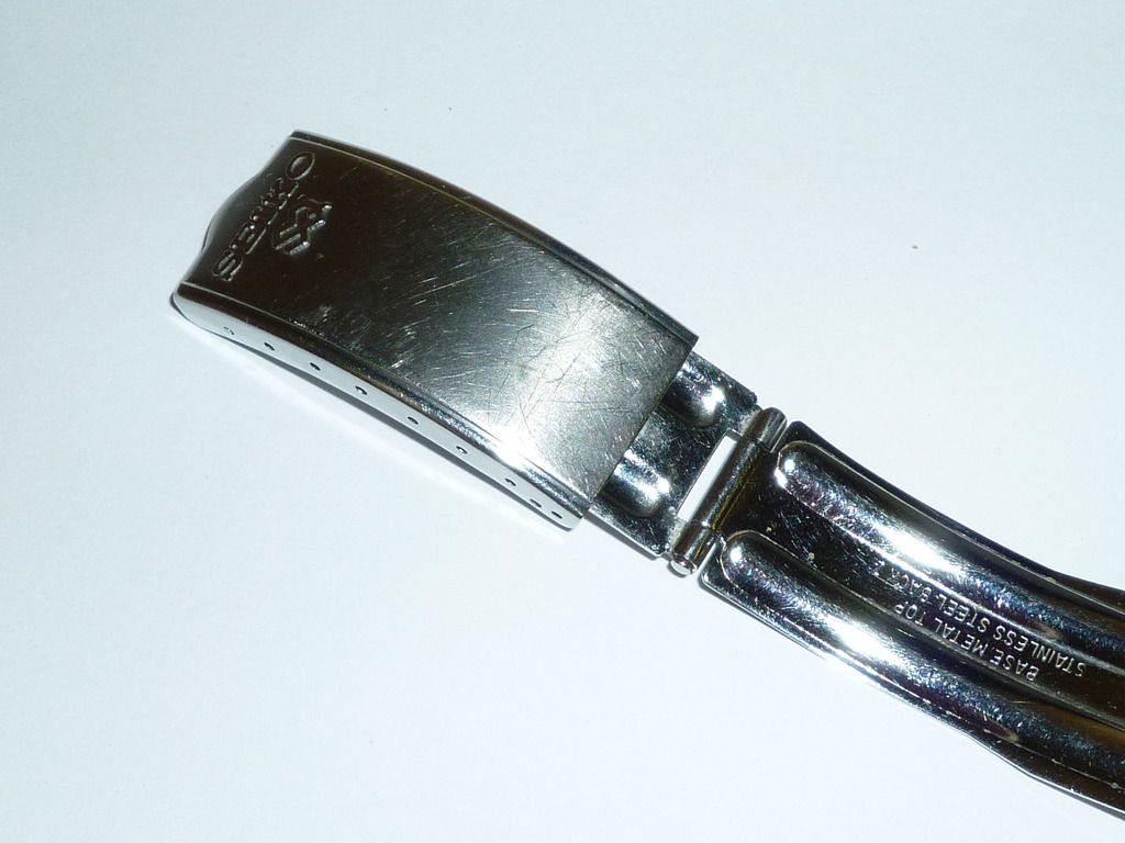

The SQ clasp closer and those light  'Desk Diver' marks I referred to earlier.
Sorry, couldn't resist the orange duster background. :P

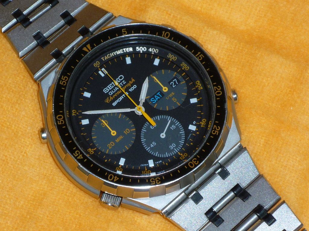

In this photo, you can see the tiny scratch on the crystal, just to the right of the date window.

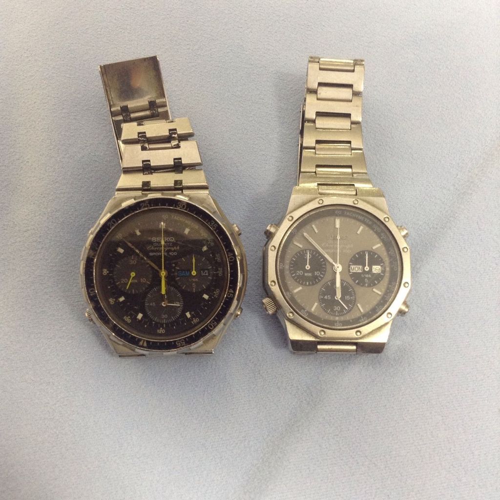

To illustrate my earlier reply to Woody ....
February 27, 2016 at 11:44 AM Flag Quote & Reply
Seiko7A38 at January 10, 2013 at 9:24 PM
Hi Woody.
You are correct in your assumptions. Yes, the 7A38-705A is comparatively rare and it is effectively the sister watch to the 7A38-7050.
It shares many common parts, but has orange bezel numbering, dial printing and chronograph hands, instead of peppermint green.
There is another subtle difference between them; their dials. The 7A38-705A has a black dial with dark grey sub-dials, whereas in the 7A38-7050 the main dial plate colours are reversed - that has a dark grey dial with black sub-dials.
Don't think I've seen this particular side-by-side shot done before. 8)

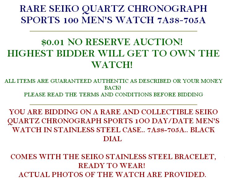

This rather tired example of a 7A38-705A, with typically faded bezel inlay, dial printing and hands, dodgy lume and a badly stretched bracelet was listed on eBay in the early hours, by one of the regular* Filipino watch botchers purveyors of well used (and frequently non-original) watches. As indeed this example is. Note the white backgrounds to the day and date wheels (which, of course, should be black with white lettering on this model), indicating that the movement has been swapped.
http://www.ebay.co.uk/itm/301916241594
*In case the familiar format of the listing, with its multi-coloured fonts and umpteen 640x480 sized embedded images doesn't provide a clue to the seller's new identity guilloche_enterprises, it is of course our old friend apol_of_your_eyes. They've omitted to change this part of their standard description / T&C's - the link below doesn't work any more ! :roll:
Not sure why Apol & Bros decided to change their eBay ID, after all these years, but seems they did last week:
http://contact.ebay.co.uk/ws/eBayISAPI.dll?ReturnUserIdHistory&requested=guilloche_enterprises

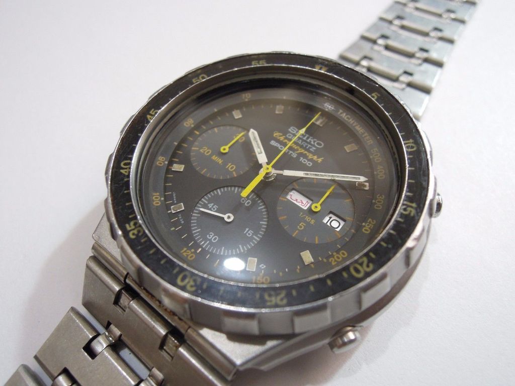

This typically tired-looking 7A38-705A was listed in the early hours of this morning by a Filipino eBay seller, with a risibly over-optimistic 'pie-in-the-sky' Buy-it-Now price of  $850 !!
http://www.ebay.co.uk/itm/222463811541
Indeed, it's worth studying the seller's photos, because apart from the obvious 'wabi', not everything is quite as it should be with this watch. The white painted hour and minute hands are not orginal to this model. The correct style hands have more pronounced points and are 'bare metal' finish. Like the similarly tired example offered by Filipino eBay seller guilloche_enterprises in April 2016 (see higher up the page), this watch has also been fitted with a replacement movement, with white day / date wheels, instead of the correct black with white lettering. The two upper pusher buttons (@ 10 o'clock and 2 o'clock) appear to protude far more than usual outside their pusher cups (for this model). According to the seller they 'Properly Function'. One of them appears to have fresh plier marks.
