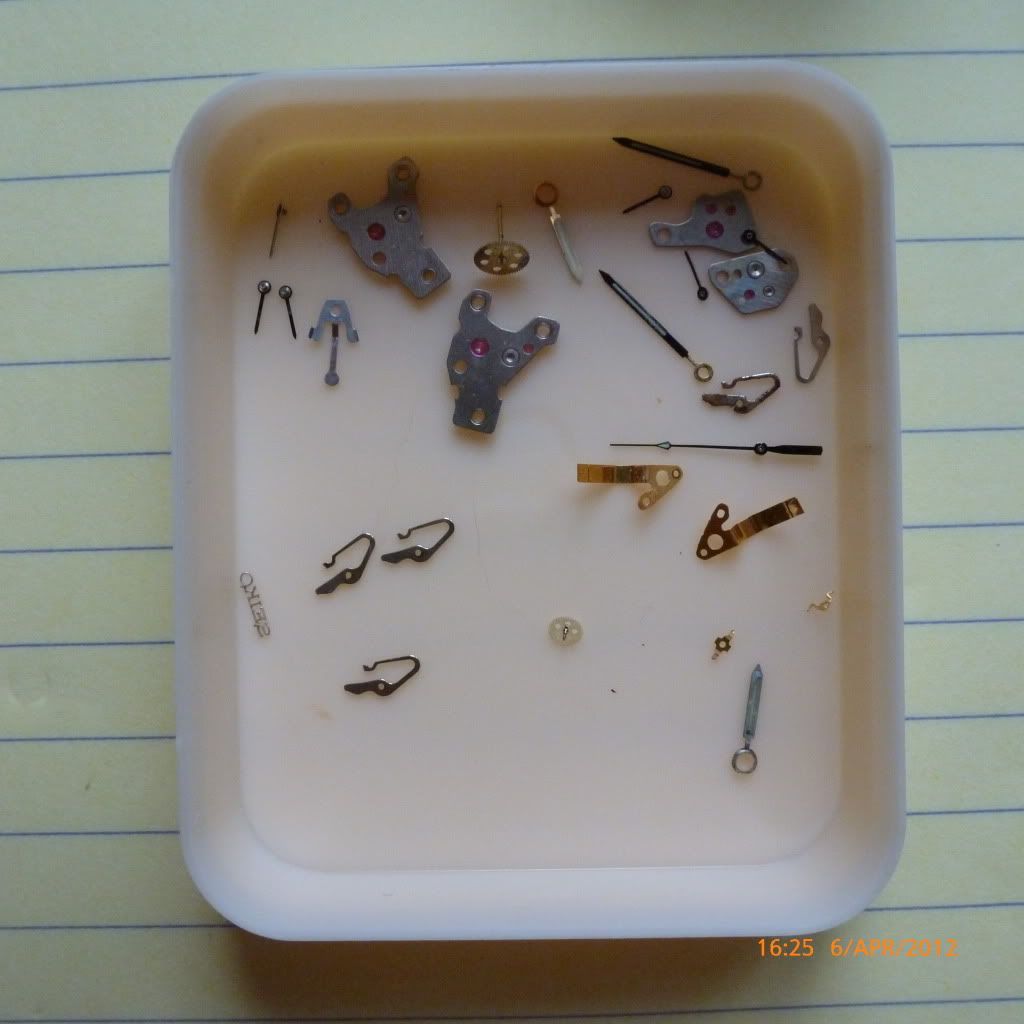

Today I decided to strip down one of my latest purchases, a 7A38 7190 from Germany. I was very happy with this watch (given what I paid for it), but knew there were possible horrors waiting inside as the 2pm chrono pusher was very sticky and reluctant to work as it should.
So, here is the photo story of my afternoons work.

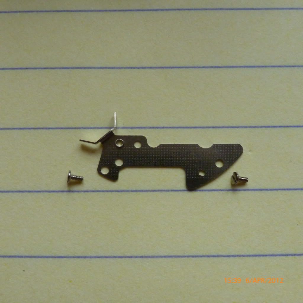

Here's a closeup of the tiny gold plated regulator (the 0.26 second per day adjustment), and also something that I'd not paid any attention to before, the tiny little arm that makes contact with the circuit to tell the cpu at which position the crown is:
I've read some very informative posts by DaveS referring to this not making contact properly and causing problems.

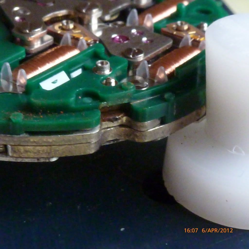

Now lets focus on the area of rust, and the side view looking at the pusher clip:
That doesn't look good :(
So, it's off with the green spacer block (which is just a push fit and easy to remove) to reveal:
Hmmm, as suspected rusted pusher clips - but not just one, two (out of three).  In closeup:
and (not as bad):
The clips come off easily, showing the rust around the pins they sit on:
I clean this off with the tips of my tweezers, and trusty rodico:
urghhhh:
but a nice clean result:
Now, to my spares box:
and on with two new clips:
and
Doesn't that look better :)
Now, another lesson learned. You'll see that I did the dissasembly with the crown out. When I removed the green spacer block, this dropped out:
I found it (phew) and knew that it was part of the crown / stem clutch assembly. Note the fleck of rust attached to it. I've noticed that many of these tiny gears are magnetised - so rust is going to be drawn to it which can only lead to trouble. I removed the rust fleck and popped the crown / stem back in.
I then gave everything a good clean with rodico, and then back on with the green spacer block:

Finally, I cleaned the rust off the worst clip:
Imagine that in the movement. :roll:

I can also add to Sir Alans experience:
My 7A38-7060 lost a couple of hours over night. When I realized the next day I opened it. I was shocked when I saw the battery leakage. The battery terminal was rotten off and there was quite some rust around the battery.
When I took the PCB off I realized the same thing as Sir Alan. The battery contact was only held in place by the track. I decided that I couldn't destroy any more and used 2K-Glue to stabilze the PCB. After it was hard I used some rodico and alcohol to clean the PCB. After putting it back in and fitting a new battery terminal from my spares it was running again 8)
Picture of the PCB before gluing and cleaning:
