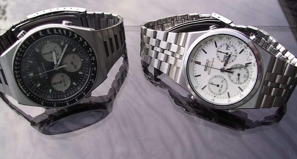

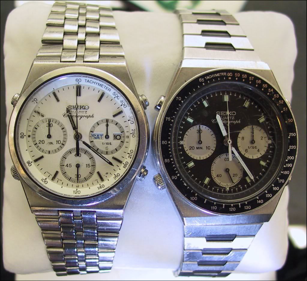

The watches used in the demo were a stainless 7A38-7280 and a 7A28-7039.
I've checked through my folders (I still right-click and save almost any photos I see),
but sadly these (before and after) appear to be the only two I saved from that article:

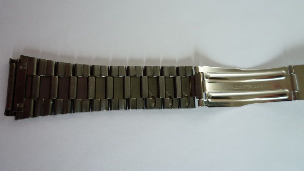

Not neccesarily meant for you, Simon ....
as I know you've successfully removed links from your 7A38-7000's bracelet already.
I suspect you used the tip of a small screwdriver to pry out the removeable keepers.
If you collect more of them, you may encounter different types of Seiko folded links -
and not all of them are always quite that easy to pry out using a small screwdriver. :/
This is an old photo of one of my Orient J39's bracelet, showing the removable links:
The link keepers were VERY reluctant to come out - not only tight, but bunged up with crud, so I invested in a pair of these A*F bracelet link pliers, specifically designed for use with that style of Seiko folded link bracelet:
If I remember, they were about £15 from Cousins (edit: now £20 - their part # B0145)
Well worth every penny - I use them all the time now, instead of a small screwdriver.
But I wouldn't call them 'Essential', unless you're planning on buying a few 7Axx's. :D

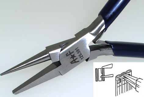

From my days of model car building, etc. I have umpteen pairs of tweezers in all shapes and sizes, incuding anti-static ones.
Most watch repairers will recommend you use plastic-tipped tweezers for hand placement (before setting), but I swear by Rodico.

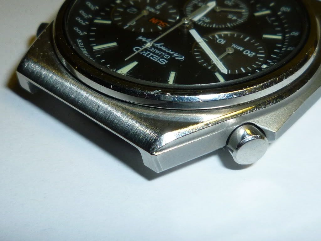

Most 7As with a fixed, but removable, bezel will have a small fingernail sized (and shaped) indentation on the underside edge.
Normally, unless the bezel has been taken off before, you'll find it in the area of the top L.H. lug - usually near the 11 marker:
Before attempting to lever off the bezel, I recommend protecting the corner of the watch case with tape, to prevent any marking if the tool slips. Here I'm using Polymide protection tape, but in the past I've even used a small corner of 'Duck' tape. For gold-plated or coated cases, I'd suggest using something less sticky, such as Sellotape 'Magic' tape or even masking tape. The last thing you'd want to do, after protecting your watch case from scratching while you levered the bezel off is to lift any loose coating as you peel the tape.
The above photo was PURELY FOR DEMONSTRATION PURPOSES ONLY. Do not even think about going anywhere near the watch case with the tool, and the intent of prying off the bezel, while the dial face and movement are still in situ !

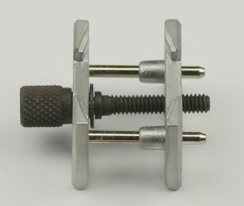

That isn't really a 'movement holder' as such - just a watchmaker's vice. I've got a similar-looking one myself - without the base-plate.
The quality is pretty abysmal really, and I mostly use mine for holding a watch case when I'm dealing with a tight case-back.
There is another type of watchmaker's vice which is better suited for use as a movement holder, with a radius machined in the jaws.
Here's a small* cheap (and presumably low quality) example currently on eBay for £2.99: http://www.ebay.co.uk/itm/200685390523
*By the way, I asked a question of the seller, and he replied that the maximum diameter movement that vice will accept is only 25mm.

I have one of these holders as well (without the baseplate).
Whilst from a machining perspective it looks quite nice and solid, it isn't terribly well thought out. But for less than £10 it's not bad I supose.
I'm looking for a better version, preferably one where the nylon/plastic holder pins are angled inwards so that as the clamp is tightened, it is prevented from ping'ing out. They are also too hard and too shiny - they ought to be rubberised?
The knurled screw isn't very easy to tighten down - I think this is because the screw is steel and the thread into which it tightens is (cheap/soft) aluminum - burring and almost cold welding taking place?
I also need a movement holder - as this is clearly not the right tool for that!!

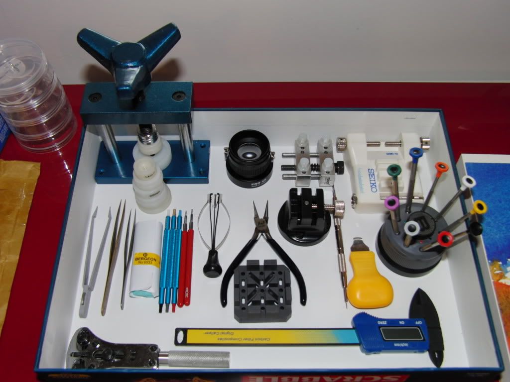

These are mine:
they've all been used on my recent projects and have worked perfectly.

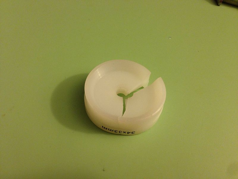

I still swear by my ex-eBay 'cheapie' lever-operated crystal press, although I had noticed some time ago, that a couple of the more regularly (ab)used concave nylon dies had started to develop radial cracks around their locating holes. :( This is my 34mm / 35mm:
Though when I say 'abused' - the reason it looks a bit gnarled is because it's been used for re-fitting bezels, rather than crystals. ;)

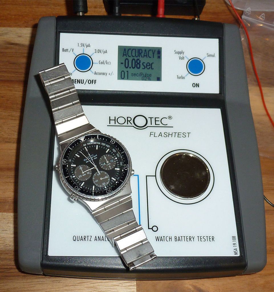

It's a long time since Simon ('Sir Alan') started this thread - or for that matter since there've been any updates to it. Simon's knowledge and skills have improved by leaps and bounds over the last six years - and so apparently has his array of tools.
I was chatting with him on the phone a few days ago and he mentioned that he'd recently treated himself  to a new Horotec quartz tester. It's one of these - a FlashTest.
http://www.cousinsuk.com/product/horotec-flashtest
There's evidence of Simon using it to test a customer's 7A38-7070 in a recent eBay listing:
While not certainly not 'essential' (per the topic title), nor cheap @ £295 + VAT, I may just have to follow his lead and treat myself to one. On the basis that the size of my collection justifies it. :D
