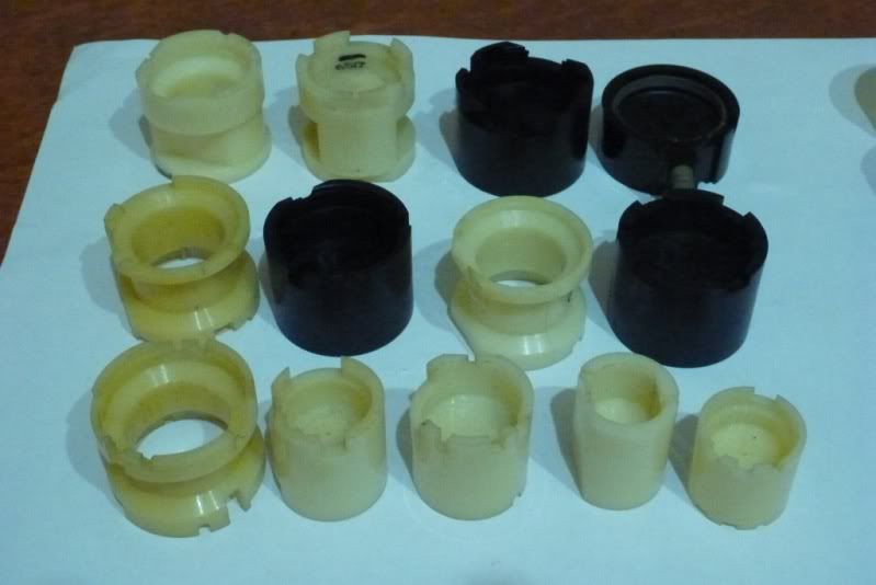

This is a proper Seiko movement holder, for Caliber 6138:
That photo came from a short thread on SCWF: http://www.thewatchsite.com/index.php?topic=13940.0
There's a few more examples in this other thread: http://www.thewatchsite.com/index.php?topic=25255.0

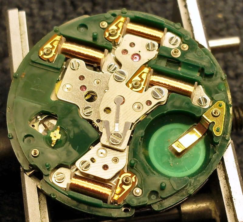

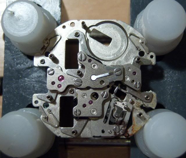

Trying to strip down a 7Axx movement in one of those cheap, ex-eBay watchmaker's vices with the nylon pegs is not ideal, because they don't locate the movement positively. As I've written before, this type of vice are really only suitable for holding watch cases.
Not only that, but the pegs can get in the way, when you get down to main base-plate level. This is someone else's borrowed photo:
Note how the nylon pegs are obsuring the very corners where the crown stem and pusher actuators are located. :mad:

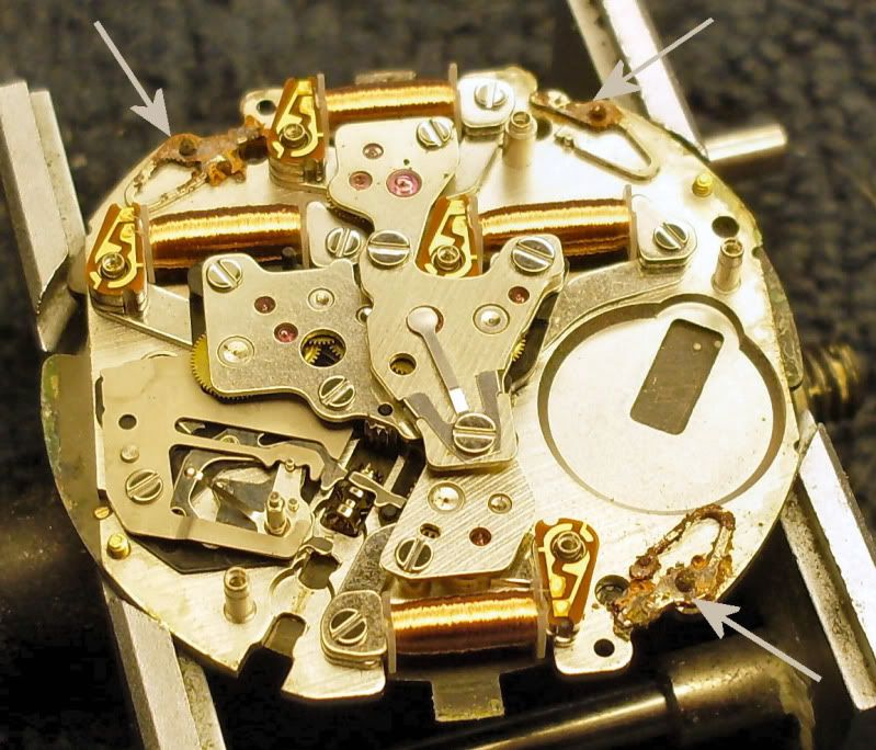

This was a 7A28 movement where John was demonstrating how he sorted out rusty pusher actuator levers. Superb photos, eh ? ;)
Here's a not-so-wonderful photo I posted in athread on RLT a while back, showing a partial strip-down on a 7A38-7270:
On this occasion, because it was a Q&D clean-up - a similar exercise, but with less extreme rusting, I did it in situ - in the watch case.

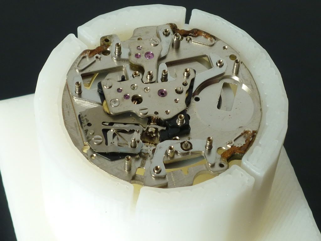

I picked up the first prototype at work this morning. It didn't turn out to be quite the working model I was hoping for. :(
Certainly not what you'd call an unmitigated failure, by any means. ;)
First of all, in terms of overall dimensions, I think I've pretty much got it right.
If feels comfortable between forefinger and thumb, though I'm not sure if it really needs to be 40mm high overall:
In the photo above you can see how the 3D printer constructs the model. Basically, it extrudes a thead of molten plastic (at 280°C), building up the model layer by layer. I think the engineer running the machine said the thread was 0.2mm, but it looks thicker in some places. He did warn me (partly because of the 1.0mm 'access slots' I was forming in the top layer), that there might be some risk of distortion. Yesterday morning, I had actually measured the widest part of the movement - the '710' green plastic spacer at 31.21mm. My gut feel was to go for an ID of 31.25. Then I thought, No - let's round it to 31.3mm. In fact, what we finally decided to go with was 31.5mm ! I was thinking to myself afterwards, this isn't going to be any good - the movement is going to be flopping all over the place. 0.29mm is a lot of play in horological terms. I took a gash (badly battery acid damaged, minus dial and hands) 7A38 movement into work with me this morning - itching to try it out. Absolutely NO WAY would it even begin to fit, and I suspect if I'd tried to force it in any depth, I never would have got it back out again.
When I got home this afternoon, I tried out a couple more movement parts, separately, starting with a partly stripped rusty one:
Slightly different view without my fingers. In both of these shots, the movement base-plate was barely pushed into the holder:
The only reason I managed to get the slightly larger diameter '710' plastic spacer / insulator to fit, was partly because of its inherent 'give' when not assembled into the movement, but also because this one was actually broken. So a bit of a pointless exercise really. :roll:
Here, I literally forced the 7A38 Day / Date spacer (I think Seiko call it a 'Dial Sheet' in the parts list) a bit deeper into the holder.
Getting there, I think. :)

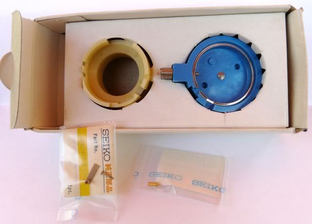

In the meantime, I've been casting around for more ideas - never averse to plagiarism. ;)
Check out this selection of better quality (some better described than on Cousins website) movement holders on Otto Frei's website:
http://www.ofrei.com/page244.html
In case you don't think in 'Lignes' - and I certainly don't .... 31.5mm Ø is as close to 14 Lignes as makes no difference.
Note also: A*F movement holder # 185.138 halfway down the page - for ETA Cal. 251.2xx - a fairly popular quartz chrono' movement used in many TAG and Tissot models. The more I think about it, I'm sure Seiko must have a ready made holder specifically designed for the 7Axx series movements. I'm going to ask the question, before I expend too much effort 're-inventing the wheel'.

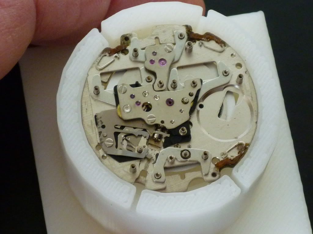

Some of you may have noticed, from a photo I posted elsewhere on the forum, that there exists a Mark 2 prototype movement holder.
Except in that Q&D photo I rattled off this afternoon (for illustration purposes) I quickly popped the Kamatz V906 movement into it ....
without thinking to align the other three 60° slots in the 'barrel' with the pusher actuator levers (as it was intended to be used).
The most obvious difference is that this one has the four little receptacles moulded in the base to 'drop' your back-plate screws into.
However, it is actually quite different from the Mark 1 prototype - and it works ! :D

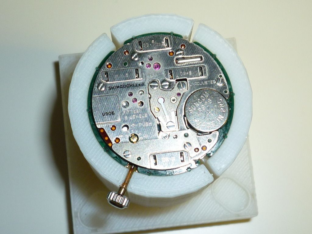

I'd twisted Mervyn's arm (the helpful mech. engineer at work) to knock me up a third prototype on the 3D printer, back in early May.
Only Merv being Merv decided he was going to do it differently. He decided, despite my protests, that he was going to make it taller ....
Much taller ! :o .... and that rather than trying to achieve a precision fit, he was also going to make the 4 slots much deeper, on the basis that the inherent springiness of the material would grip the movement. It did - too bl**dy tightly. Unfortunately, Mervyn hadn't allowed enough for 'shrinkage' in the moulding process. I could just about force a (completely gash) movement into it, but I had to literally lever away at it with screwdrivers to get it back out again. Not ideal. So eventually, I persuaded Mervyn to chuck it up in his lathe, reduce the height to something more sensible, and to machine out the top step again to 31.25mm - exactly. Now it very gently grips the pips on the perimeter of the 710 spacer - so perfectly, with just a hint of spring loading, due to the four extended slots.
You don't actually need to locate the movement with a crown stem, to stop it turning as you undo or tighten the backplate screws. :)
This second photo shows the movement correctly oriented, with the other 3 slots properly lined up with the pusher actuator levers.
Of course, in a production version it would probably make more sense to have 6 slots moulded every 60°, to stop any 'misplacement'.

We've talked in principle about CNC machining a next prototype from solid in black Delrin. The costs involved aren't too prohibitive.
