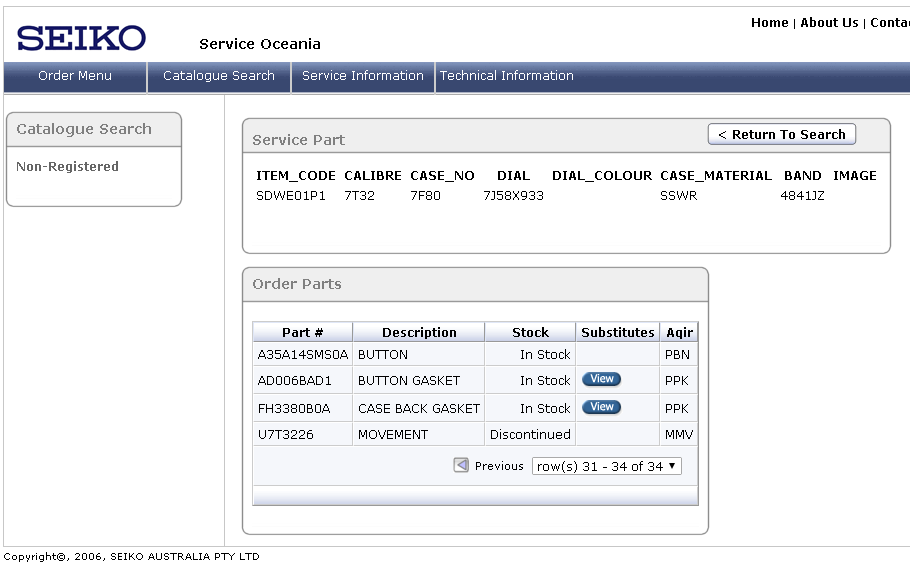

Correction to my original post - I'd somehow inadvertently missed seeing the parts info you require for the 7T32-7F80 ....
Both the pusher button and the case-back gasket p/n's are on page 3 of this search result on Seiko Oceania's database.
Pusher button and case-back gasket are both available from Cousins UK.
See: http://www.cousinsuk.com/search?SearchTerm=Seiko+A35A14SMS0A
and: http://www.cousinsuk.com/search?SearchTerm=Seiko+FH3380B0A
Having owned and worked on a couple of this particular 7T32 model, I've also identified a cheaper substitute gasket.
Cousins / ISO Swiss p/n 33503550(c) is a perfect fit. See: http://www.cousinsuk.com/search?SearchTerm=33503550

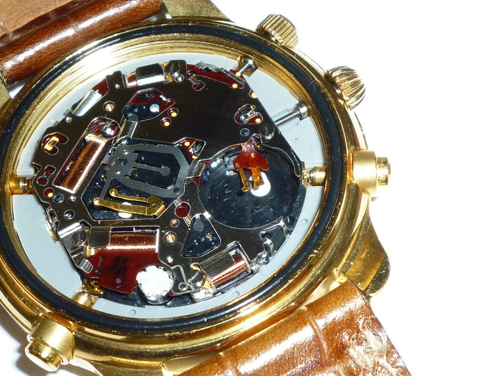

After some cleaning, fixing, replacing, recleaning and oiling, I am quite pleased to show the final result on the watch RG58 sent me to fix.
You may note that the glass was not replaced, but will probably done by RG58 himself. Of course all functions, including alarm chime, work as they should.

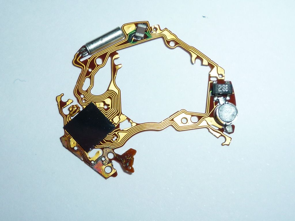

Last week I bought a nice burgundy dialed NOS RACER Orient HFA019-70, which reminded me I still had unfinished business with its even blingier BreitBling sibling. So this afternoon, I finally decided to replace the PCB, which I'd bought for the purpose. Before I go any further, I'll say now that I'm still firmly of the opinion that these movements are meant to be disposable. I absolutely loathe working on them, with their flimsy tinny metal stampings, bent tabs and tiny fiddly little screws ! :mad:

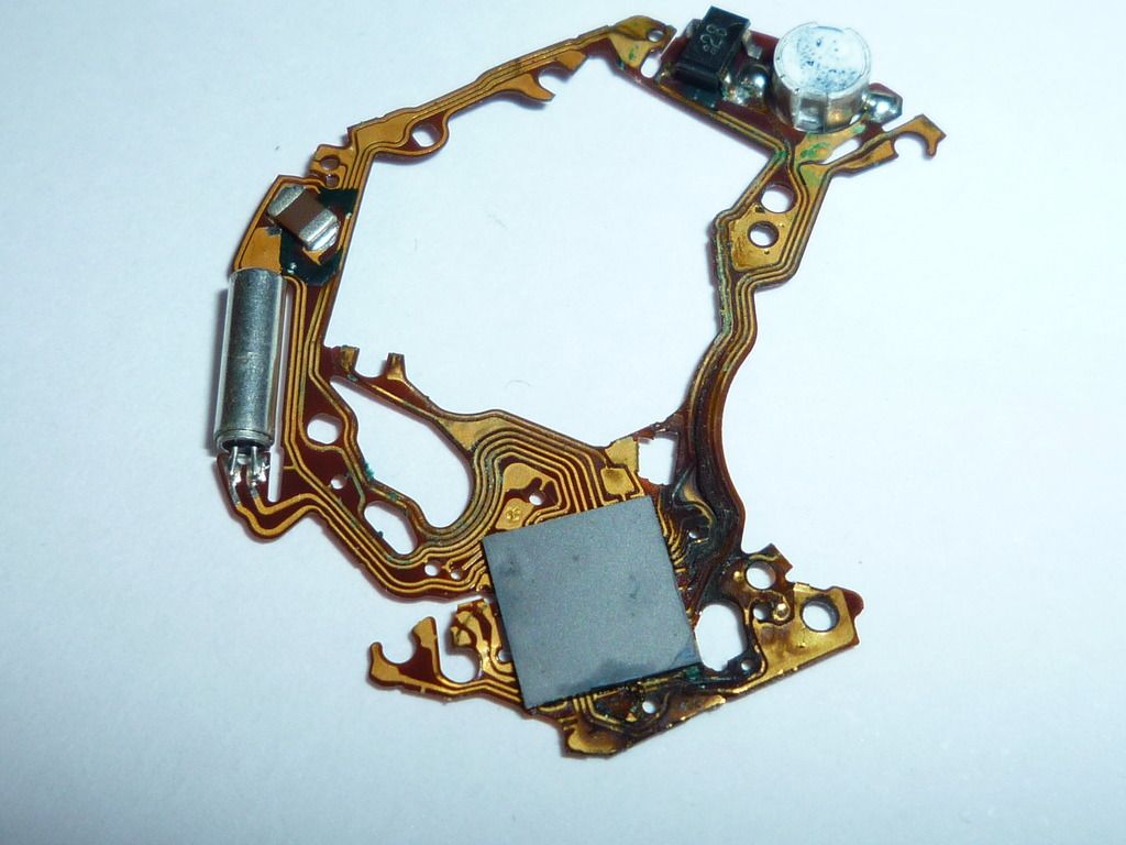

I didn't take any work in progress photos. There wasn't much to see. Here's a couple of shots of the old PCB I removed.
Note the discolouration in the area of the battery contact and below the IC.
And a close-up of the affected area:
The fishtail shaped protrusion is what makes contact with the battery's negative contact. As you can see, the tracks in that area have been all but obliterated by the battery acid. It doesn't take much to kill a 7T32. :(

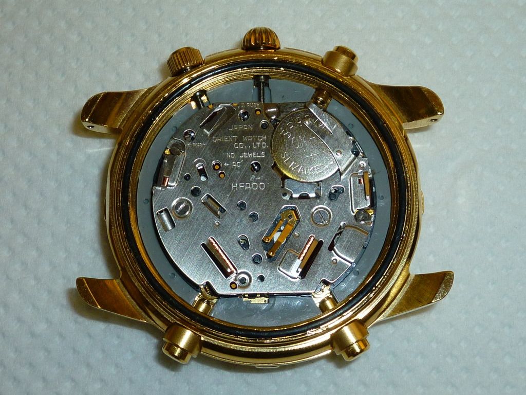

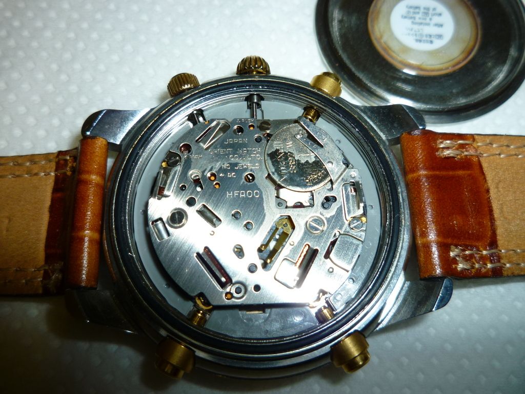

Here's a quick shot of the movement, just before I screwed the case-back on. Note how surprisingly clean the back-plate is (given the terminal damage to the PCB). That's exactly how it arrived looking. All I've done is given it a cursory wipe.

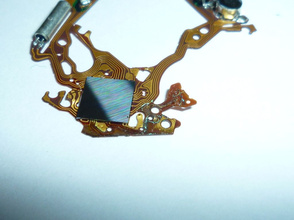

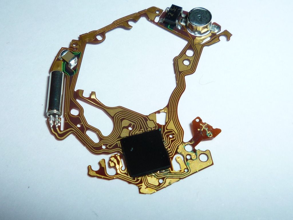

It had obviously suffered from a battery leak, so when I dismantled the movement (which on the whole was remarkably clean otherwise), it was no great surprise to find that the PCB was toast. :(
Note the darkened areas around the IC - and that the 'fishtail' contact is missing.
Of course, I'd used the only spare NOS Orient HFA00 PCB I had in stock, to repair the other blingier one. So for expediency's sake (and because I simply couldn't be arsed to go searching for another at the time), I decided to 'borrow' one from one of my Seiko 7T32-7F80's. This was a second black dialed example I had, which I still hadn't got round to re-finishing the case and bracelet. It was definitely a runner before, but I'd let the battery run flat some time ago. I very gingerly popped the old battery out. There was thankfully absolutely no evidence of any leakage. I must admit I didn't look too closely at the PCB - I just fitted it to the Orient HFA00 movement, expecting it to still run. But NADA - dead as the proverbial dodo !! :mad:

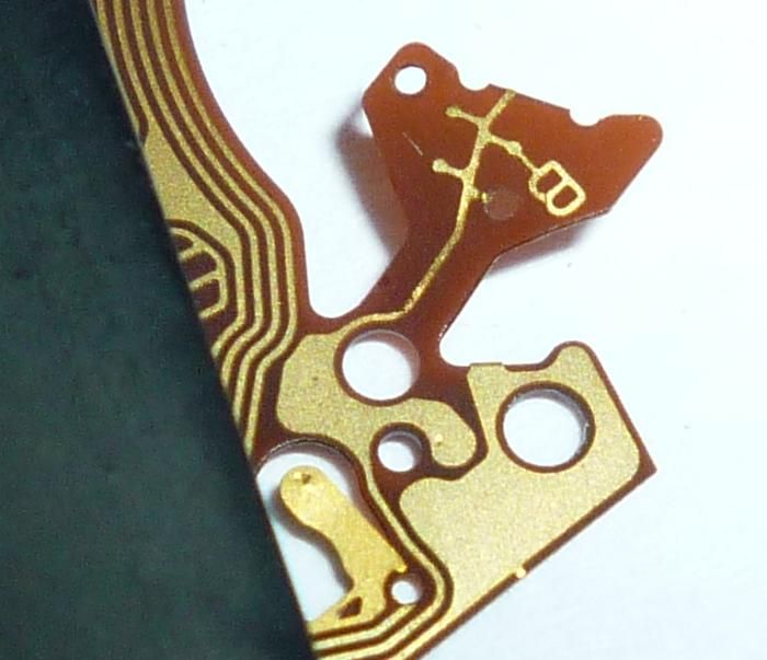

So I took it out again and examined it closely - and took this photo. Check out the tracks (or lack of one in particular) in the area of the 'fishtail'. Needless to say the air briefly turned blue !!
Here's a close-up of that 'fishtail' area - or how it should look (on my NOS PCB) .....
Here's another shot of my the movement in my HFA901-70 (with the top plate removed) showing how the 'fishtail' extension of the PCB extends into the battery recess, making a rather haphazard secondary contact with the battery negative terminal. Obviously it gets bent down whenever a new battery is fitted - making it vulnerable to damage from flexing, particulary if any there's any track corrosion. I suspect that's probably what happened to my previously working 7T32's PCB. :(

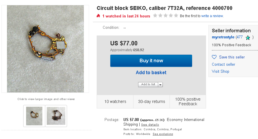

So I started looking on eBay for Seiko 7T32 PCB's. And I thought the prices some eBay sellers were asking for complete NOS 7T32 movements were extortionate !
This current listing for a NOS Seiko 7T32 PCB, by Portuguese seller myretrostyle ends in a few hours. It has 10 watchers including myself.
http://www.ebay.co.uk/itm/272252923493
But $77 !! :o In the words of the writer Clive Gollings (actor Nick Frost) in Paul ....

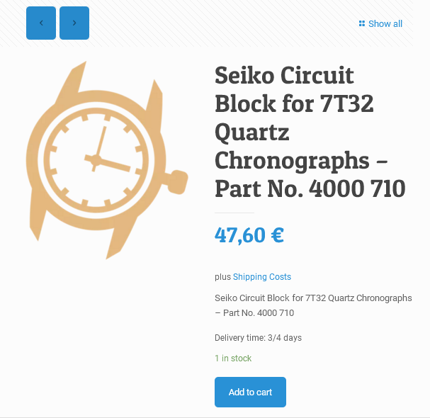

George Clarkson who used to be a regular contributor here (as garacs1), has since moved on to bigger and better things. He now has his own business / website - Only Vintage Watches. Knowing how George liked to specialize in repairing / servicing Seiko 7Txx's, I thought I'd check to see if he had any spare 7T32 PCB's for sale. He sure does !
http://www.ovw.com/product/seiko-circuit-for-7t32-quartz-chronos-part-4000-710/
At 47.60 Euros, I think I'll pass on that too ! :roll:

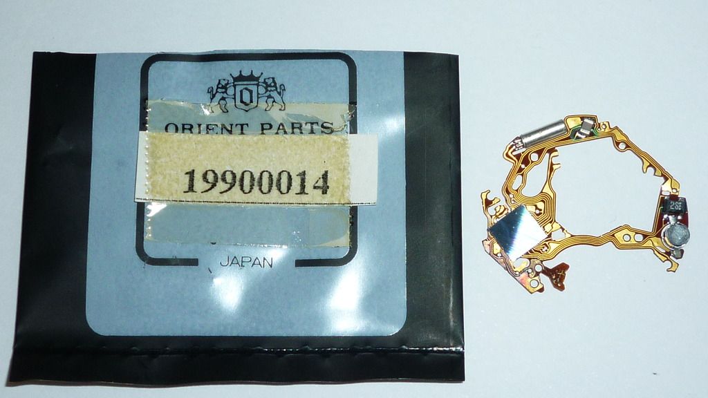

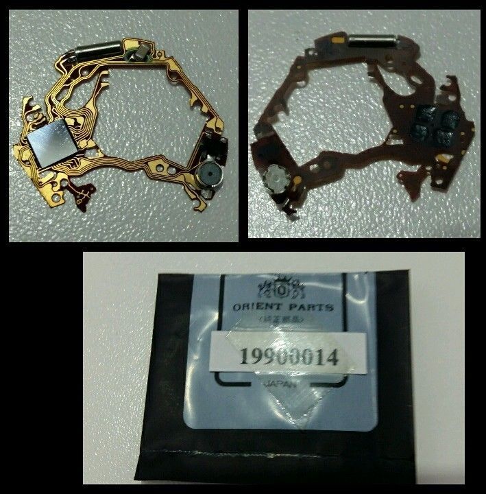

This is the Spanish eBay seller's composite photo, I'd saved from his listing, where I'd bought that single NOS Orient HFA PCB, back in April 2016.
I guess I really should have bought two at the time. I distinctly remember it cost 35 Euros and I begrudged paying that much. At one point he was actuallly offering Qty. x 2 for 60 Euros. I searched until I found one of his long since ended listings: http://www.ebay.es/itm/191798032268
I was hoping in vain that this seller samimadrid28 might still have some left, but checking his feedback, he hasn't sold anything in over a year. :(

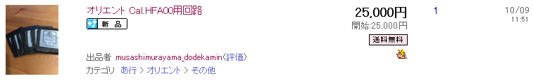

Yup 14 of the Orient HFA00 7T32 equivalent p/n 199-00014 PCB. When I first spotted the listing on Yahoo Japan, at the beginning of the week, the seller was asking 40,000 Yen as a 'Prompt Decision' Buy-it-Now, which I balked at. But when he subsequently re-listed it, he dropped the Buy-it-Now price to 25,000 Yen - which made it a 'no brainer' in my book.
http://page.auctions.yahoo.co.jp/jp/auction/p617320486
Works out at a little over £12 Quid apiece - cheap at less than half the price ! :)

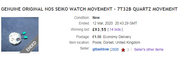

Last week, I spotted a NOS 7T32B movement, listed on eBay by a UK seller, as a 7-day auction, with an opening bid price of £4.99. I didn't have a specific need for one, as such, but these things come in handy. So I placed a low bid on it and added it to my eBay watching page. I looked at it again around 8:30pm yesterday evening and bidding was already @ £51. So I thought to myself 'Nah' and left it. It went on to sell for £93.55 after 14 bids !
http://www.ebay.co.uk/itm/303507150486
