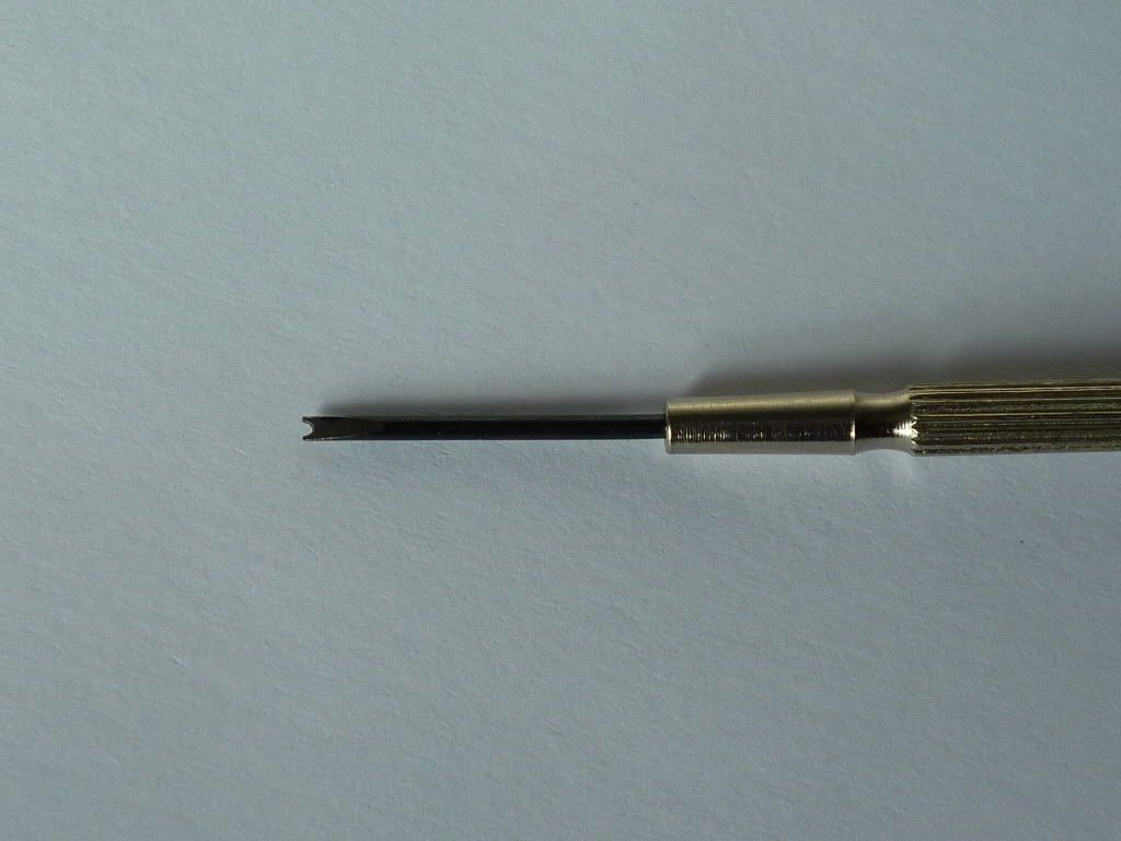

It really is as simple (both to make and use) as it looks. :)
It's just a cheap 1.2mm wide screwdriver (from an RS set, possibly) into the tip of which I have ground a U-shaped nick, using a Dremel Moto-Tool with a #409 cut-off wheel, which coincidentally happen to be precisely the correct width - 0.6mm, which is required.
You simply press down gently with the two prongs of the tool onto the open ends of the circlip. It just pops off. No drama. No pinging.

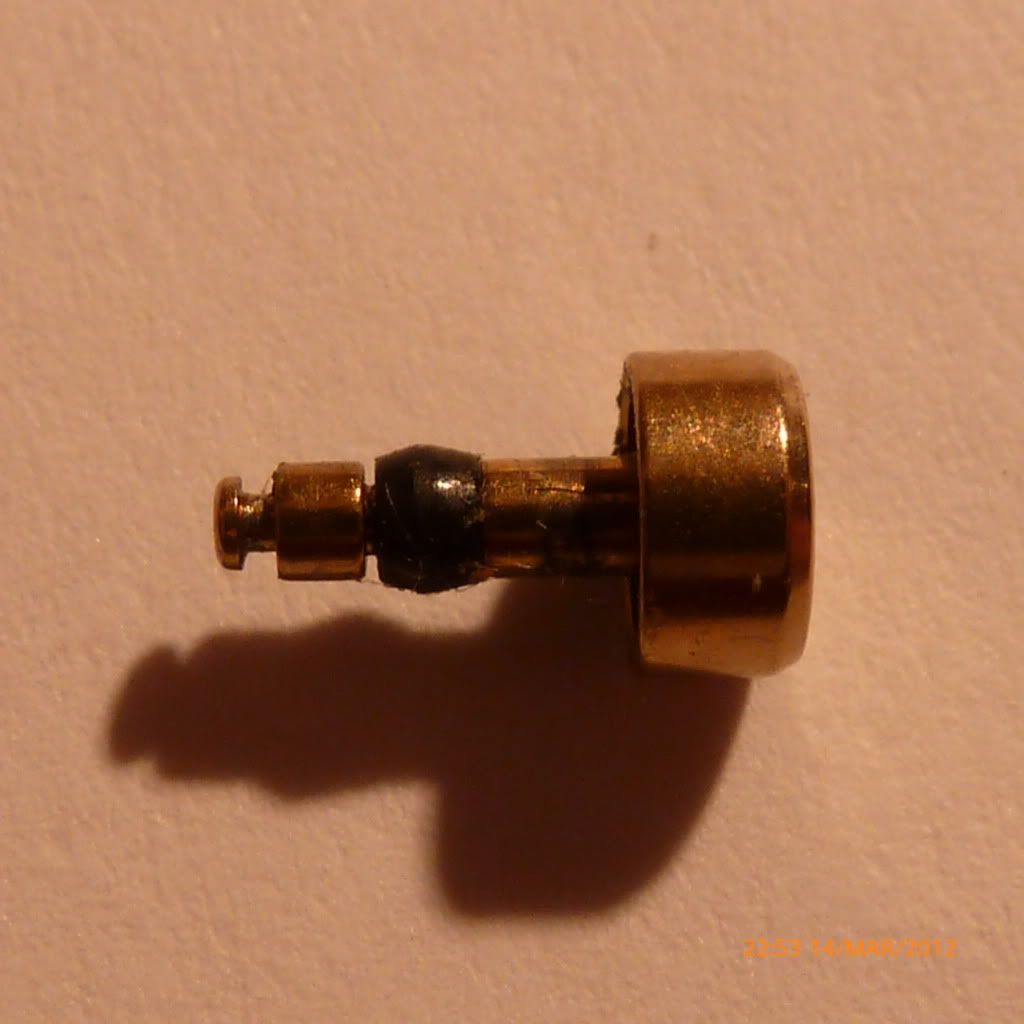

And this allowed me to finally remove the chrono pushers. Here's one each from my 7A38-7020 (the gold one at the top) and my practice 7A38-7190 (the stainless one at the bottom):
and in close-up (with springs and retainer removed):
and
and the relevant pieces:
the gasket on the gold one looks very new, I think this is why it wasn't moving as freely. The stainless gasket is much more worn.

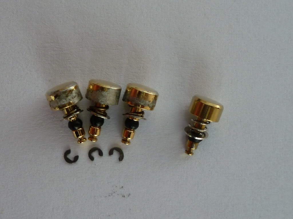

I don't have many photos on file of pushers, but here are a couple that I prepared earlier. 8)
.... except be careful if any of your gold-plated pushers have plating which is starting to lift off ....
The three on the left are actually Orient J39 pushers, rather than 7A38. They didn't go in the ultrasonic tank. That' s how they were. :(
The one on its own on the right is a NOS Seiko p/n 80600703 (same as in your two-tone 7A38-7020), which I replaced them all with.

A quick word about circlips. They are, no matter how careful you may be, prone to pinging off into space, never to be found again. :mad:
Some of the various part numbers used by Seiko include: 81400669, 81400683 and 83200271 (a substitute).

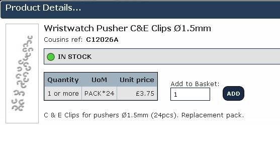

Far better to order these (Swiss-made by Eufors) - in a tube of 24 from Cousins. ;)
They're what I use myself - and price-wise, you know it makes better economic sense. :)
