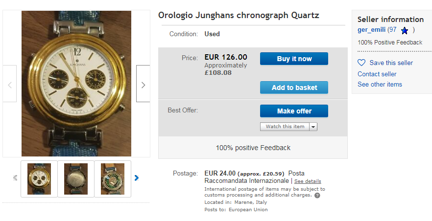

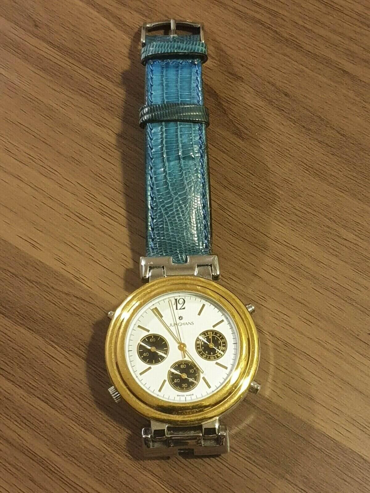

But it appears they did, because scrolling through those eBay search results, further down I found this ! :shock: It was listed by an Italian eBay seller at the beginning of June (some time after I'd run my last Junghans 'mega' worldwide search).
https://www.ebay.co.uk/itm/Orologio-Jun ... 3778622418

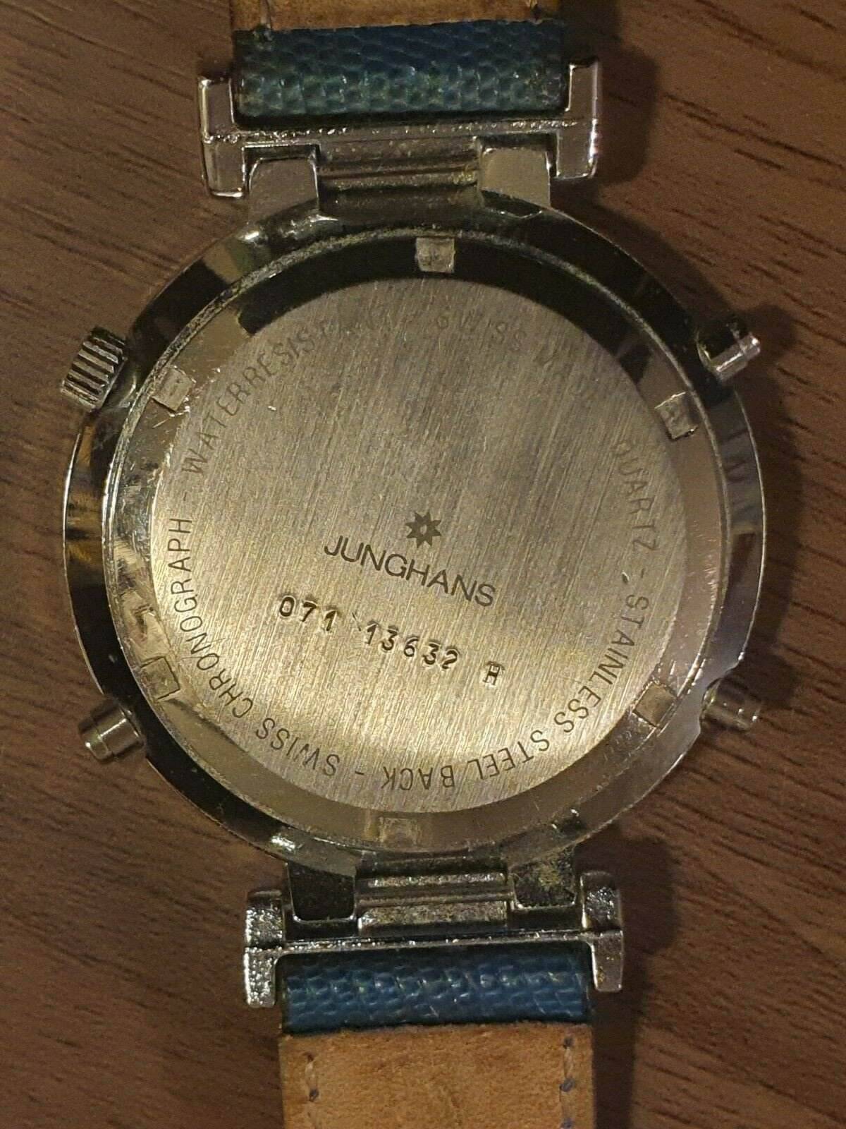

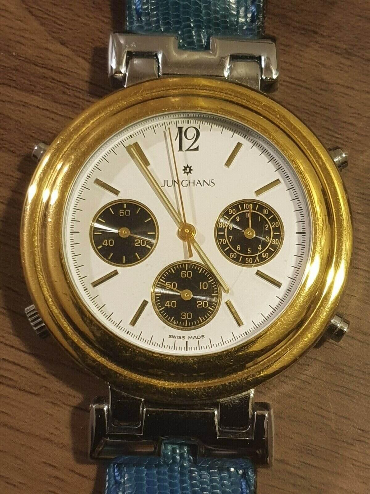

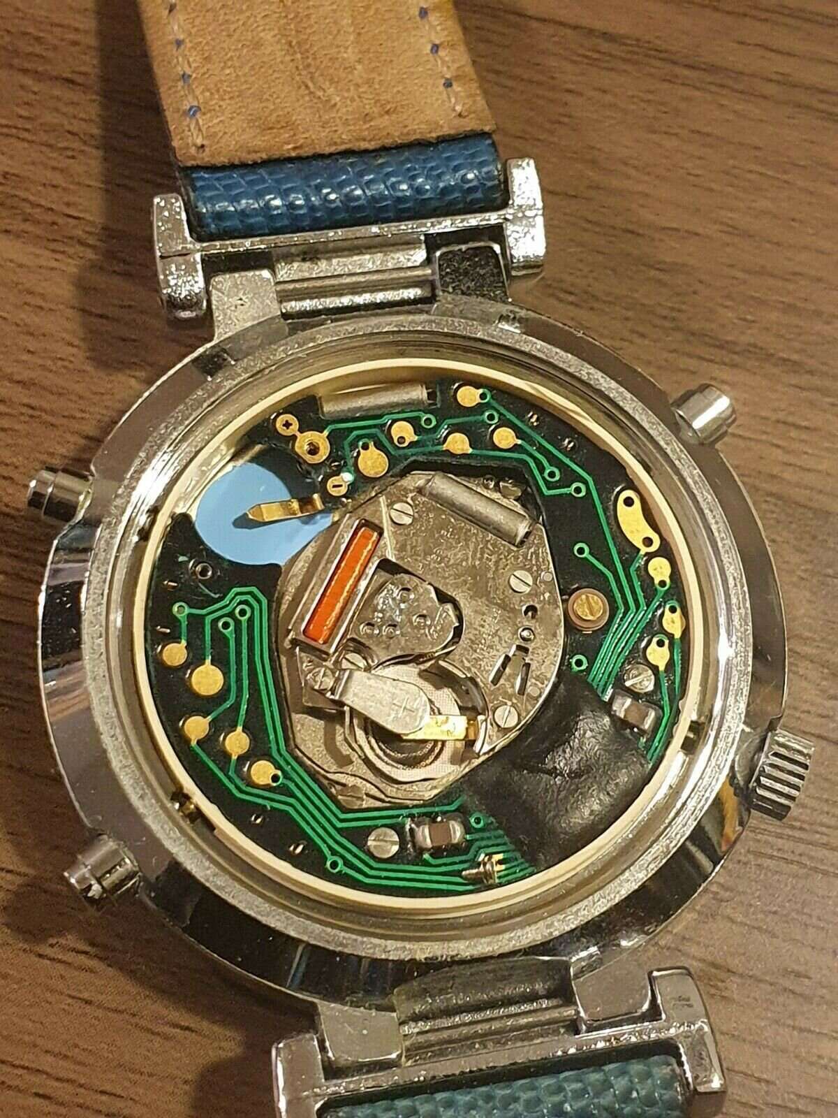

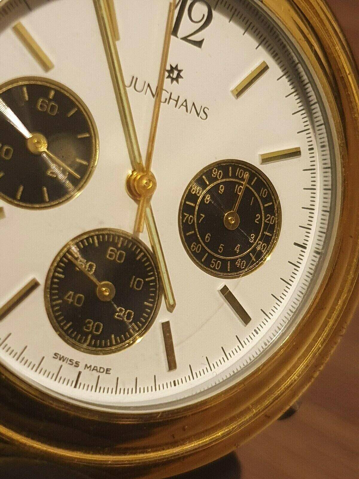

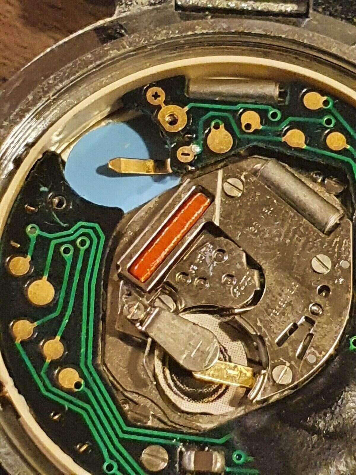

It has that familiar 3 pushers with crown @ 8 o'clock layout and 60 (rather than 30) minute counting sub-dial, as seen in almost all these style 7Axx clones. The dial carries an accurate representation of the JUNGHANS logo, but perversely it has also 'SWISS MADE' printed at the bottom of the dial (rather than say 'Made in Germany'). Naturally, the movement is the familiar twin battery composite Chinese-made 'Swiss' affair, stamped ONE JEWEL on the centre bridge plate, seen in other 7Axx clones. The case-back is stamped with something vaguely resembling a Junghans model number. It reads: 071 13632. But it has too many digits and isn't either of the traditional Junghans formats, like 24/4610 or 024/4610.44.
Re: Close Calls and Double Takes - Return of the Clones
That's where my doubts (and scepticism) began to set in. If you read back through the old forum's '7Axx clones' thread, the majority of watch brands who'd used these inferior quality quartz chronograph movements were small companies, virtually unknown or defunct, for example: ALFEX, Daniel Mink, Jean d'Eve, Louis Royal, MCA, VISA, ZentRA, ZEON, etc.
The actual title I gave that thread was: Close Calls and Double Takes - but not the real deal. That may inadvertently have been rather closer to the truth than I'd originally intended. Thinking about it more, in the light of this 'Junghans' and referring back to my posts about the Orient J85109-41 (another suspicious model number), it makes absolutely no sense nor reason why larger companies like Junghans, Orient and Yema (also amusingly 'Swiss Made') who had access to supplies of far superior quality movements, would have used these at all. I reckon they're Chinese made 'knock-offs'.
