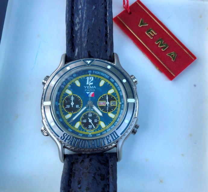

Yema Spationaute III Aragatz Purchased
Posted: Mon Aug 29, 2022 3:16 am
by jamesam

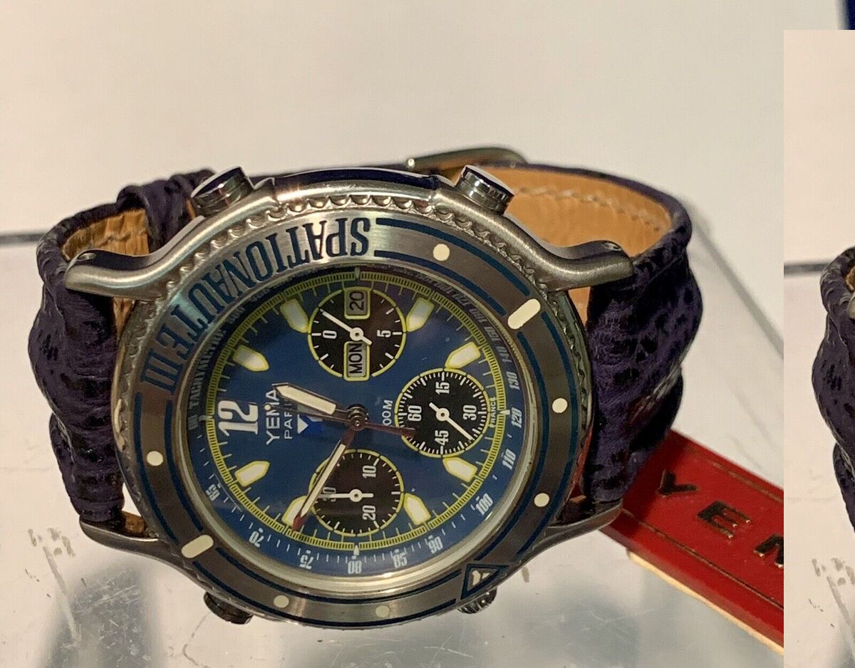

The US eBay seller listed two of them as 7-day auctions with the same opening bid price of $99.00, both ending at the same time tonight. Seller described both as “New with tags. Never worn” that were purchased at the estate sale of a jeweler, but without batteries so not running.
I purchased serial #5-591 for $202.17.
The other one, serial # 4-756. sold for $201.50.
eBay item #175390876966 and #175390869676.

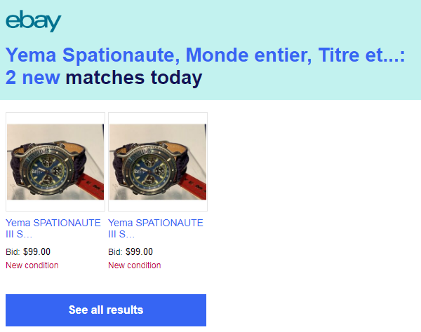

Congratulations on your acquisition James ! :mrgreen: It just goes to show that you don't necessarily need to pay inflated prices for NOS Yema Spationaute III's, despite what I wrote about greedy speculators in that other thread. Yes, those two US eBay auctions were certainly unusual in a number of aspects, clearly due to an inexperienced seller.
They came up in my eBay saved search notifications on Monday 22nd August:

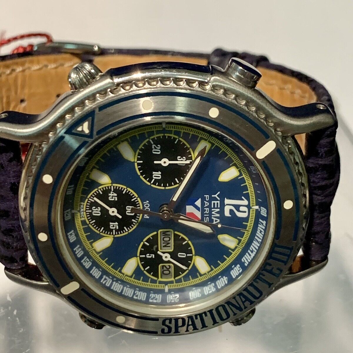

The seller used the same set of 8 photos for both eBay listings (showing case-back serial # 4-756). Here's a few of them:
Wondering if there might be any subtle differences between them, I messaged the eBay seller and asked if she could send me photos of her other NOS Spationaute III. She kindly obliged. Here's just half the additional images she supplied:

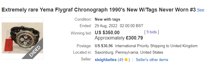

The craziest thing was that the seller not only had her two auctions for NOS Yema Spationaute III's ending at exactly the same time (6:00pm PDT / 02:00 BST on Monday 29th morning), but she also had another 7-day auction listing for a NOS Yema N8 Flygraf ending at exactly the same time !! :o
https://www.ebay.co.uk/itm/175390869676
https://www.ebay.co.uk/itm/175390876966
https://www.ebay.co.uk/itm/175390931378
I wasn't prepared to stay up till the early hours of the morning to bid, so I set up a couple of automated snipe bids using Auctionsniper. There was obviously more interest in the auction for the N8 Flygraf, because it had over 50 watchers. It sold for $350 after 9 bids - I was out-sniped. But as I've written many times before, I really didn't need another .... :P

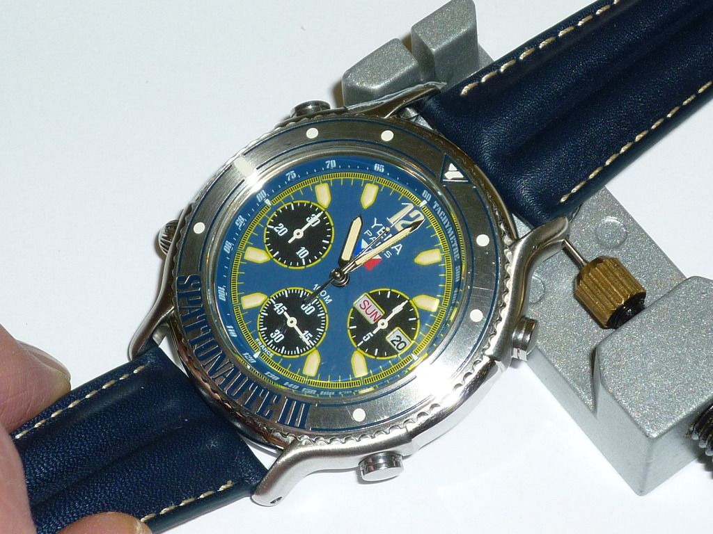

I read your post about using the Seiko S-926 band-sizing tool to remove the existing pin and tube to change the strap. Are you recommending against that as something that might still end up damaging the lugs?

Although I originally recommended using the Seiko S-926 bracelet sizing tool, the cheap ex-eBay link remover (with the wider jaws) that I discovered later works just as well. Whichever tool you use, place a couple of small strips of 'Duck' tape on the lugs to prevent them being marked - just visible in the photo below.

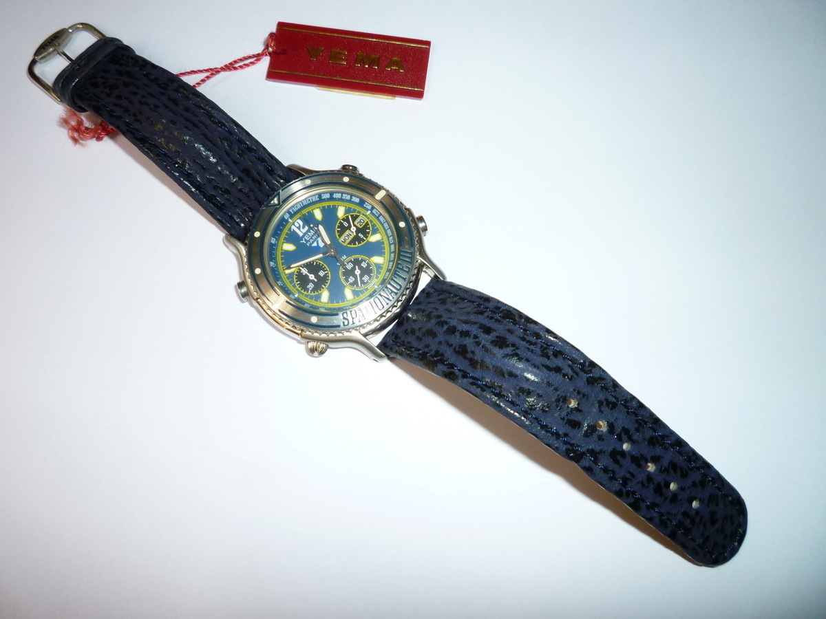

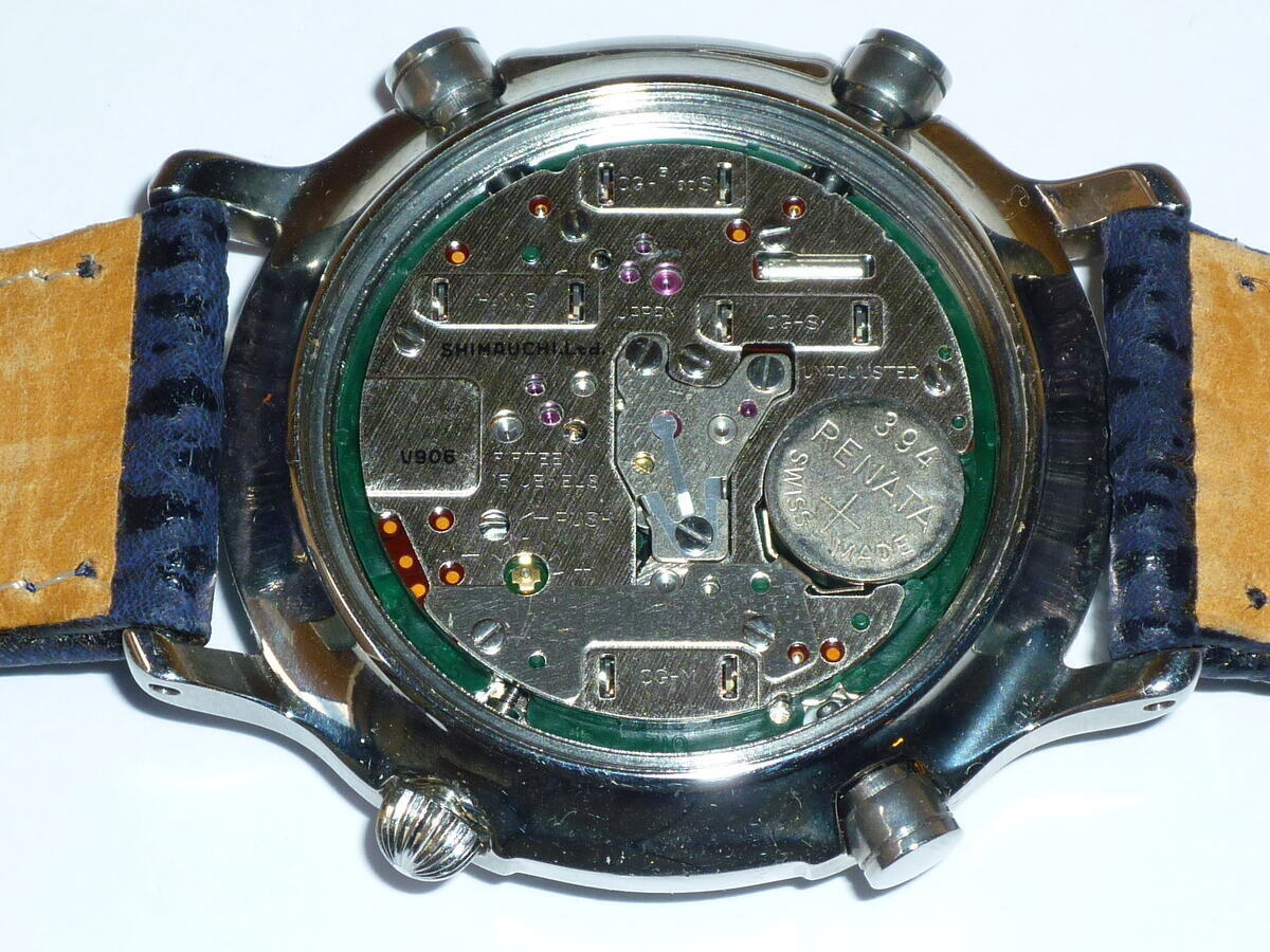

My NOS Yema Spationaute III was delivered late this morning, although I nearly missed spotting it. Hermes, a notoriously unreliable UK courier company, who've re-invented themselves as 'Evri' and handle the import / UK delivery of eBay's Global Shipping Program, advised earlier today that it had left their depot. No knock at the door, no signature. I found the package dumped unceremoniously in an empty flower pot near my front door just before Midday, after checking their tracking history again, only to discover it had been delivered at 10:50am ! Although the outer shipping carton had been damaged, thankfully the US eBay seller had packed it well in wads of tissue paper.
More or less as I received it (but with the bezel correctly oriented and strap unbuckled for the purposes of the photo):
The case-back was screwed on very tightly, but my custom tool made relatively light work of it. It was evident that it had been unscrewed at least once before from a short slipped tool-mark (bottom right removal hole).
jamesam wrote: Sat Sep 03, 2022 7:55 pmWould be interested in hearing whether it has no battery at all or a dead battery inside -- when I asked the seller she had no idea.
The (long since flat) replacement Renata battery which had been fitted showed signs of gassing ....
.... but thankfully no leakage. The battery well was almost spotless:

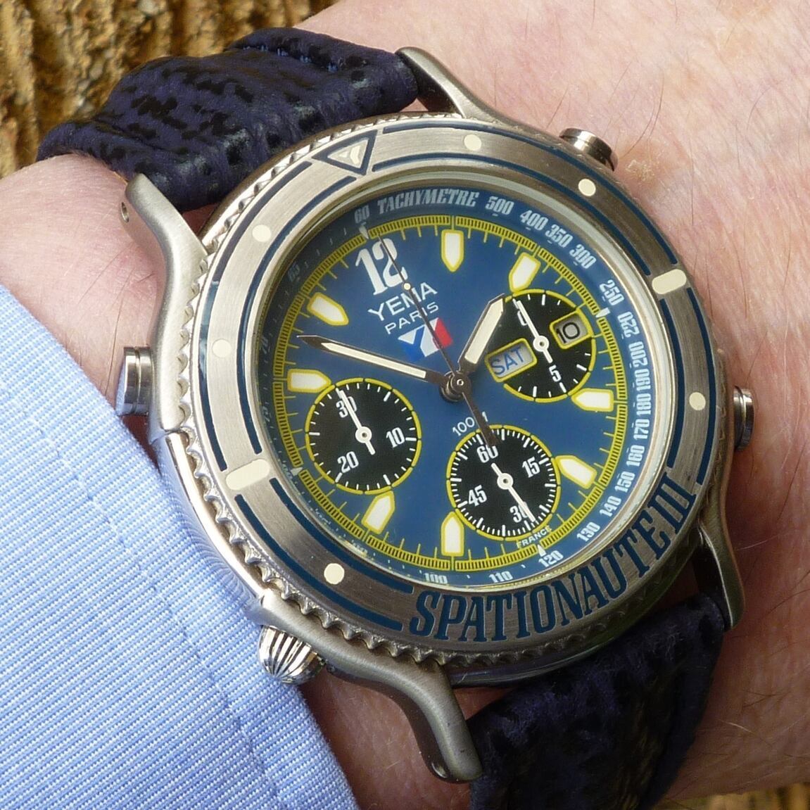

First quick and dirty wrist shot, just in time for lunch. I'll take a couple more this afternoon.

Here's another slightly better wrist shot - different to the couple I posted in the WRUW thread earlier this afternoon.

Here's another slightly different wrist shot (post correctional adjustment) to the one I just posted in the WRUW thread.
