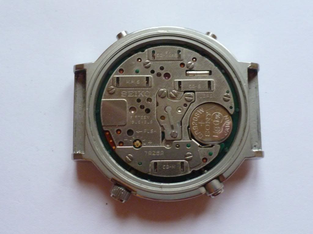

I took a few pictures yesterday when I was working on this.
The movement (with wrong battery):

Notice anything unusual (to my eyes, at least) about that movement's anti-magnetic back-plate, Simon ? :/
November 17, 2013 at 8:03 AM Flag Quote & Reply
Ah - just spotted it Paul (I think).
You're referring to the position of the trimmer switch?
I set this back to mid position when I took the backplate, PCB and 710 block off to give the movement a basic 'clean' and oil.
If not this, please tell me!!
November 17, 2013 at 10:50 AM Flag Quote & Reply
No - it wasn't that, Simon. :lol: Would I nit-pick your workmanship ? :P
Notice anything unusual .... about that movement's anti-magnetic back-plate ....
Perhaps it's possibly because I haven't studied that many 7A28(A) movements ....
But this one in your 7A28-7000 Aliens is stamped CG - 5/100S; H.M.S., CG - S and CG - M over the coil blocks.
In my limited experience of SEIKO 7Axx (mostly 7A38) movements the back-plates aren't normally stamped in these positions.
Yes, you'll see it on Yema (Shimauchi V 906) and Cartier Ferrai Formula (Cal. 531) movements .... but not often SEIKO back-plates.
But coincidentally and hilariously enough, look at the position of the rotary step switch in this photo of the Shimauchi V906 movement in my very first Yema Spationaute III - one of the first close-up shots of a 7Axx movement I ever took:
