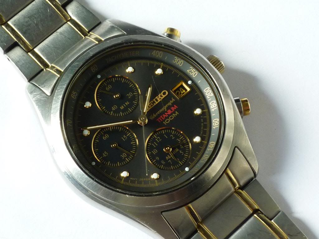

This is the watch in question - a 7T62-0FD0 SNA559P1
Perhaps you can see what I meant by the 1980's styling - anodized titanium and two tone. By modern(ish) standards, it's also relatively small - only 37.5mm in diameter. It's also incredibly light. The serial # on the one I'm currently working on begins 87xxxx, so I'd suspect it was manufactured in July 1998 (rather than 2008). Though when I tried using John Gauch's Seiko Watch Production Date Calculator it came up as 'Unknown' - which probably means he hasn't yet added the 7T62 to his look-up table yet.
Here's a photo I took of it earlier this afternoon - as received. Note the chrono' hands (sweep for 1/5 second and 12 o'clock sub-dial for 60 minutes) are all over the place, rather than zero'd. Something which concerned me a bit - before I'd even unscrewed the case-back.
Et voilà ....
As you can see from the finger-marks it's had at least one battery fitted before. It was a Seiko SR927W, so I replaced it with a Maxell #399 direct equivalent. There's no AC reset needed (as with a 7T32). Fortunately when I turned it over, it had started ticking away merrily and the chrono' hands were static - in exactly the same place. Sigh of relief !
I zero'd the chrono' hands using the procedure shown on page 7 of the user manual I'd linked above (mostly for my own benefit):
Worked perfectly first time. :D

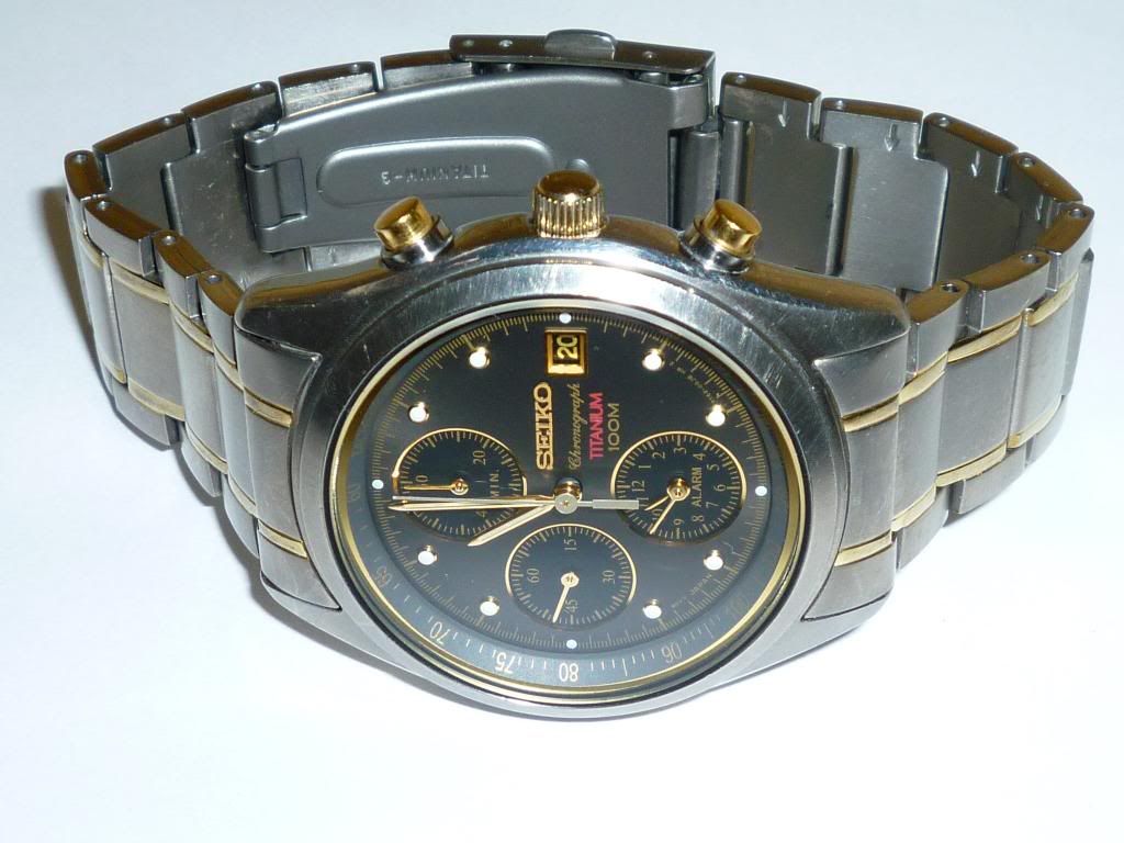

Or maybe just one small unrelated issue. I told the watch's owner that if everything went well, I'd replace the scratched crystal at the same time. The tiny release lever was initially rather reluctant to allow me to withdraw the crown stem, but I got there eventually and popped out the movement, which like other 7Txx's, carried on ticking away without the stem connected. I'd already guessed the crystal was a 31.0mm and around 1.5mm thick, so I'd been planning to replace it with a Sternkreuz MSM310, of which I've got a few in stock.
It came out cleanly and measures 31.0mm x 1.65mm thick. But it also has a gold decorative rim on the underside, which is just about visible in my Q&D photo. Sounds familiar ?

Simon had indeed captured 'the gold ring' far better than I had (spectacularly failed to do so) in my previous photo of the 7T62-0FD0.
Suspecting that it was probably the correct p/n 310P03HB0A crystal I needed, I emailed Simon a 'begging letter'. He duly obliged.
The crystal arrived yesterday; I fitted it about 10 minutes ago. Not the best of photos, but this one does show the decorative gold ring:
