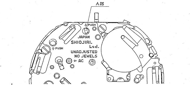

It's the full specifications for the S.Epson Corp. YM55A movement, with a complete set of engineering drawings, including this one:
Scroll further down the document and on pages 12, 13 you'll find this partial illustration showing the back-plate annotated Shiojiri Ltd.*
This is where it gets really interesting.
Those last 5 (un-numbered) pages 12-16, making up the .pdf document bear the credit and signatures of  W DESIGN GROUP

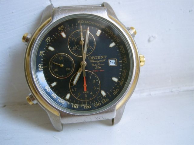

Another Orient JCAxxxx variant - a rather battered-looking gold-tone came up in my eBay saved favourite search notifications today:
http://www.ebay.co.uk/itm/171121186516
VINTAGE ORIENT CHRONOGRAPH QUARTZ MENS WRISTWATCH
As you can see, if you zoom in on the lower photo, the movement back-plate is stamped Orient Watch Co. Ltd. JCA00 (NO JEWELS).
Although not officially a member of the Seiko 7Txx family (being a re-branded YM55A), you've got to admit that, at first glance, it bears an uncanny resemblence to the Orient HFA000 (their re-branded 7T32). That's the reason why I started this thread in this section. 8)

I'm getting quite good lately, at recognising these various YM55A powered chrono's popping up everywhere. 8)
This Timberland listed on eBay Germany was easy to spot from the crown / pusher arrangement (basically as 7T32, less one crown).
http://www.ebay.de/itm/171306478257
But the sub-dial hands and markings of the 1/20 second counter had me scratching my head for a moment or two:
The hour hand in the uppermost sub-dial is that red triangle pointer. Note also the 1/20 second sub-dial is actually graduated to '20'.
