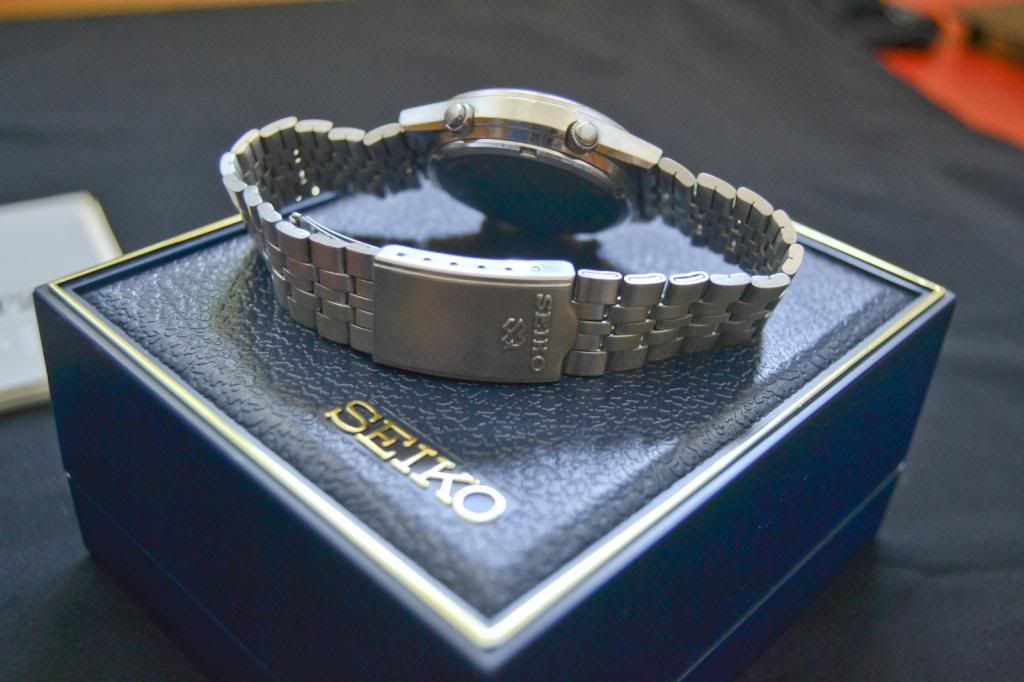

I've had a few pass through my hands, over the years - including a couple that were in almost NOS condition, that I still own:
I've also had a couple of other lesser examples, one of which I specifically remember buying with the intention of breaking it for parts.
What usually lets this particular model down is the bracelet. Although the main (folded) link sections themselves look fairly strong, it's the small 'U' channel section joining links between them that are weak and prone to stretching and breakage.
According to Seiko Oceania's database, there only ever was one bracelet part number used on the stainless 7A38-7190 SAA053J - B1405S. (They're actually stamped B1405.E on the underside of the end link joining tubes). Same for all three variants: J1, J8 and J9.

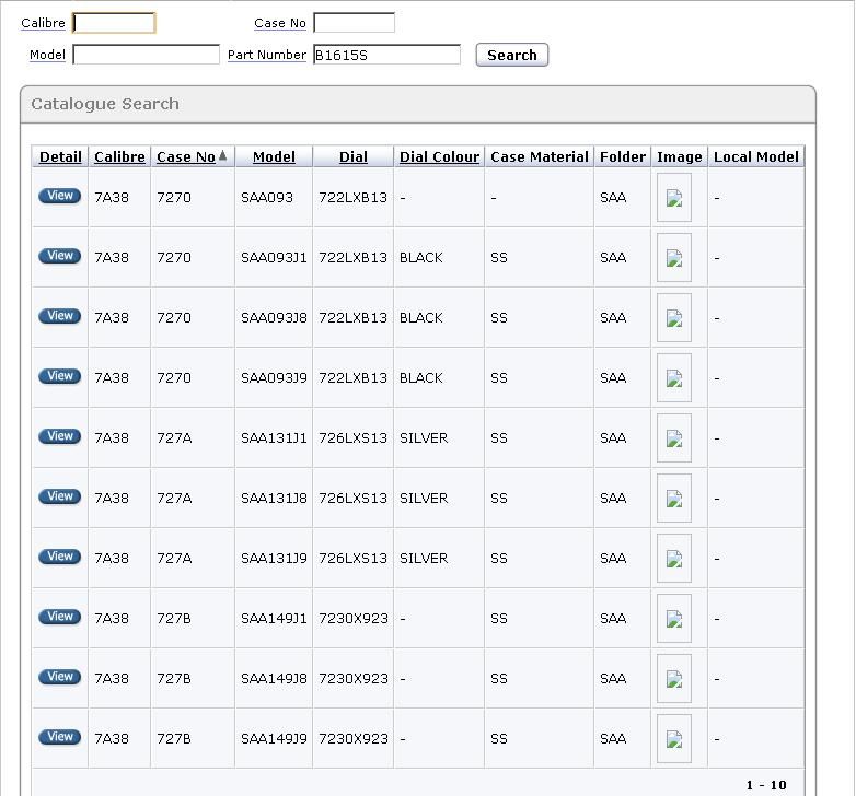

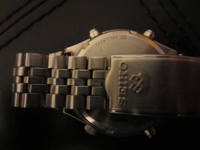

The reason the bracelet looks right, on this particular watch head, is because it's a Seiko p/n B1615S - as normally seen fitted to the stainless 7A38-7270. Zoom in on the photo of the case-back and you can see B1615.E stamped into the bracelet end link fixing tubes.
Problem is, if you do a reverse look-up (i.e. ask 'where used' ?) on Seiko Oceania's database, B1615S only returns these (3) results:
Being: the stainless black-faced 7A38-7270 (which presumably everyone is familiar with); the far-less-commonly seen stainless silver-faced 7A38-727A and the even scarcer off-white faced 7A38-727B. No reference to this bracelet being used on the 7A38-7190 at all.

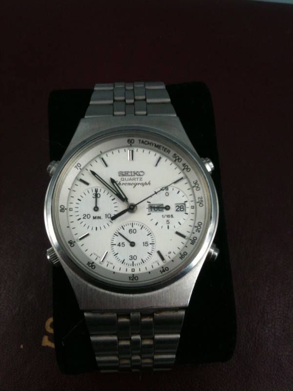

So why didn't I just dismiss this as strega_68 being smarter than your average eBay watch-botching bracelet-swapping seller ?

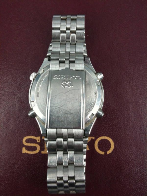

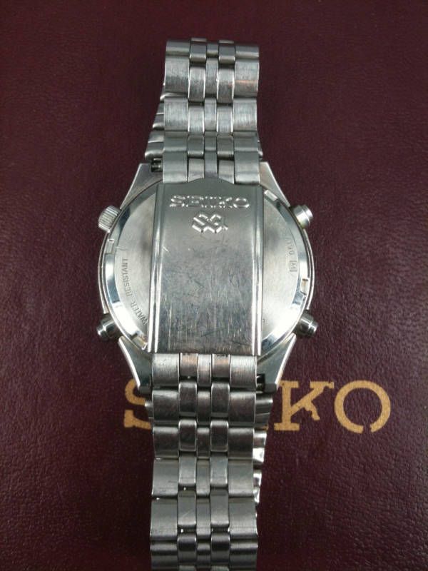

Because I've previously seen a couple of other stainless 7A38-7190's fitted with the B1615S bracelet - on eBay, back in October 2010:
Although photos may look similar, this is not the same 7A38-7190, but another listed by the same seller - note different serial number:
April 13, 2013 at 12:35 PM Flag Quote & Reply

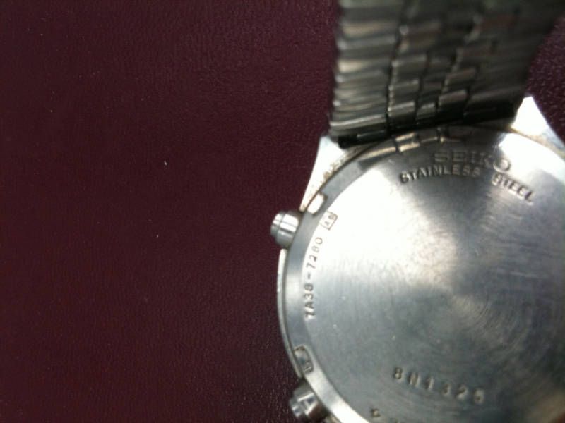

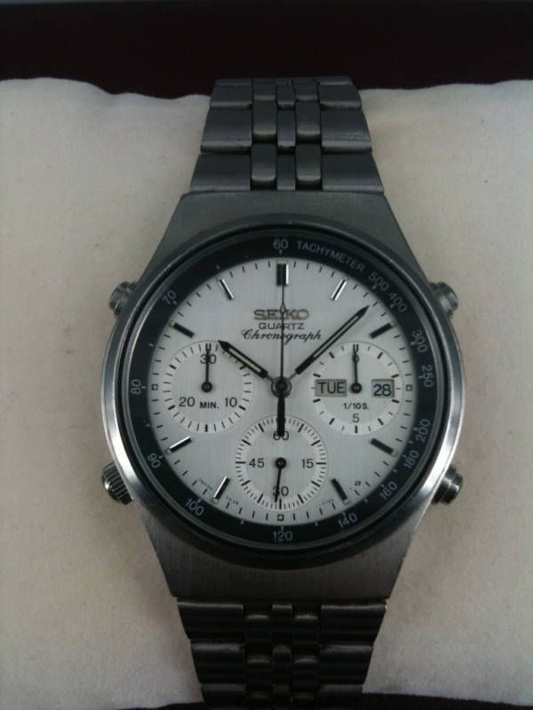

That 'correct' stainless 7A38-7190 was followed closely by the sale of yet another in November 2010, except this one was UNIQUE. :roll:
Indeed it was !
Although (apart from the 'UNIQUE' black Tachymeter ring) it may have looked very much like the two stainless 7A38-7190's fitted with 'wrong' B1615S bracelets previously sold by this same person, it was in all likelihood, originally a stainless (black-dialed) 7A38-7270 fitted with (the same) white 710L dial and movement and case-back from a stainless 7A38-7280 - in other words: a proper Franken !
April 13, 2013 at 1:47 PM Flag Quote & Reply
So, if this collector (or the watchmaker he used) was capable of nailing together something like the above - who is to say that he wasn't equally as capable of swapping knackered or broken p/n B1405S bracelets on two stainless 7A38-7190's for a couple of p/n B1615S bracelets off stainless 7A38-7270's ? Ergo - three wrongs (even if they're the same wrongs) don't necessarily make it right, do they ?

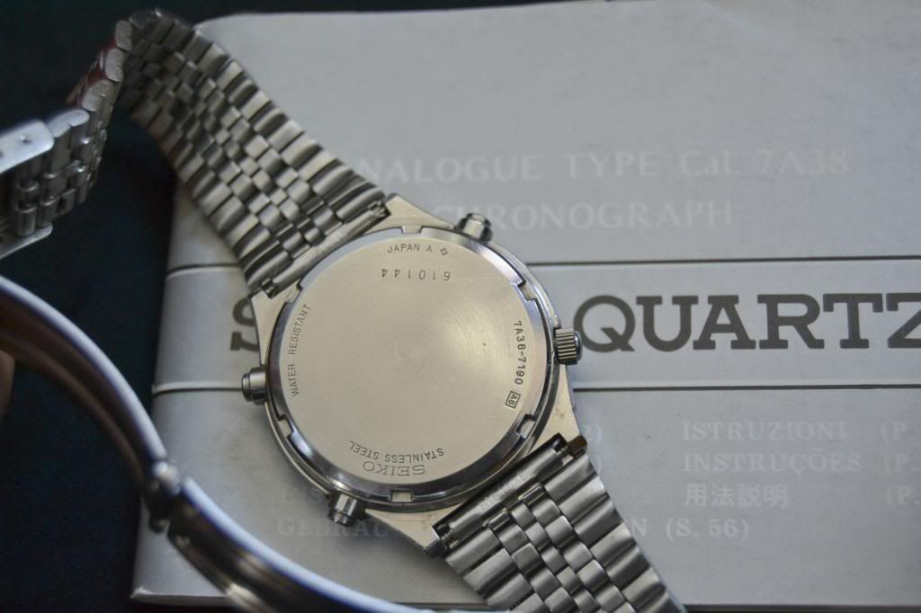

Because tonight, another stainless 7A38-7190 fitted with the same 'wrong' p/n B1615S bracelet was listed by a Portuguese seller:
http://www.ebay.co.uk/itm/221215790943
But is this actually another, or in reality just a simple case of Déjà vu ? ;)

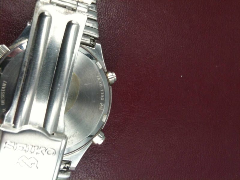

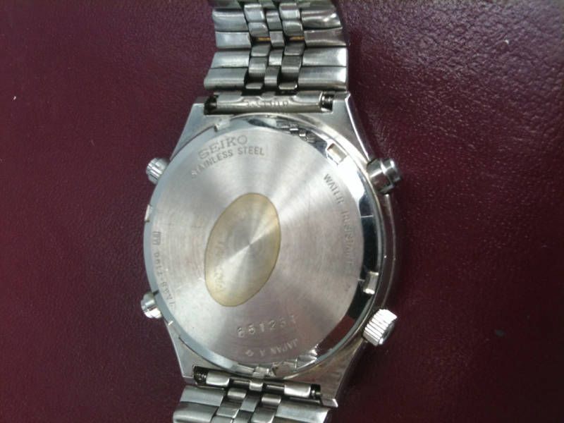

Looking at this seller's photo of his watch's case-back, the serial number, relative position of the yellowed JWC inspection sticker ....
.... suddenly look all too familiar. This appears to be one of the 7A38-7190's + B1615S bracelet sold by pgpmd back in October 2010:
Hard to quite make out the serial number in both photos, but it's something like 651231. Other than that, everything else points to it.
For me, apart from the perfectly identical alignment of the case-back, this small scratch under the 'A' of the 7A38-7190 clinches it. 8)
Only problem being that this Portuguese eBay seller's ID doesn't match any of those who purchased 7A38-7190's from pgpmd in late 2010. But then again, one of those buyers was watch-co-usa - a prolific eBay watch dealer, who likely sold it to the current Portuguese seller. Unfortunately there's no proving it conclusively from feedback. Then again, like many of us, he may use another ID for buying.

Although I'd already proven it was the same 7A38-7190 fitted with a 'wrong' B1615S bracelet, s/n 651231 from the two sets of photos,
.... I will admit that it was bugging the hell out of me that I couldn't tie the current seller to pgpmd through the eBay feedback chain.
So I thought I'd try messaging the Portuguese seller, and ask him directly who he'd bought if from. You can but try.
He was a bit evasive at first, but we got there in the end:
I buy in Ebay on 15-10-2010.
Seller: pgpmd ( Bid history - Bidders: 10, Bids: 22 )
Item location: Wild Wonderful West Virginia, United States
Post to: Worldwide
Which ties in perfectly with the dates I saved the photos from pgpmd's eBay listing - 7 days earlier on 8-10-2010. Case closed M'Lud.

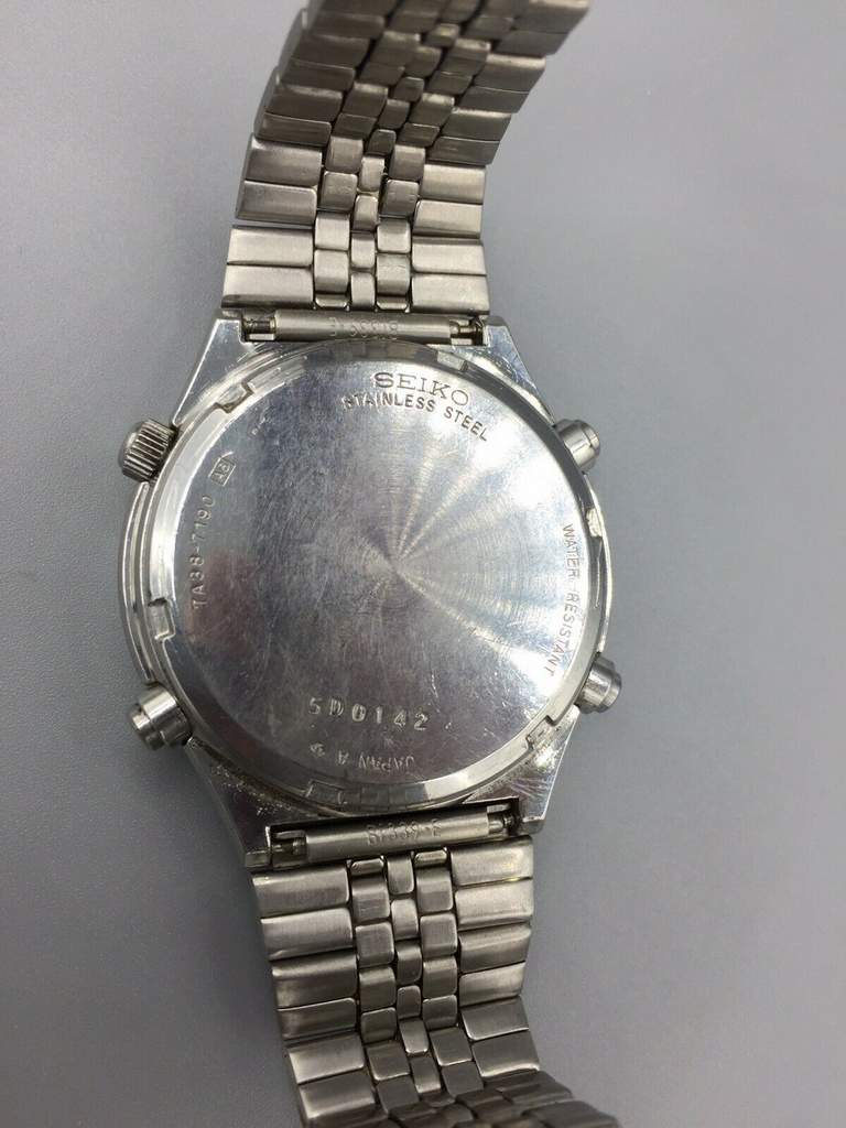

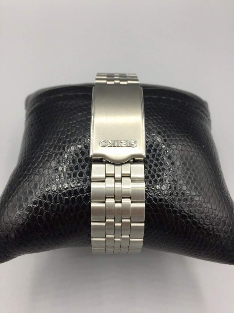

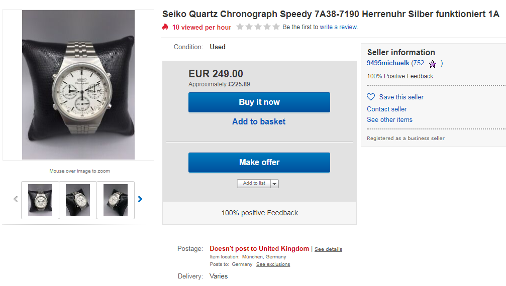

5 years on since Don and I last discussed it, another Seiko p/n B1339S bracelet (stamped B1339.E) turned up fitted to a stainless 7A38-7190 (as opposed to the previous stainless 7A38-7270's), listed by a German seller, earlier this morning:
http://www.ebay.co.uk/itm/233652447542
I'm only going to bother up loading the eBay seller's last two photos:
The seller's description states: Mit dem original Seiko Edelstahl Band.
Funnily enough, only yesterday I'd posted this wrist shot in the WRUW thread, of my second string stainless 7A38-7190 SAA053J fitted with what is generally accepted as being the correct Seiko p/n B1405S bracelet (i.e. as shown on their database):
Of course the stainless 7A38-7190 and stainless 7A38-7270 share the exact same hooded lug watch case, with 18mm lug width fitting. But thinking way back (7 years ago) this isn't the only instance I've seen of something very similar. Indeed, I asked myself the question back then in what was effectively a dedicated topic (i.e. here).
Where this example differs from those previously discussed in this thread, 7 years ago, is that this 7A38-7190 is fitted with a very similar appearing Seiko p/n B1339S bracelet, which is normally found on the quartz analogue 8C23-6050 or -6059.
I know for a fact, that some Seiko service centres have retro-fitted alternative similar appearing replacement bracelets to customers' watches, when stocks of the correct original bracelet were no longer available. But would Seiko manufacturing have done the same, had there been a supply problem during a production batch run ? Perhaps they may have done so under the guidance of a temporary manufacturing deviation / exception notice. I doubt we'll ever get to the bottom of it. :/
