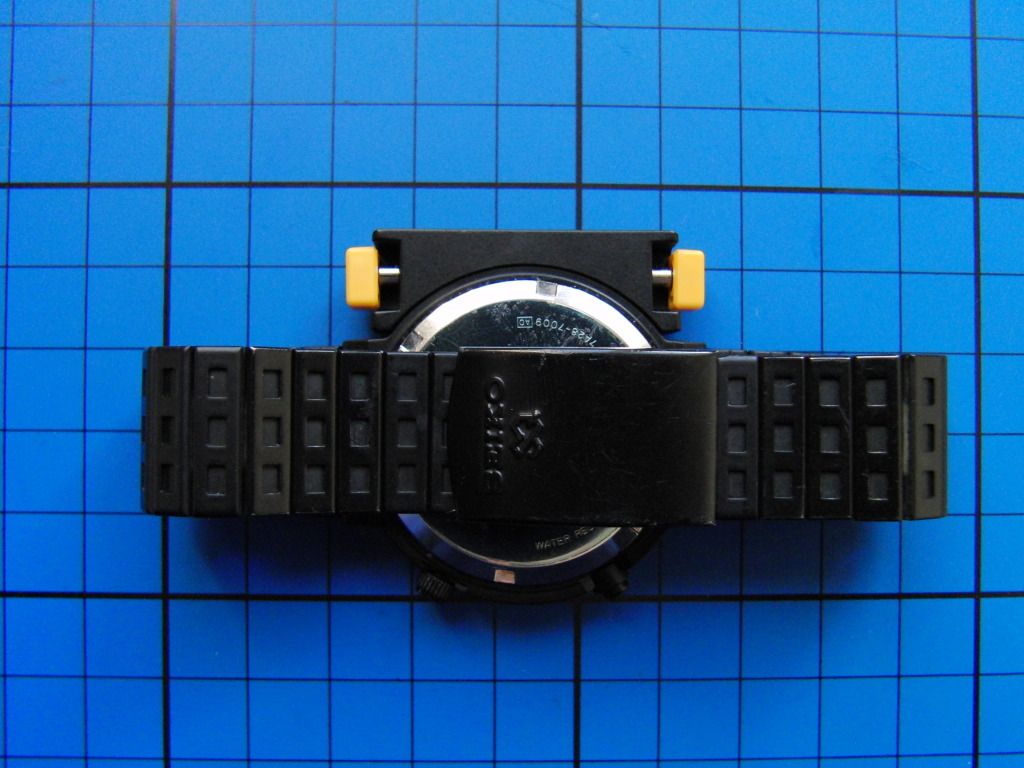

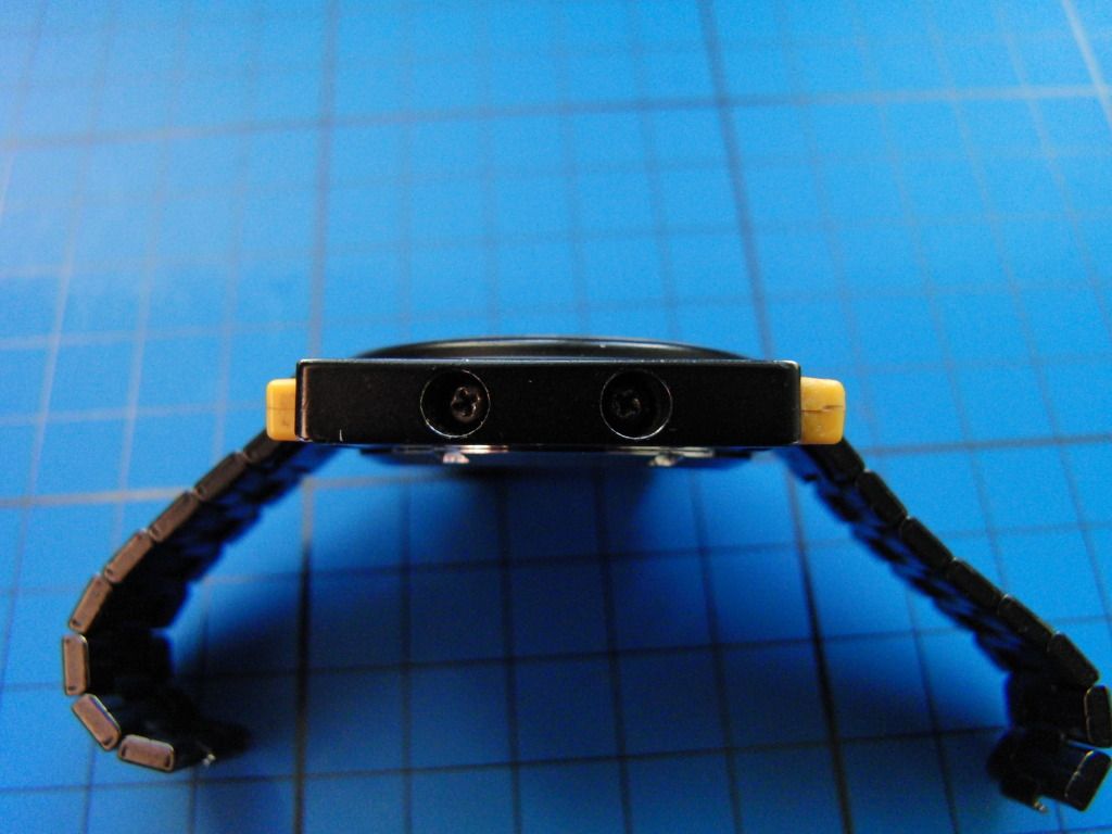

Here's the watch with the original pushers:

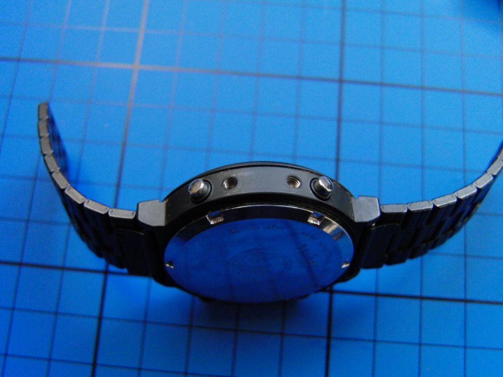

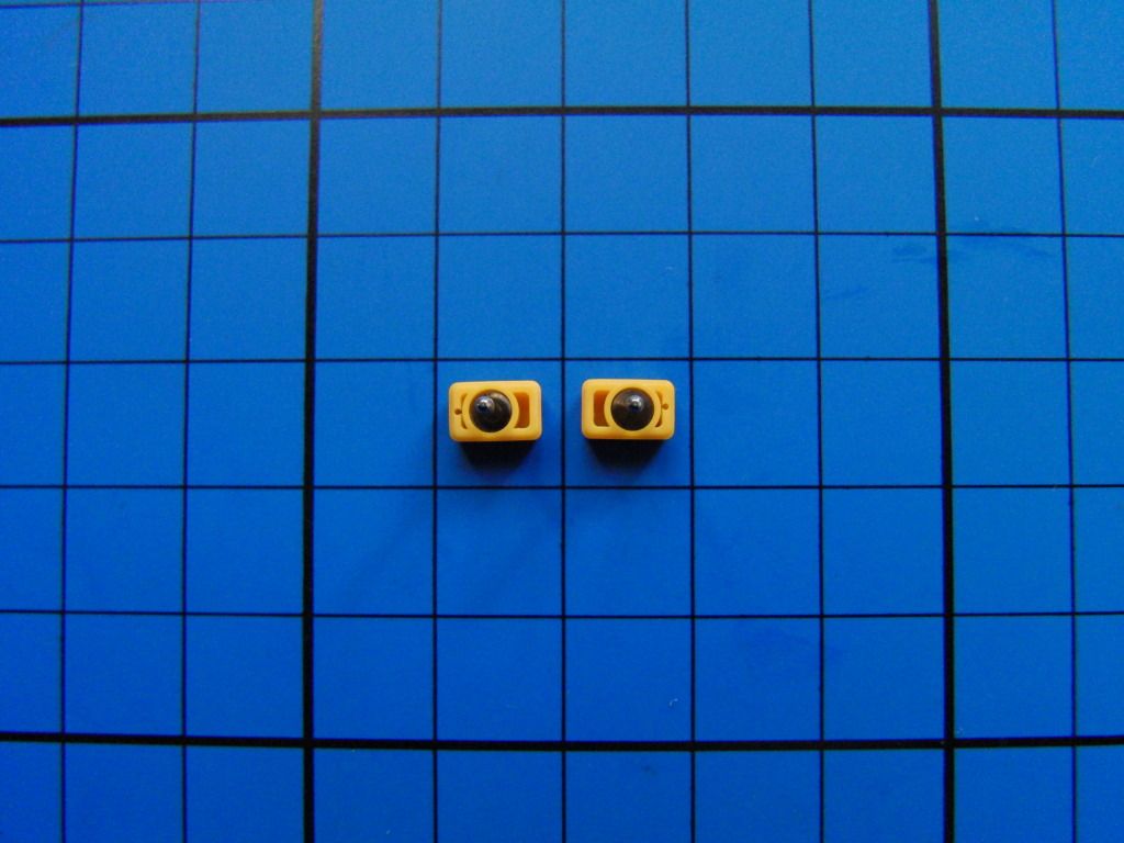

everything looks pretty good here. But, this side on shot shows the inevitable cracking to the plastic pushers:

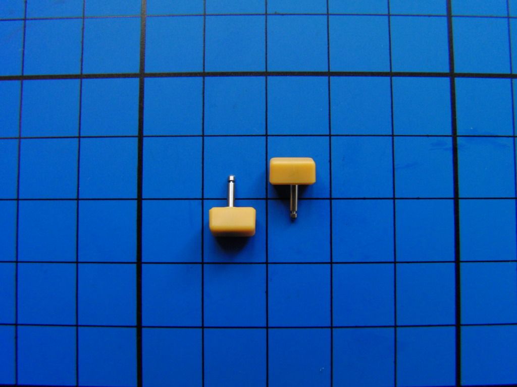

Here's the left (lower) pusher, pulled off its metal stem:

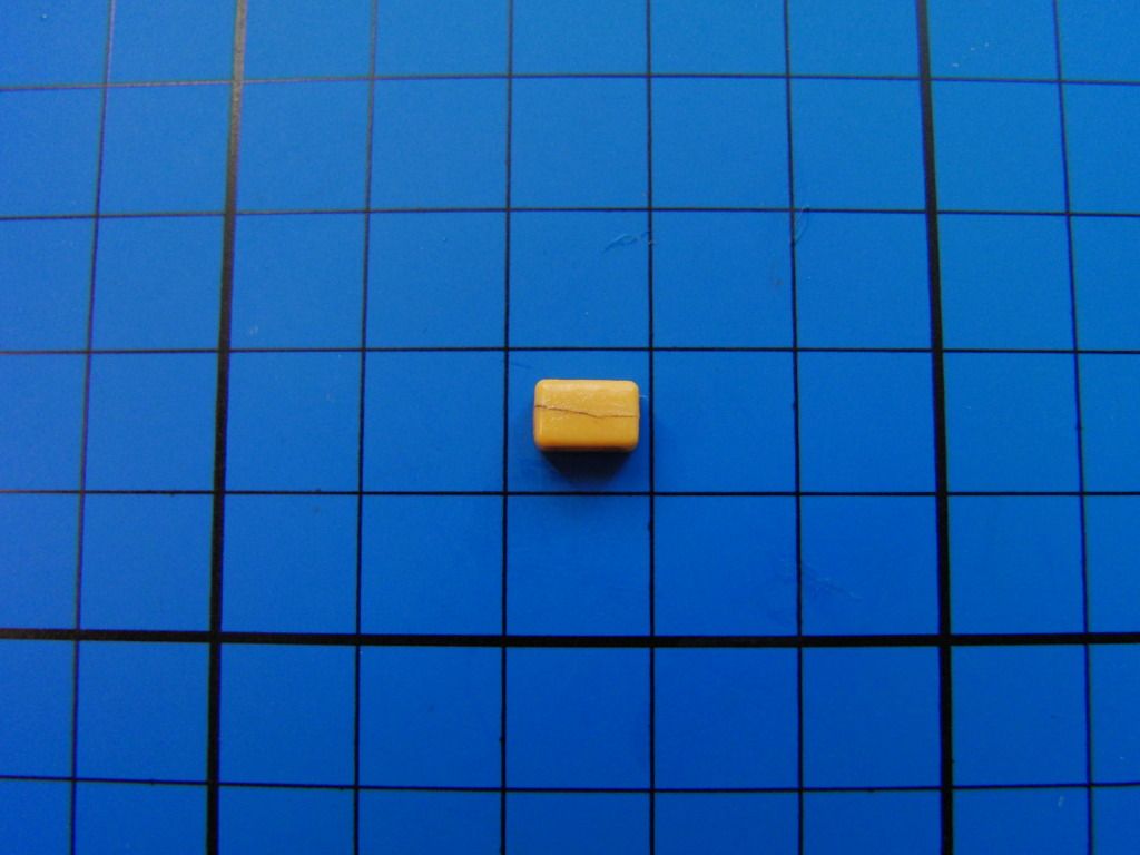

You can just make out the hairline crack at 9pm. This split was enough to allow me to pull the pusher off the stem. Here's the right (upper) pusher:
not a pretty sight - completely cracked and a loose fit over the stem. You can see I did try superglueing it, but the brittle nature of the glue, with the brittle plastic wasn't a good combination.

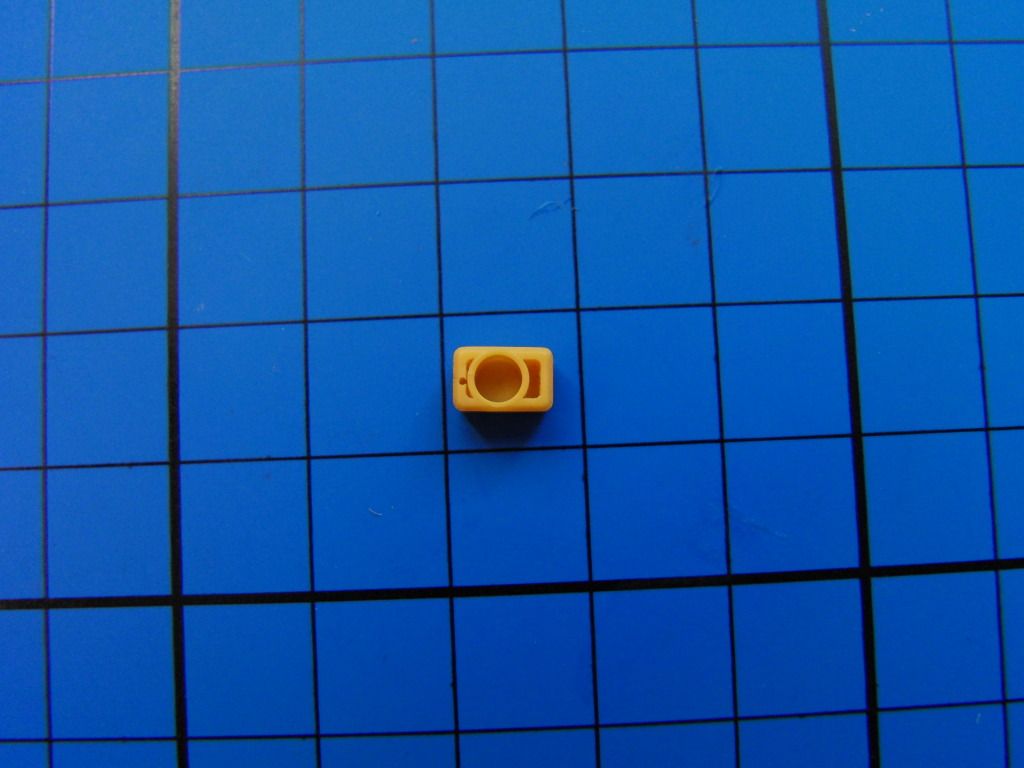

Well, luckily I found a source of these pushers and 4 of them arrived last week. So, it was pusher replacement time :D
However, this is where it got a bit more complicated.
I'd wrongly assumed that the yellow pusher was a push / friction fit onto the stem, and that it would be easy to push replacements onto the existing stems.
No, the pushers are a very tight fit onto the stem, and I think that trying to pull them off the stems they come fitted to, and/or trying to push them over the existing stems would probably result in cracking them - which would kind of defeat the object of the exercise :roll:

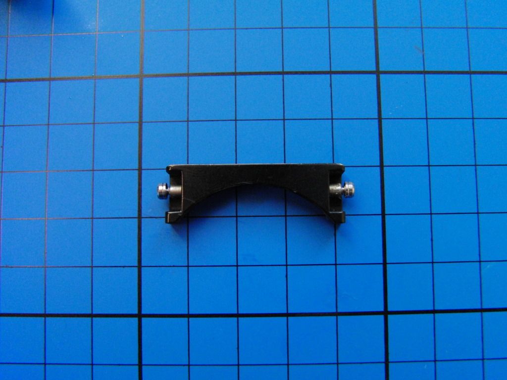

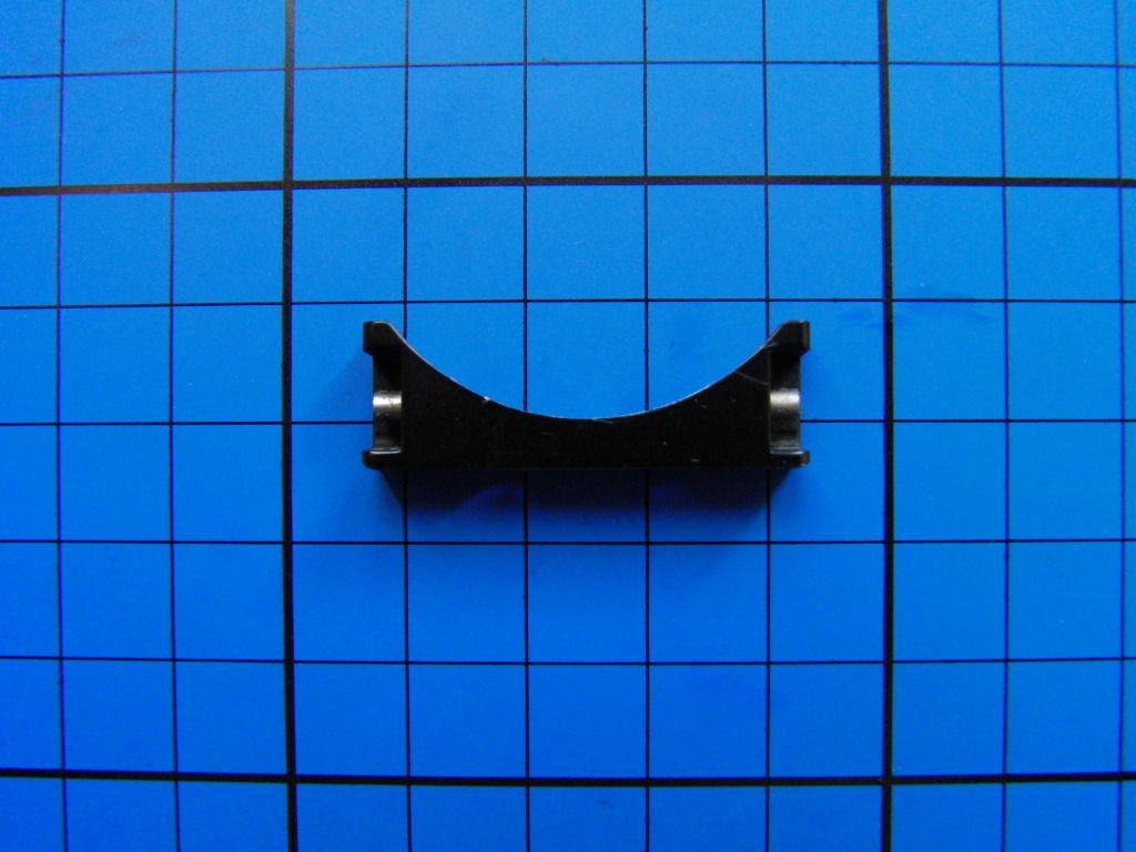

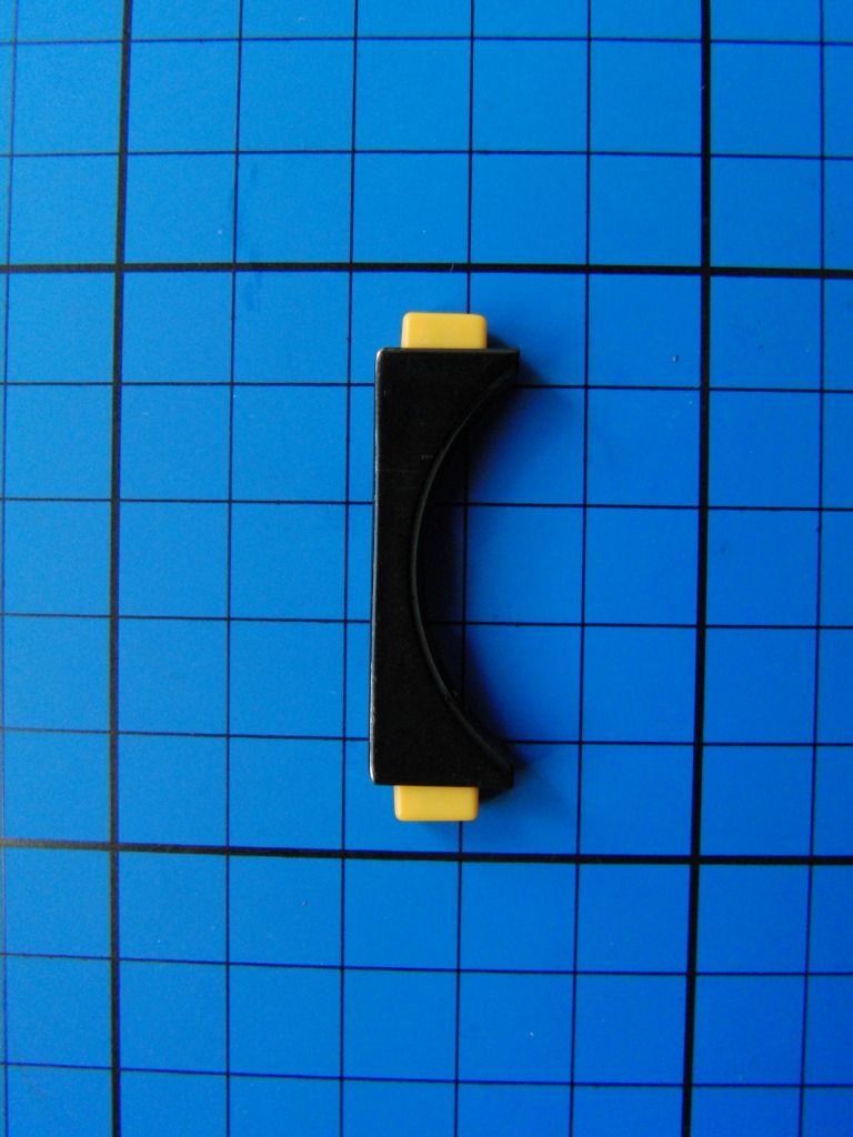

So, it was time to remove the pusher block, attached to the side of the watch with two phillips screws.
Here we are:
and the underside, with the pushers off:

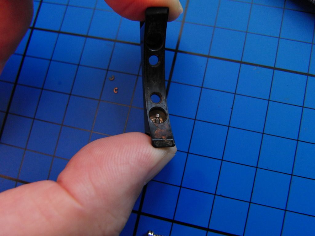

and a shot of the inside:

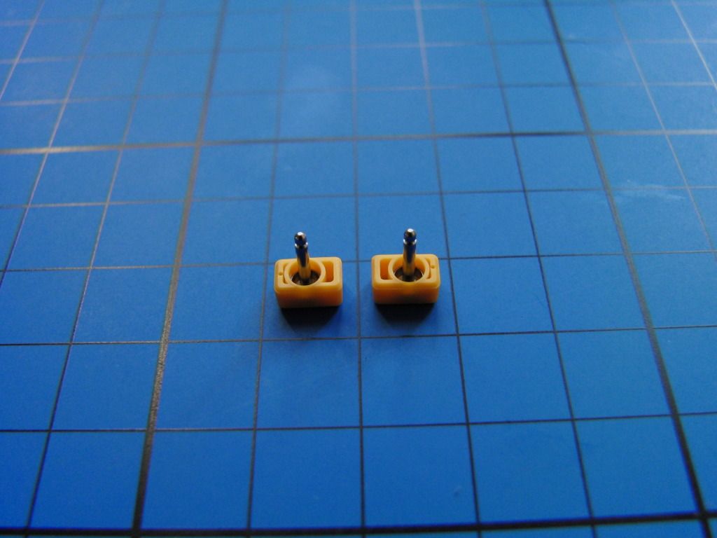

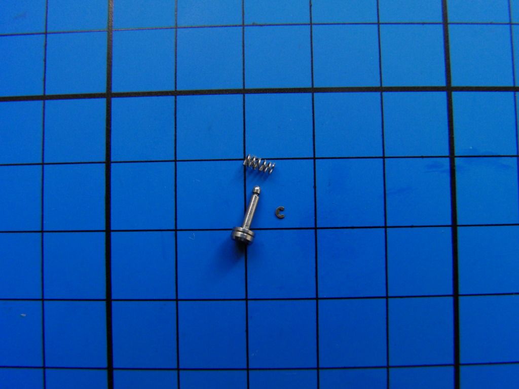

each pusher stem is held in place by one of those pesky c-clips, so out with the c-clip pusher tool:
to give this:
and this:
BTW - you've probably seen this part for sale on ebay, but if you look, you'll see that it doesn't come with the housings for the pusher stem. Without these that part is useless, and I don't know how easy it would be to get them out of an existing block.
Here's a side view of the watch with the pusher block removed:
from this, and the other pictures you can see that the pusher end (where the c-clip is fitted) simply depresses the pusher on the watch itself.
Very simple, but prone to one problem. You can see (if you look carefully) at the pictures of me holding the block, and the pusher, spring and c-clip that the tip of the pusher is slightly bent. This is caused by the pressure of pushing the pusher against the pusher in the watch, at an angle. This and the fact that the tip is weakened by the indentation to hold the c-clip.

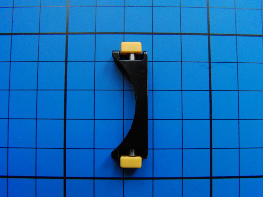

3 of the 4 pushers I replaced were all bent, one badly enough that trying to straighten it (to pull it out) resulted in it snapping off.

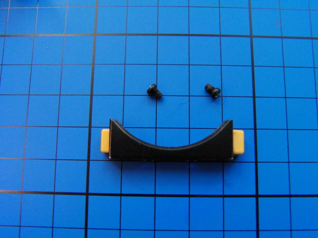

Here's the block with new pushers:
lovely :P
And fitted back to the watch:
and here, on my full watch:
