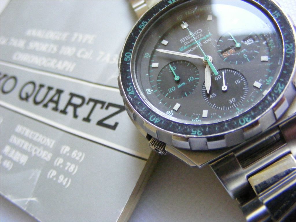

Hidden away on Ebay Germany this week under the title: Herrlicher Seiko Quartz Chronograph Sports 100 TOP Zustand
was this: http://cgi.ebay.co.uk/itm/251103212806
The German seller's description:
Zur Auktion kommen aus einer Sammlungsauflösung einige sehr schöne Uhren zur Versteigerung.
Bei dieser Auktion handelt es sich um einen sehr schönen Seiko Quartz Chronographen Sports 100
Drehbare Lünette
Seiko Edelstahlarmband
Werk: Quartz (gebrauchte Batterie im Werk)
Maße: ca. 40 mm Breite o. Drücker
Zustand: Guterm, eigentlich sehr guter Zustand - wenig getragen
Funktion: alles in Ordnung
roughly translates as:
In this auction it is a very nice Seiko Quartz Chronograph Sports 100
rotating bezel
Seiko Stainless Steel Bracelet
Movement: Quartz (battery used in the factory)
measurements: 40 mm width excluding handles
condition: Guterm actually very good condition - a little worn
function:  all right
The claims that it was 'a little worn' look hard to validate and the key kicker here (as seen in the last picture) was the caseback sticker, implying that it had barely been worn. Super desirable, pretty rare and obviously located by a few fans of the calibre judging by its well realised price of over £370.
Initially, I thought that was very high, but on reflection, one of these is nearly NOS condition? You're getting close to hen's teeth territory. So congrats to the purchaser, a real gem there.

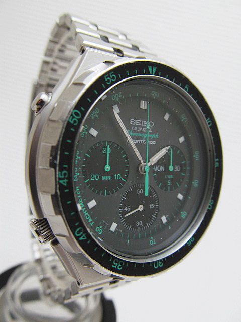

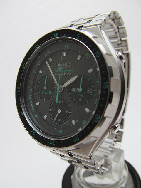

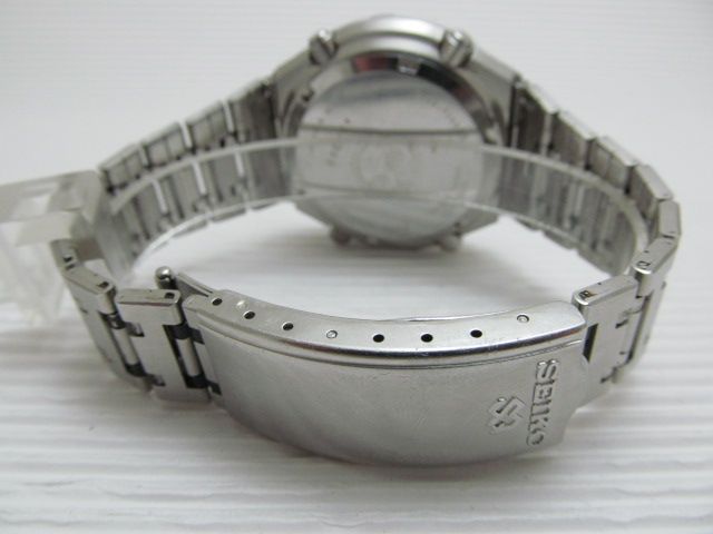

Another 7A38-7050 popped up on eBay Germany, last week. Obviously used, but in rather better original condition than the above:
http://www.ebay.co.uk/itm/181005208727
SEIKO QUARTZ CHRONOGRAPH SPORTS 100 CAL.7A38 EDELSTAHL HAU.BEDINUNG.wohl um1980!
WUNDERSCHÖNE EDELSTAHL QUARTZ SEIKO CHRONOGRAPH SPORTS 100 CAL.7A38 HAU. wohl um1980 !
IM GUTEM GEBRAUCHTEM ZUSTAND ! MIT BEDINUNGSANLEITUNG !
DIE UHR FUNKTIONIERT UND HALTET AUCH DIE ZEIT !
KOMPLETT IN EDELSTAHL
ORIGINAL SEIKO EDELSTAHLBAND
NEUE BATTERIE WURDE MONTIERT !
DURCHMESSER OHNE KRONE:40mm
EDELSTAHLBAND MIT FALTSCHLIEßE
ZIFFERNBLATT ANTHRAZITGRAU
SIEHE BILDER

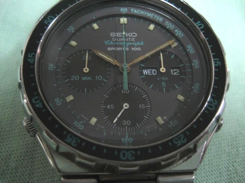

As soon as I started to read it, it looked all too familiar - I remember it well. It has been copied (verbatim) from this listing last year:
http://www.ebay.co.uk/itm/180700487167
Here are 3 of the 6 photos from the original listing (the other 3 are very similar):
If you read this thread on the RLT watch forum: http://www.thewatchforum.co.uk/index.php?showtopic=67544 you'll see that it didn't actually sell first time around (nor second or third, IIRC). That same eBay listing description is also included in a later post of mine.
This 7A38-7050 is in much worse condition than the one discussed in that thread. It is very tired - just look at the hands and bracelet.
Maybe worth $99 (the opening bid) if you fancy a long-term restoration project, but certainly not the Buy-it-Now price of $339 !!!
In case you hadn't noticed the seller's biggest mistake in copying the description verbatim from somebody else's listing ....
Compare the serial number in his photo: 441760 with the quoted 441895 from the original listing description and photo.

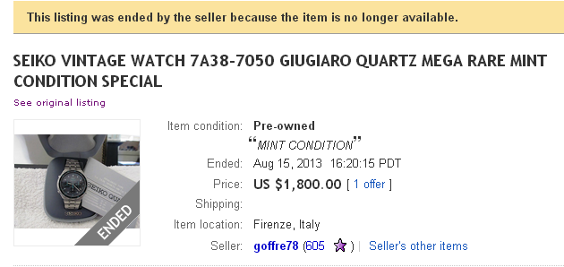

Italian eBay seller Goffre78 - he of the 'Craziest of Crazy Prices' thread notoriety, listed a 7A38-7050 a couple of days ago.
http://www.ebay.co.uk/itm/190885391769
His usual poor quality photos:
Followed by his usual sem-literate multi-lingual description (joke), including the customary: IMPOSIBOL FIND! GOOD LUKE
Although the watch head looked tidy, the bracelet wasn't in 'MINT CONDITION', the small joining links all minus their matt black finish.
The listing wasn't live for long. I missed the coming and going of it and only found it today, while running a search on ended auctions.
Presumably someone must have made him an offer (off eBay) to end the listing early. Let's hope they didn't pay a silly price for it. :/

A 7A38-7050 was listed on eBay overnight by Filipino arch-watch-botcher Ramoncito Bangit a.k.a. eBay seller Badingski.
At first glance it might look better than some of his other offerings, but true to form, it is not all original despite his claims.
http://www.ebay.co.uk/itm/201051705508
Check out the incorrect hour and minute hands he's fitted - compare them with previous examples in this thread.
Because of the mis-match, one must assume the lume in the original hands was as badly degraded as the dial batons. :roll:
Not only is Badingski a more than occasional stranger to the truth, seems he's also a master of understatement.
Note his: CASE BACK : Original,STAINLESS STEEL BACKCASE signed SEIKO LOGO #, SLIGHTLY POLISHED,
More like skimmed to within an inch of its life.

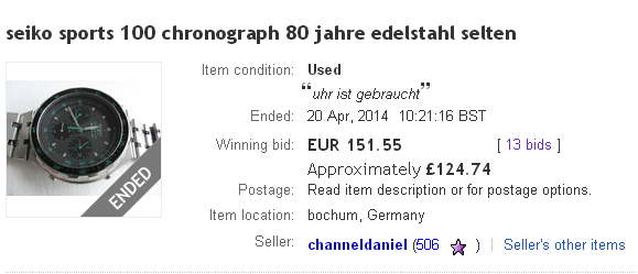

This poorly titled auction listing for a 7A38-7050 on eBay Germany ended about half an hour ago:
http://www.ebay.co.uk/itm/380885572968
Biete einen seiko chronograph gehäuse edelstahl ca 42mm durchmesser schwarzes zifferblatt mit datumsanzeige ,schwarze drehbare lünette mit tachymeterskala ,langes seiko edelstahlband uhr läuft chronofunktion auch ok ,uhr ist gebraucht mit altersbedingten gebrauchtspuren auf dem glas kratzer vorhanden ,siehe bilder.
As you can see from my screen print at the top of this post, with 10 minutes to go, bidding had stalled at only at 56 Euros.
With 10 seconds remaining, it was up to 99 Euros, but I had a pretty good Idea there would be some last second sniping ....
Indeed there was. It finally sold for 151.55 Euros (approx £124.74) after 13 bids: http://www.ebay.co.uk/itm/380885572968
The winning bidder sniped in the last two seconds: http://offer.ebay.co.uk/ws/eBayISAPI.dll?ViewBids&item=380885572968
The winning bidder's abbreviated encrypted eBay ID looks all too familiar - if I'm not mistaken it belongs to a profiteering re-seller.
So I wouldn't be surprised to see this re-listed: properly titled; the asking price typically marked up, in the not-too-distant future.
