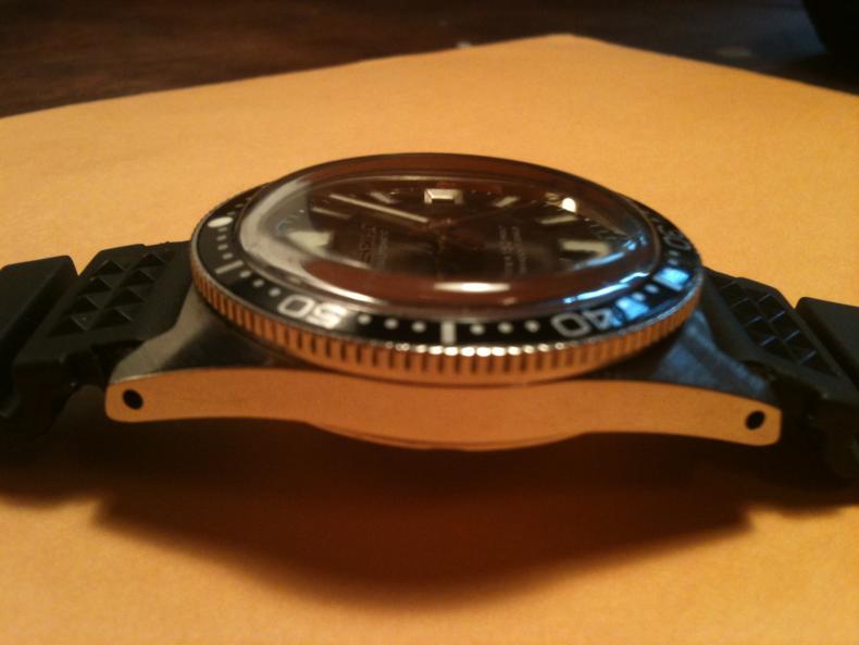

Just wanted to give this thread a quick update on my progress with a viable 7070 replacement insert.
As mentioned previously, i did buy a few different bezel inserts to see what would would be best suited to replace the original one.
As has been seen many times before, the usual 007 insert which has been "cut down" to fit is not to my tatse. I think it looks reasonably ok from a distance, but pretty horrid up close!
I did also purchase an aftermarket 62MAS or 6217 insert to see if this would possibly fit.
As with the 007 insert, the 6217 insert is too large, so it too would need trimmed - it would need trimmed enough as to encroach into the numerals as well. The 6217 insert was also missing the lime pip triangle as well, so this was not to my liking either!
After looking at bezel insert dimensions, i remembered about the Seiko Arnie or H558. The insert dimensions are very close the 7070. I ordered one and it arrived yesterday.
It is not a perfect substitute, as the Arnie insert has a very steep "gradient" in it, as would be correct for the Seiko Arnie model. The insert is also one of thickest i have seen - much thicker than the standard 007 inserts.
So, after some flattening and some extensive sanding to reduce the thickness, it is now fitted to the 7A38-7070.
Perhaps not a perfect replacement option, but one which i think can be achieved with some effort. While it is not 100% accurate to the original 7070 insert, i think this is currently the best replacement option i have found so far.
Here is the watch with the original insert still in place.
And here it is with the modded H558 Arnie insert fitted....
