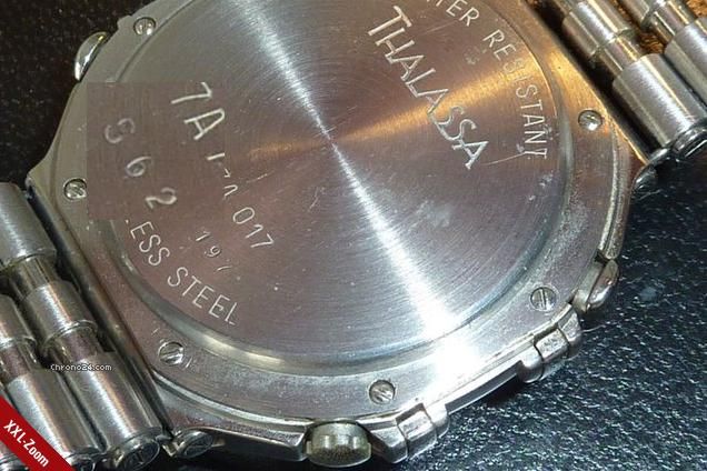

Note the case-back stampings:

Case back #'s 7A74 018
Needless to say, there is no record of a 7A74 caliber on Seiko's database, but then again you won't find Cal. 531, V906, etc. either.

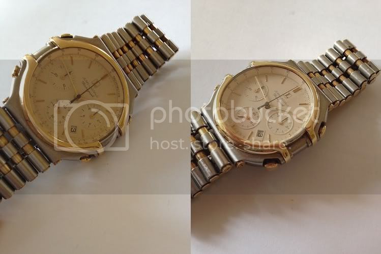

There was one on ebay recently: http://www.ebay.de/itm/280857976820
Only 47 viewers...perhaps the price was too high? :P
Here are some pics:

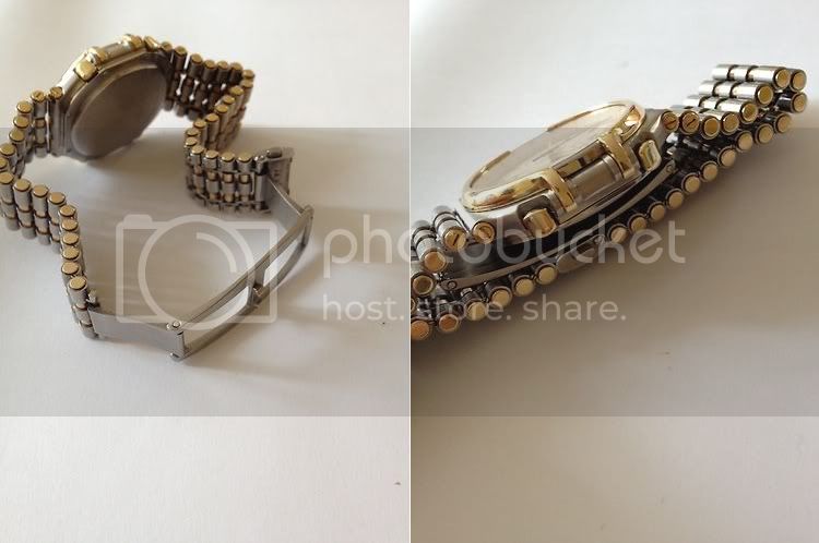

Here’s a few photos from eBay listing # 230774425922 (the one where the seller is away till 3rd May) which demonstrate it nicely:
The bracelets on the non-Swiss versions have a small push-button release catch, with a 'L' logo, operating a butterfly clasp.
Probably best seen in the photos from that eBay Germany auction, now re-listed as item # 270963798559:
The two differing examples offered by Jewelery-N-Loan appear to follow the same pattern: the Cream 'SWISS MADE' 7A74-019:

 I can send you pictures of the inside of the watch with all the markings if you wish.*
*This eBay seller is currently away until 03 May 2012. It goes without saying, when she returns, I shall be taking her up on her offer.
Which indeed I did, actually before 3rd May, and she (not he as I originally wrote), finally came through with, a few days after that. :)
They're different, in that unlike the photos supplied by Mark of Jewelry-N-Loan, they show the 7A74A movement in the watch case.
Though apart  from 'SWISS' on the battery positive terminal plate, most of the other movement stampings are barely discernable:

Two more Jean Lassale Thalassa 7A74's were listed on eBay in the States in the latter part of May, which were both worthy of mention.
http://www.ebay.co.uk/itm/300714942293
Jean Lassale Men's Thalassa Quartz Chronograph Stainless case and bracelet
Model: Thalassa 7A74 017
Serial Number: S62123 on caseback
Style: Thalassa Stainless Steel White Face
This all stainless watch is for the man who prefers not to wear dual tones.
Originally purchased in 1991 the watch has had only one owner and has been worn infrequently.
Will be sent with original zipper case and watch holder, outer box, instruction manual in 5 languages (English, French, German, Italian, Spanish), brief instruction folder, and original certifications (filled in). Zipper case interior shows age. See picture.
Watch crystal and top of bezel have light scratches which are not apparent unless making a close examination.
Watch tested and is in working order. Inside is in like new condition, no staining, new battery.
Opening bid price is $950 (approx. £607.61)
This is another 7A74-017 in all stainless steel - offered at less than half the price of the similar black-dialed version on Chrono24.com.
It's also nice that this particular example comes with all its original boxes and papers. I contacted the seller through eBay, and asked a few questions of her, all of which she very helpfully replied to - and subsequently updated some of her listing information / description.
