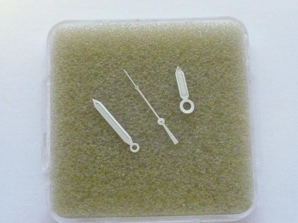

If you've read and digested the foregoing posts then you'll hopefully understand my concerns about having (any) painted hour and minute hands re-lumed - and still retaining the original factory painted finish. One of my own bugbears have been the silver painted hands fitted to early variants of Yema Spationaute III. Like it's sibling, the Yema N8 Flygraf (which uses different 'Mercedes' hands),
the lume compound used seems to be very prone to flaking - so you don't disturb the hands any more than you absolutely need to.
A couple of years ago I'd had a set of the later style Yema polished stainless hands re-lumed (they were completely missing their lume) in 'aged lume' by Steve Taylor, who used to post on RLT and SCWF as 'Clockworks'. They didn't turn out quite the colour I'd hoped for, so I couldn't use them on the watch I wanted to. But that's another story. What I do remember was that Steve steadfastly refused to have a go at re-luming my gash set of silver-painted hands which had come supplied with my Yema Spationaute III 'Mission Flags' dial.
So the fact that I didn't have a decent spare set of silver painted hands has meant I haven't dared risk swapping any hands (at all).
About a month ago, I read a couple of very good recommendations for James Hyman's re-luming capabilities, posted on SCWF.
So I contacted James and asked him if he fancied having a go at my silver-painted set. He said it shouldn't be a major problem.
By then, a lot more of the old flaky lume had fallen out (just by my gently handling them). Here's the photo I sent James at the time:
Note that the original Yema lume on the hour hand had been poorly applied and had overflowed onto the silver paint at the tip.
I didn't get around to posting the hands to James until last Friday. He received them Monday and I got them back this morning.
I'd asked James to re-lume them in a pale cream very slightly aged colour, and if possible as a 'nice to have' the luminescence could be blue (to match the Yema Spationaute III's dial colour). This is one of James's photos he'd emailed me earlier in the week.
Pretty damned good, eh ? :)
