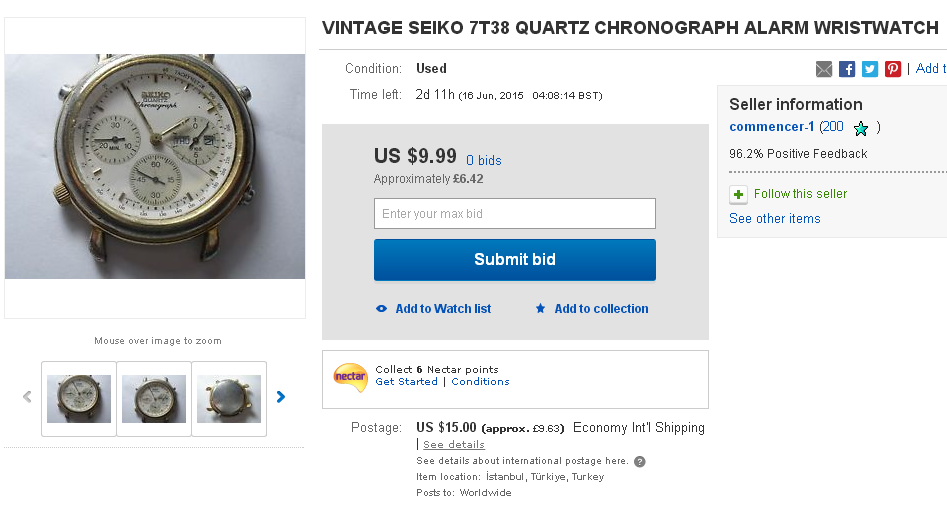

Question: When is a 7A38 not a 7A38 ?
Answer: When (according to the seller) it's a 7T38 - or in reality a Franken: part 7A38(s) and Orient J39. :roll:
I stumbled across the listing for this horrible hotch-potch mess, by a Turkish eBay seller by accident, this afternoon, though from the 88 views the listing has received so far, plently of other people had already seen it - and looked the other way.
http://www.ebay.co.uk/itm/131532337158
VINTAGE SEIKO 7T38 QUARTZ CHRONOGRAPH ALARM WRISTWATCH NOT WORKING
The off-white 723O dial, hands, presumably movement and crown are from a two-tone 7A38-7270. The well worn gold-plated case and chipped Tachymeter dial ring are from an Orient J39908-70 - topped off with the case-back off a two-tone 7A38-7060. Pushers could be off any of the three (but stripped of their gold plating) and going by the differing amounts by which they protrude - probably are !

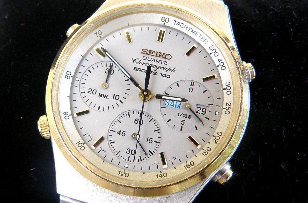

At the risk of repeating myself, for the nth time, before anybody else does :P ....
I've always said that subtle Frankens are the best (particulary if they look like something Seiko themselves might have made).
Here's a very subtle one, listed earlier this evening by a German eBay seller, that's almost bound to catch someone unawares.
http://www.ebay.co.uk/itm/391580631326
Schöne und Seltene Seiko Chronograph, Day-Date, Japan made.
Modellnr.: 7A38-7020 5A
Die Uhr ist in einem guten Zustand.
Das Uhrenband wurde gereinigt, es hat die originale Länge und
passt für einen Handgelenksumfang bis 21,5 cm.
Die Batterie ist neu.
Bitte lesen Sie den Hinweis, Bevor Sie Ihr Gebot abgeben!
The first clue as to what's wrong and what it's comprised of is the SPORTS 100 logo on the dial (which none of this particular case model have) and 7A38-7020 in the seller's description - which confirms it. The watch case and matching p/n B1615C bracelet are from either a two-tone 7A38-7270, or more likely the equivalent 7A38-727A, which only seems to crop up in Germany and would also provide the correct silvery-grey Tachymeter dial ring. The light grey 703L dial, hands, movement and presumably also the case-back (not shown) are from a two-tone 7A38-7020.
Here's a where that light grey 703L dial would normally reside - in a two-tone 7A38-7020 ....
Unfortunately, I don't appear to have a wrist shot on file of my two-tone 7A38-727A, but it's the watch on the right of this old photo.
Like I said - it's very subtle, innit ? ;)
