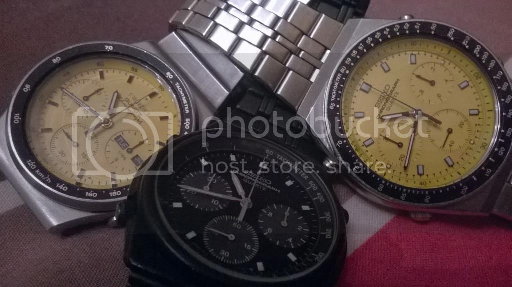

Having recently bought a weewatch special from USA for my newly aquired Vulcan, I wasn't happy with the finish as it was too shiny and just looked too new so I set about it with my wet "n" dry and also my fibreglass pen. These are the results, I have included my 7a28 just to show the contrast now I have dulled it up.
That bezel insert has been touched up though would never believe it off this photo but the bracelet is a pretty good match now here's the contrast
It is now wearable and does not pinch the hairs on your wrist.
