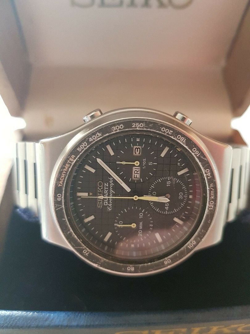

This well-worn 7A38-701A, fitted with a non-original replacement Seiko bracelet, was listed earlier this evening, by a German eBay seller, as a 7-day auction, with an opening bid price of 1 Euro. Not the best of examples; the dial batons and smaller hour marks have been re-lumed. The suitably well-worn stainless bracelet is a Seiko p/n C163, presumably off some 1970's digital. I'm sure it will sell, regardless.
http://www.ebay.co.uk/itm/113945714580
Seiko 7A38-701A Quartz Chronograph. Zustand: Gebraucht, siehe Fotos.
Datum in deutsch/englisch schaltet sauber.
Drücker gehen butterweich und Chronograph nullt perfekt. War letztes Jahr bei einem Seikospezialisten vom Uhrforum beim Service, Glas ist neu.
Band ist leider nicht das Originale, aber ein ähnliches von Seiko aus der Zeit.
Laut Seriennummer ist die 7A38 vom Oktober '83.

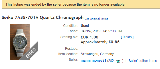

I can't say that I'd been watching it that closely, but the last time I'd looked at the above German eBay auction for a well-worn 7A38-701A, fitted with a non-original replacement bracelet, the bidding had reached somewhere around 25 Euros. Yesterday afternoon, the German eBay seller ended the listing early, cancelling all 5 bids in the process (checking the bidding history, the high bidder's maximum bid was 50 Euros). Presumably sold off eBay for a back door offer. :/

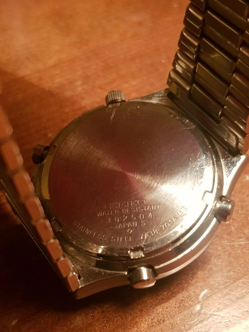

Another well-worn 7A38-701A, fitted with an incorrect replacement Seiko bracelet (a p/n Z167) was listed yesterday evening, by a Swiss eBay seller, as a 10-day auction with an opening bid price of $1. As clearly stated by the seller in his description, it's also fitted with the wrong case-back off a gold-tone 7A38-728A. Which begs the question why the seller went to the trouble of obscuring the serial number. :roll:
http://www.ebay.co.uk/itm/153721429243
Rare Vintage Seiko 7a38-701A
Beautiful cross-hatched dial (a real eyecatcher)
Time, Chrono, Reset all working perfect
See picture for details and condition
>>>Wrong Caseback. From a 7a38-728A (fits perfect)
Follow me.
Will add more Seiko Vintage pieces, soon.
Thanks
Private seller.

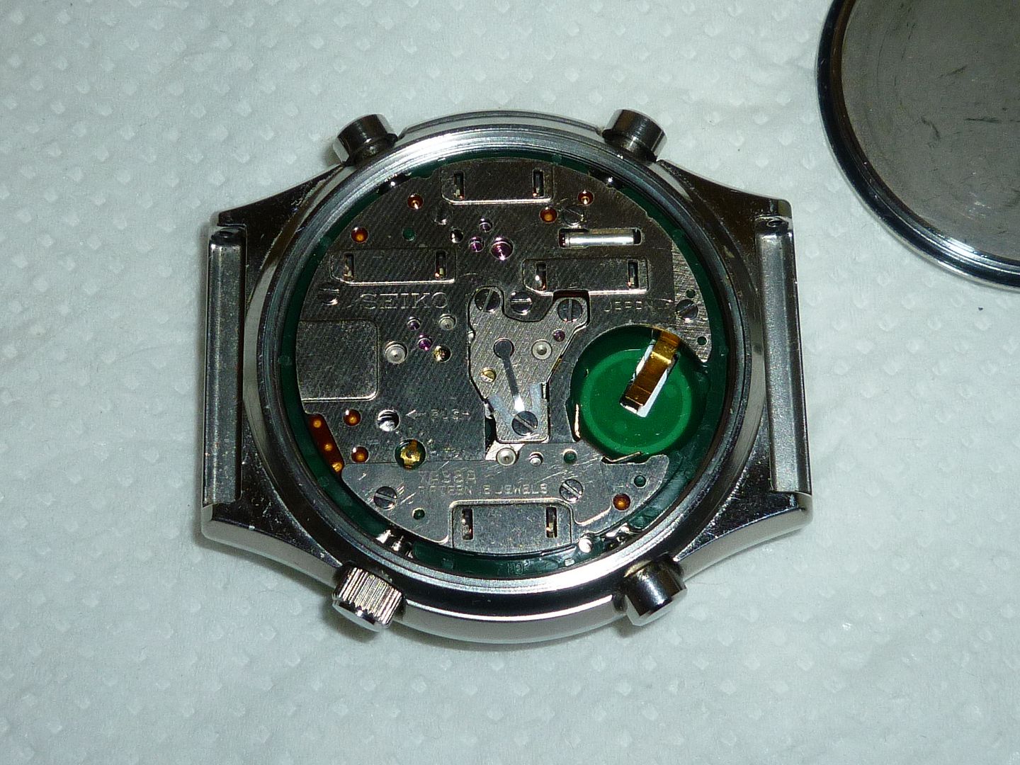

As some readers may have guessed, I was the winning bidder of that UK eBay auction for a non-working 7A38-701A. I ended up paying rather more for it than I'd originally planned, but I'd made my mind up that it was about time I bought myself a better example. I collected the package from the local Royal Mail sorting office depot yesterday morning. Initial impressions are favourable - it's in very good well-cared-for cosmetic condition, with only one tiny mark on the bezel inlay and another on the crystal. There are a few very light scuffs on the 12 o'clock side of the bracelet and the clasp. It's pretty much all-original too - apart from someone having replaced the original 16mm short bead springbar in the clasp with a normal 'double shoulder' type. I haven't counted them up, but it appears to have its full original complement of bracelet adjustment links, too. Here's an exactly 'as received' photo I took earlier this morning. Obviously it needs a good clean.
This morning I decided to investigate why it wasn't working. I unscrewed the case-back and popped a new battery in (it came without one), just to see if there were actually any signs of life. It was completely dead. Well almost. Pressing any of the chronograph pushers (with the crown in any of the 3 positions) made the hour hand twitch. An indication of a fairly serious internal short. The movement's anti-magnetic back-plate looked pretty clean (what I'd misconstrued as discolouration in the eBay seller's photo must have been shadow).
However, it was a portent of what I'd expected to find once I started stripping it down. Note the electolytic deposits on the underside of the anti-magnetic back-plate, in the area of the battery negative contact. If you zoom in on the photo, below, there's also some wetness around the battery recess on the back of the PCB.
I gingerly removed the PCB to find more or less what I expected - to a lesser extent. The gold-plated battery negative contact is badly corroded and the track leading from it is almost completely eaten through. I've seen many (much worse) battery acid damaged PCB's in my time, but unfortunately that's all it takes to kill one. :(
There was more wetness (leaked battery fluids) on top of the green plastic '710' insulator spacer (not particulary visible in the next photo). Note also the tarnishing / deposits on the PCB contact area of the negative battery contact.
I decided to withdraw the '710' spacer, just to check underneath. Difficult to see in this photo, but again there's some wetness on the underside of the battery well.
Thankfully the movement underneath is almost squeaky clean. :)
At which point, my camera's battery ran out, so I'm going to finish the clean-up operation while it's on charge.
March 5, 2020 at 6:28 AM Flag Quote & Reply
Movement now cleaned up and reassembled with a new replacement PCB. :)
Almost everything works. :) Initially, the sweep second hand didn't move at all (as you'd expect it to, after replacing the battery). I was considering replacing the coil, but then instead, I popped the movement out and gave the sweep second hand a couple of nudges with the point of a wooden cocktail stick. It nearly managed one complete rotation on its own. It's still a tad recalcitrant and tends to stick, rocking back and forward between the 4 and 5 marks (where I've left it, for now). I'm hoping with a bit of exercise, it may right itself. Next step is to properly strip and clean the watch case and grease the pushers.

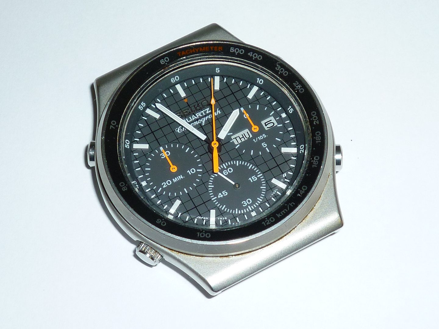

I reassembled the watch this morning and took these two photos using flash.
Since then, I've been struggling to take a decent wrist shot, which shows the true dial, hand and Tachymeter lettering colours, without getting reflections in the crystal. Not an easy task, believe me. :roll: Here's a few of my earlier efforts:
I've posted a couple of slightly better ones in the WRUW thread.
