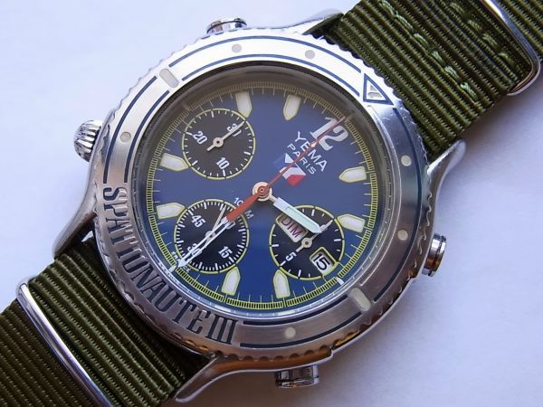

My latest quandary concerns the rather-less-common all stainless blue-dialed 38mm 'reduced' Yema Spationaute III model # N80A66.
I'd bought this watch (as a split deal with someone else) on MWR back in September 2010, as sort of a long-term restoration project.
I paid $75 for it (not $150). ;) It had already been messed around with and needed quite a bit of TLC to make it half presentable.
The biggest issues for me were the missing original screw-down crown (my tribulations written up in a thread on RLT) and hands lume.
The bezel was quite scuffed, but because all the painted inlays were intact, it never occurred to me before to try removing the bezel.
Here's how this watch has looked for the last 3 years of so:
But then more recently this watch has developed a serious time-keeping problem. It first started losing time, perhaps 10-20 minutes per night, but now frequently stops at 12:55, during the day / date changeover. I say 'stops', but in fact what happens is the hour and minute hands cease to advance, but the constant seconds hand carries on merrily ticking away. I suspect a slipping cannon pinion. :/

Because the watch case of my original ex-MWR watch was marginally better than the recent ex-YJ example, my plan was to remove that one's bezel, re-paint the missing inlays (easier to do with the bezel removed) and swap them over. Knowing what lay underneath (from the ex-eBay parts watch), there was absolutely no way I was going to insert a case knife (or anything else) into the gap between the bezel and case. As the ex-YJ example had a slightly bigger gap, I decided to tackle that one first. I simply held it in my hands and pulled the bezel off with my fingernails:
Again the teeth of the bezel component have left an impression in the track. You can just see a couple of the moulded plastic detents.
The bezel came off exactly as it should, complete with it's plastic ratchet teeth insert still in place. :)
As that one came off relatively easily, full of renewed bravado, I tried the same 'fingernail' technique on my original (ex-MWR) watch:
This time the bezel's moulded plastic insert stayed fixed to the watch case !! :mad:
Knowing how fragile these mouldings are, there's no way that I'm going to try prying it off. I just hope I can get both bezels back on. :/
The moral of the story being: if you buy a 38mm 'reduced' Yema Stationaute III and the rotating bezel turns OK - leave well alone ! :roll:
