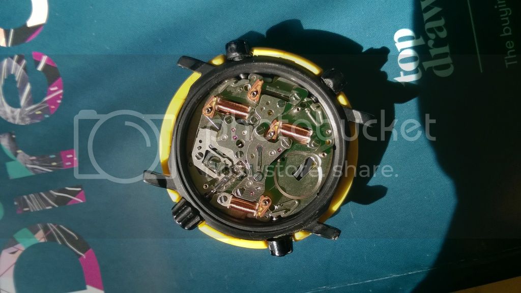

As now I have a 7A36 movement in hand I'm brave enough to reply here :)
Let me share couple of pics which will be self explanatory:
Interestingly the 7A36 has only 9 jewels. The complete 1/10 second assembly is missing.

Interesting indeed Arpad.
There must be more than just the 1/10s chrono' bridge omitted for the 7A36A movement to have 6 less jewels than all other 7Axx's.
I was wondering if it might possibly use a cut-down main train wheel bridge and was planning to do a comparison between the 7A36 and 7A38(A)'s bills of materials / parts lists. Unfortuately there's no data for the 7A36A movement on Seiko Oceania's database. :(

Ever interested how the 7A36 movement looks closer? :P
After almost a year I had time to take some photos about the movement.
