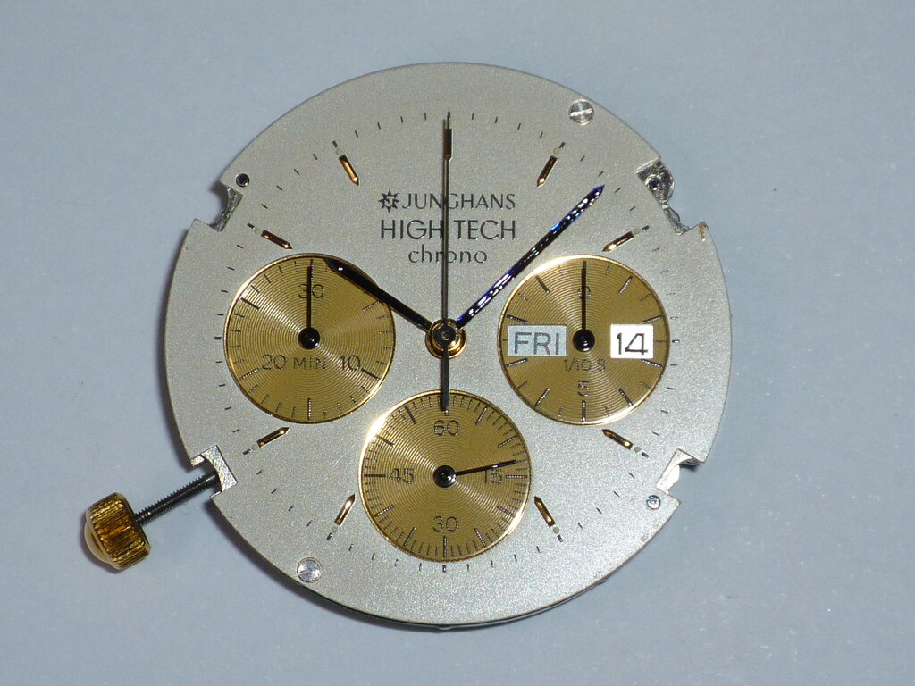

The Junghans 24/4610 High Tech Chrono is, to the best of my knowledge, the only re-branded 'Seiko 7A38' produced by a German manufacturer. It uses a generic unbranded version of the movement, (save for V906A printed on the battery positive plate), similar to the C.G.H. Shimauchi Ltd. V906 (used in Yema N8, etc.) and Cartier Ferrari Formula Cal.531, but fitted with an English / German (EG) day star wheel.
Other than the movement, the watch appears to be comprised of Junghans proprietary components. The watch case measures approx. 39mm diameter and a 19mm wide bracelet, with hidden butterfly clasp, is attached to a 14mm lug width fitting. The watch is coated in a silver anodized finish, with a gold plated (brass) decorative bezel ring. Other than that, only the crown is gold plated. The pushers are of the screw-in splined type, with double O-ring seals. The watch case construction employs plastic gaskets, giving it a questionable claimed water resistance of 50 metres.
Being a slightly quirky design in two-tone finish, they're something of an acquired taste and despite coming from a once hallowed German watch manufacturer, not a particularly popular choice among collectors of non-Seiko branded 7A38s. I've never been averse to two-tones myself and quite like them, personally. Here's an old wrist shot of one of mine, that I posted on the first page of the old forum's WRUW thread.
Thing is, other than posting the odd wrist shot and criticising one particular deceptively described example (fitted with a non-original bracelet) in the 'Wrong Un's thread, I can't remember writing very much about them on the old forum. My omission, which I intend to rectify here, is probably due the fact, that prior to starting the Webs forum in January 2012, I'd already written about them, at some length, in a thread on the UK RLT watch forum towards the end of 2011, here:
Junghans High Tech - Yet Another Non-Seiko 7A38
Unfortunately, due to the manner of my departure from RLT, virtually all the embedded (PhotoBucket hosted) images have been removed from my posts. :x That said, there's still a wealth of information in the text, for anyone interested. I also included a short potted history of Junghans Uhren GmbH. Here are a couple of pertinent quotes from that post:
Back in the 1990's and early 2000's Junghans entered into 'master joint development agreements' with Seiko Epson Corp. These agreements covered the joint development of Junghans 'Mega' range of radio-controlled and solar-powered watches. It would seem from Junghans' use of Seiko 7A38 movements in their 'High Tech Chrono', there was also earlier collaboration.
Bearing in mind that Junghans were developing their Mega 1 (the World's first radio-controlled watch) at the time, I still can't fathom what could possibly have possessed their marketing department to call this watch the HIGH TECH chrono. It's a complete misnomer and utter travesty ! :roll: These watches were presumably manufactured in late 1987 or 1988, when Seiko had already been producing their own 7A38's for nearly 5 years. Hence my deliberately facetious title suffix: Rückwärts Nicht Technik. If the movements had been supplied to Junghans as part of any fledgling technology sharing agreement, I'd opine that they got the short end of the stick ! :lol:
That said, it seems to have been a fairly short-lived arrangement. I was browsing Junghans archives, to learn whether there might possibly have been another dial colour variant (there wasn't). I found the illustration below on page 17 of their 1989 catalogue. Please excuse the quality, but their .pdf scans are fairly low resolution. The smaller image of the watch in the 1988 catalogue is even poorer quality. If you view the full page scan of the 1989 catalogue, you'll see that on the same page there are also 3 versions of a rather more attractive-looking Junghans quartz chronograph, powered by the Citizen Cal. 3530 movement: 024/3805.44, 024/3806.44 and 024/3807.44. They're still shown as available in the 1990 catalogue, since joined by another Citizen 3510 powered chronograph (with alarm and date), model 024/3900.00. But no sign of the unloved 24/4610 High Tech Chrono, by then consigned to the pages of history. :cry:
Note that the full catalogue number is 024/4610.44 (that '44' suffix was what made me wonder whether there might be another variant) - same as printed on the paper hang tag in a current eBay listing in a subsequent post. That also shows a retail price of 990 DM (equivalent to approx. 500 Euros). Whereas the watch's case-backs are only stamped 24/4610.
Note that there is no manufacturing serial number - so no means of telling how many were produced. The case-back is a press fit (from memory, the only 7A38 not to have a screw-down threaded case-back) - hence the flat at the bottom, to facilitate insertion of a blade for removal. The case-back is sealed and retained using a hard red plastic (Sanfil) gasket similar to these offered by Cousins UK - visible in my first photo in this post.

rsz_junghans-24-4610-hightechchrono-stainless-gold-creamface-headonly-ebay-may2022-9.jpg
rsz_junghans-24-4610-hightechchrono-stainless-gold-creamface-headonly-ebay-may2022-9.jpg (241.26 KiB) Viewed 225141 times
Judging by the staining on the movement back-plate (and the positive battery plate, which is missing its 'ears'), it appears to have suffered a localized but fairly catastrophic battery leak, so I suspect the PCB will be toast.
*That's rather more than I paid for my grubby but complete example last April.
