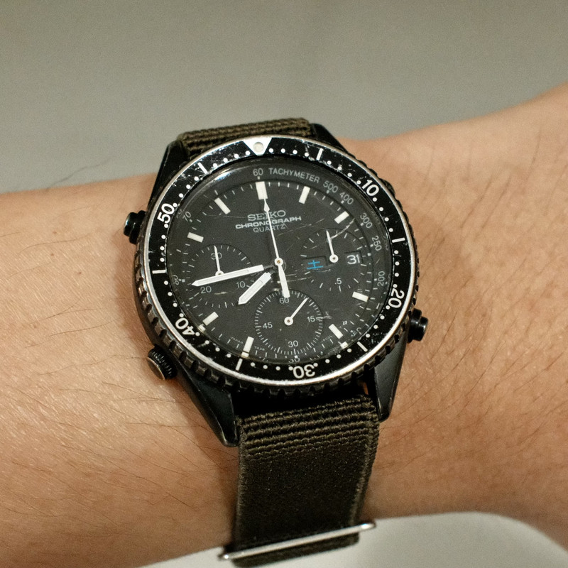

Finally it's here, very glad how this one turned out. It is much better than I expected. The start button is a little stiff but I plan to do a full service anyway. The crystal is a bit too scratch up, is there a place where I can find high quality replacement crystal? Doesn't have to be original, anything with correct specs and high quality would do. Or how would you polish the crystal in this case?
Re: Seiko 7A38-60xx water resistant?

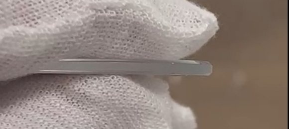

The Seiko part number for the crystal is 285W26GN00. They are virtually unobtainium. The last time I saw one listed on eBay was in December 2020, where the greedy Italian seller was asking €119 Euros. It eventually sold in November 2022 for €99 Euros. The original crystal measures 28.5 mm Ø X 1.8 mm thick, with a polished bevel edge, which is necessary to clear the underside of the bezel insert. Luckily for you, I managed to persuade a UK eBay seller to produce a quality reproduction crystal. He had a batch made in May 2024 and I expect he's got some left. His name is Bryan Hibbins. His eBay ID was togman, but he changed it to something longer, which I can't remember at the moment. I've sent him a PM on SCWF. Here's a small photo he sent me, at the time, showing the two bevelled edges.
Personally I wouldn't attempt to try and polish a Seiko Hardlex crystal. It can be done professionally, at a cost, but it's much easier to replace it.

Thanks for the lead! The seller is tog_man_precision_watch_supplies, and he has some in stock but unlisted. I’ll grab one, and while it is shipping I’ll let the watchmaker here to give a try on polishing the original glass
That's the one ! ;) He's just re-listed them: https://www.ebay.co.uk/itm/257339593193
You do realize that you need to pull the bezel to remove the crystal ? I wouldn't recommend attempting to polish it in situ, thereby putting the bezel insert at risk of further damage.

Yes and yes. I ordered the crystal just in case. Not sure how difficult to remove the bezel, or just the insert removed is enough to get the crystal out. My main concern is with the black coating layer
The bezel is retained by a rubber O-ring, running in a groove. They can be levered off using a case knife. The bezel insert is thin aluminium and easily bent.
