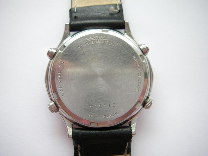

Thank you for your substantive reply. Clearly, I do not know my left from my right! The missing pusher is at twenty past the hour.
The watch is indeed stainless steel. In fact I found my watch mentioned in your forum. I acquired it in 2013 for £70 and worn it most days since. It has never missed a beat. The number is 777112.
Thanks again all the best,
David
Re: Advice please replace pusher, spring and gasket
Posted: Tue Jul 22, 2025 5:37 pm
by Seiko7A38
bigdave wrote: Tue Jul 22, 2025 5:20 pmThe watch is indeed stainless steel. In fact I found my watch mentioned in your forum. I acquired it in 2013 for £70 and worn it most days since. It has never missed a beat. The number is 777112.
I can't say I remember it well Dave. Maybe I mentioned it in the old archived forum's 7A38-7260 SAA097J model thread.*
I did however find photos on file of a stainless 7A38-7270 serial # 777112 from an eBay listing in October 2011.
*Indeed your watch is mentioned three times on the first page of that thread. ;) Sold again on eBay UK in August 2013.
