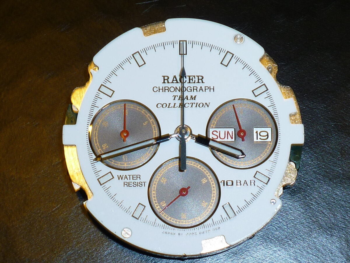

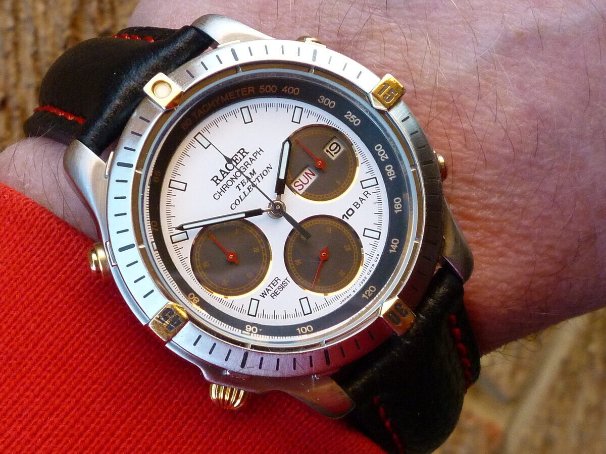

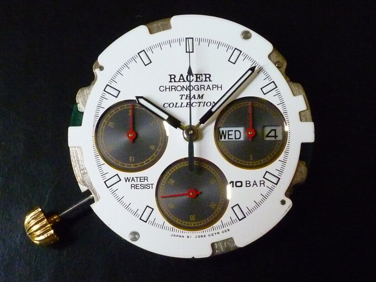

I wrote that because I remembered having to do it myself once, many years ago. I bought a Racer J39027-70 off eBay Germany in November 2013. It needed a little TLC / good cleaning and restoration. The worst part was the was badly scratched crystal, but when I withdrew the dial / movement, I found the tip of the sweep second hand was slightly bent. I massaged it back into alignment, in situ, between two pieces of pegwood. I thought I'd posted these photos in the Racer 'Spanish 7A38 Inquisition' thread, on the old forum, but I couldn't find them. So here they are, belatedly ....
