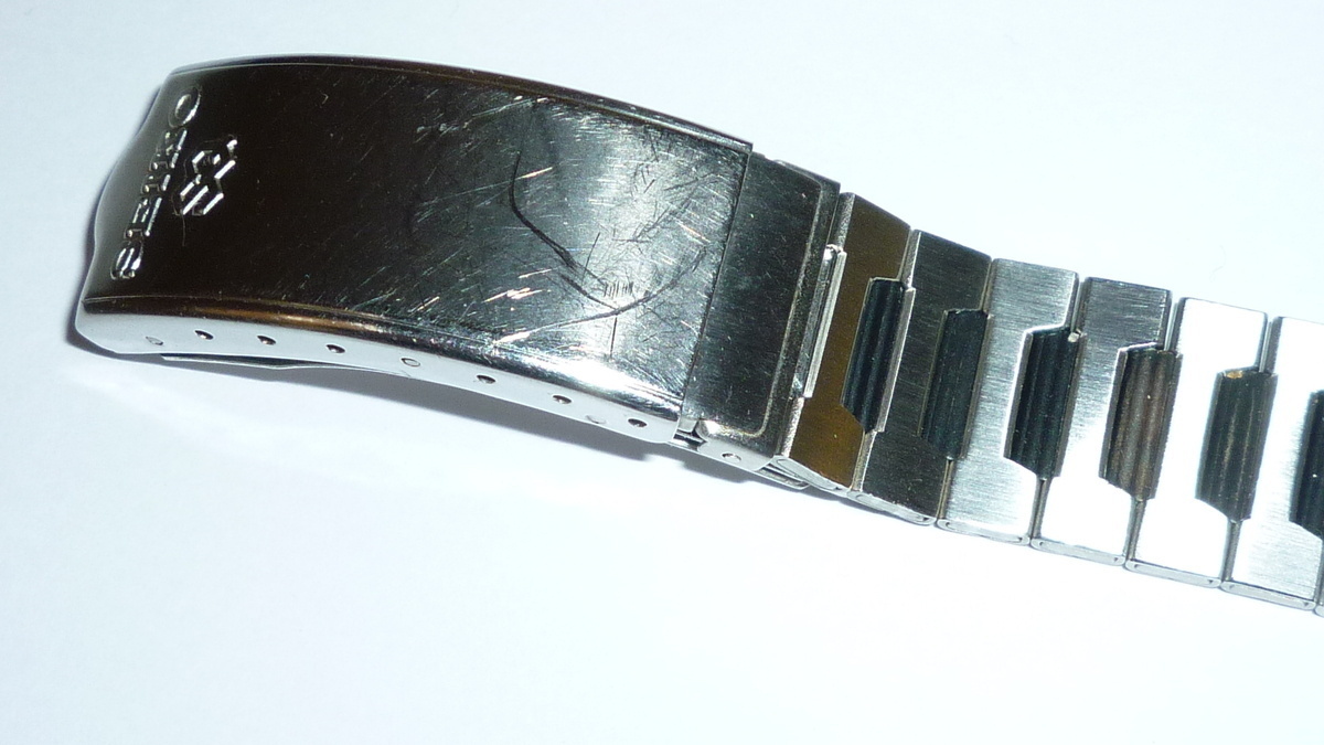

So to get it to fit your 21cm wrist comfortably, you need one (minimum) or possibly two (for Summer) adjustment links. Rather than go cap in hand to the likes of Giuseppe, there is another somewhat cheaper, more comfortable solution.
That would be to fit a 16mm spring-loaded clasp extender, like this: https://www.ebay.co.uk/itm/381466444753
I've used them to good effect on a few of my 7A38's whose bracelets were short of adjustment links, including, as it happens, on my 'beater' stainless 7A38-7000, a.k.a. 'El Caracortada'.
Simply fitting it (in that position) automatically adds almost the depth of one adjustment link, in the resting position.
Here's how it looks fitted to 'El Caracortada':Seiko7A38 wrote: ↑Tue Aug 24, 2021 10:28 am
I gave it the nickname 'El Caracortada' (Latin American for 'Scarface') as a nod to the eponymously titled 1983 f-rated movie starring Al Pacino and obviously the scabby scarred dial. It joined the roster of my regular everyday beaters and was particularly comfy to wear, because I'd fitted a spring-loaded clasp extender to the slightly too short bracelet (which really needed one more adjustment link).
Personally, I don't think it looks that ugly or obtrusive when fitted as deeply into the clasp as possible (as mine is).

The clasp extender was actually my first idea. I have used these things on a few others of my watches, including a vintage Omega Speedmaster, in the past and they work reasonably well.

There seem to be some minor variations in manufacturing tolerances with these clasp extenders. I fitted yours on the same 4th pair of adjustment holes as I'd done with my 'El Caracortada's similar extender, but it protruded slightly more from underneath the SQ clasp cover (by only a millimeter or so).
Which is probably just as well, because as the saying goes: 'every little helps' - to give you your required 21cm.
