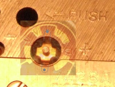

Michael Rothe's post #17 originally included a number photos, illustrating the switch function in considerable detail, but sadly they've long since disappeared into the ether, along with all the photos from that thread. Here's one such I saved from it, back in the day. I'm not entirely sure where they all fit in relation, but this image likely goes with the caption:
Here is an overlay picture of the adjustment markings and the contact pattern on the circuit block:
Or it could possibly be an edited version of the same image from Michael's post #20:
I tried to make a see-through picture with the markings, the contact pattern and the rotor.
It didn't come out very pretty (I'm an engineer, not a graphics designer!), but one can see how it works:
