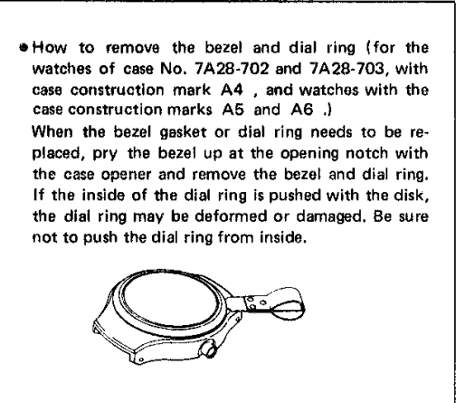

I'm servicing a 7A28 black Bond for the first time. Not a expert at all but it's for fun and learning.
I removed the crystal but have no clue how to remove the tachymeter ring under the crystal.

NakkDry wrote: Mon Aug 09, 2021 5:02 pmI removed the crystal but have no clue how to remove the tachymeter ring under the crystal.
You may find this helpful: https://seiko7a38.com/archive/i/seiko/d ... /7A28A.pdf See page 3 of the Technical Guide.
Generally, but not in all 7Axx cases, the Tachymeter ring is sandwiched (but can still float, rotationally) between the bezel and the case. Be VERY careful with the nylon gasket between the case and bezel.

I already downloaded this really useful guide but it doesn't have tips to remove the ring under the glass.
Yes, it is sandwiched. I got no nylon gasket. :?

Thought wasn't for me because this model has no bezel. Ok thanks I'll try. :oops:
Re: Help servicing 7A28
Hint: Assuming it hasn't previously been removed and replaced in a different orientation, the thumbnail shaped notch for inserting a case knife is normally to be found near the top L.H. lug. Before attempting to insert the blade, protect the lug with some tape, like this (obviously having first removed the dial / movement - that old photo was purely for demonstration purposes):

Ok done it. Thank you!
