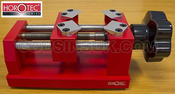

It's not complicated, Dave. All you need to remove the bezel from your 7A28-7040 is one of these - and a bit of courage.
Some Seiko 7Axx rotating bezels, like that of the 7A38-6020 are a bit tougher to remove than others (understatement). I've just invested in one of these Horotec Bezel Removal Tools. (For the reasons why, see this thread on the old forum).
