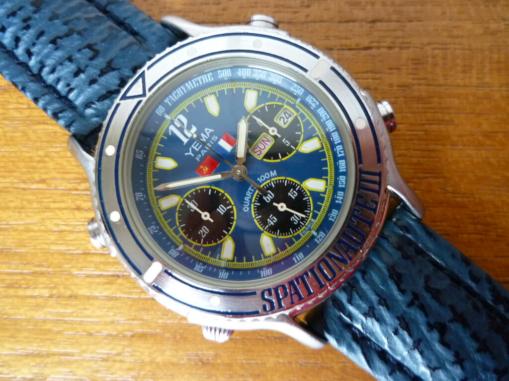

Hi Everyone. I've recently acquired two Yema N8 (7A38) models. First being the Spationaute III Aragatz space mission model with a badly scratched crystal and I'm wondering if anyone has suggestions on replacement crystal and the appropriate gasket that would go along with this model?

Looking at the photo of your Spationaute III, which you consider has a 'badly scratched crystal', all I can see in the way of significant damage is a small graze above the '0' on the 1/10s sub-dial. I have a couple of 'beater' Spationaute III's with scratched crystals (that I haven't replaced) which are much worse than that. I'll post one in the WRUW thread presently. It's possible with a little effort to polish out lighter scuffs and scratches (not deeper ones) and I'd suggest that's something you might want to consider trying first, before replacing your crystal with any generic substitute.

Here's a slightly different photo, to the one I just posted in the WRUW thread, of one of my two Yema Spationaute III's with the 'cadran drapeaux' mission flags dial, that are currently fitted with the generic Cousins p/n DF250CMH305 flat bottomed mineral glass replacement crystal. One thing I've noticed with them is that they're more prone to picking up reflections. Check out just over 'TACHYMETRE'. The photo below was taken just seconds after the one I posted in the WRUW thread (without any reflection); no change in lighting or cloud cover. All it took was a slight twist of my wrist - by matter of a couple of degrees.
Speaking of the 'Angle of Dangle', the problem of distortion caused by using that flat-bottomed crystal, which I possibly demonstrated in extremis in the old forum's Crystal and Gaskets thread (incidentally using this same watch), isn't really that bad. Not in everyday in real world use. In this next shot, I've tried to show the point at which the distortion starts to creep in. Do you ever try reading your watch beyond this angle ?
