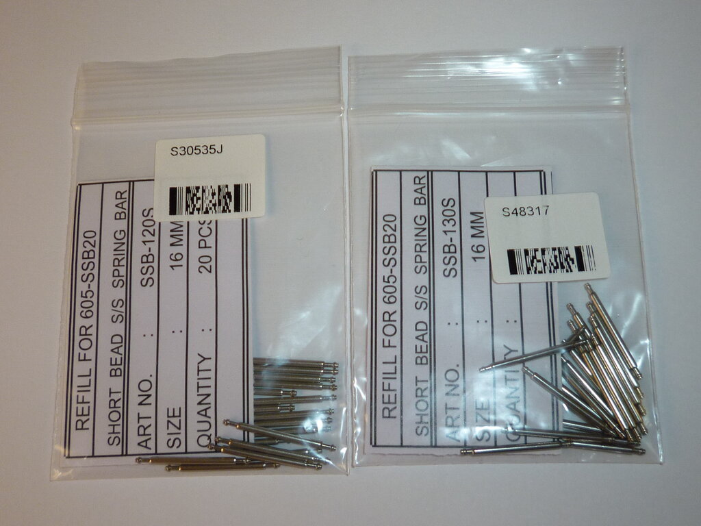

I was going to offer to send you a short bead spring bar, but to my surprise, when I checked my spring bar box I didn't have any - and it looks like I'd never bought any before. :oops: All I had (in 16mm length, with short bead) were 1.5mm Ø diameter - as used to attach the end (12 o'clock side) of the bracelet to the clasp.
So I tacked a packet of each onto my Cousins UK order, which arrived this morning.
So if you haven't sorted it, email me your address and I'll stick one of each in the post to you. ;)

Unfortunately, I actually ordered exactly the same pair, one bag of 1.3 mm and one of 1.2 mm diameter short bead bars... However, neither fit properly. In each case, the spring section was too narrow and still stuck out through the hole in the side of the clasp.
I also couldn't find the original clasp with the solid bar in it. I did find another Seiko clasp which I think is from the same era, but the equivalent bar in it (not sure if it was original) was too thick, possibly 1.5 mm. Now I'm not really sure what to do besides trying to get hold of a whole new clasp.

Yesterday I tried both Cousins' 1.2mm Ø and 1.3mm Ø 16mm short bead spring bars in a loose spare SQ clasp cover. Both worked fine for me, though it has to be said, the shoulder flanges on the 1.3's are not particularly well defined. So are the pivot holes in your clasp cover enlarged slightly (by wear) ?
