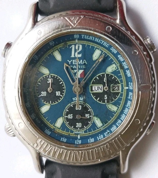

Beware. Seller is currently offering this Yema Spationaute III as a working watch even though the photo shows a movement that is missing a component. Listed as eBay item # 297463762728. Seller’s name is Khavaloz.

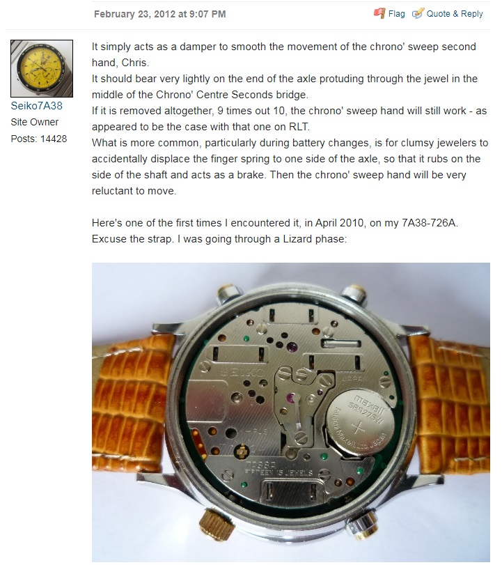

James. I assume the missing component you're referring to is the chronograph centre seconds finger tension spring (which has been broken off). In fact, in most cases the absence of this part does not prevent the watch from working. It's when it has been clumsily deflected to one side, and rubs on the shaft, that it causes problems. As I stated in the original thread in the Tech Tips section:
Re: Beware this Spationaute III on eBay
That said, displaced, bent, mangled or missing finger tension springs are a good indication that a 7A has been handled by a clumsy botcher. Personally I would avoid this Yema Spationaute III (and its seller), like the plague, for other more obvious reasons. Just take a good look at the state of the dial and hands for starters ! :(
The watch was first listed on 1st July, fitted with a different strap, as eBay item # 297444491980. At that time the painted bezel inlays had been completely stripped. It looks like he's since had a go at re-painting them - hence the different set of photos. I had to chuckle at his claim in the description:
it is more beautiful when you see it directly than in the picture
