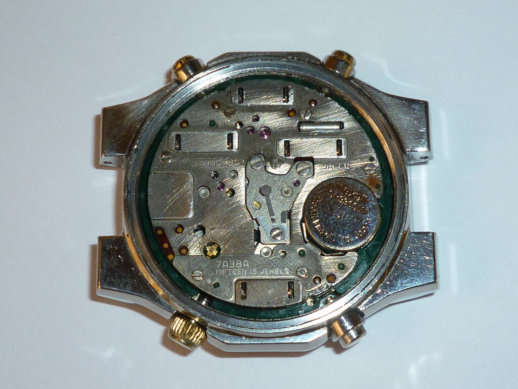

I've only bothered uploading 4 of his 11 listing photos, but that should suffice. Badingski has always liberally misused the word 'original', regardless of the watch's true condition. So where shall we start ? :P All traces of the worn gold plating have been removed from the bezel, crown, pushers and the bracelet's centre links. The supposedly 'good condition' dial has evidently suffered some catastrophic water damage. The bracelet's first joining links have been stretched open and he hasn't bothered to pinch them up. The pièce de résistance has to be that battery acid ravaged movement back-plate.

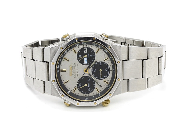

For anyone who's in doubt as to how a two-tone 7A38-7289 SAA110J should look, here's a photo from an old eBay listing:

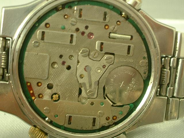

Nowadays, I may freely dish out the salutary warnings to avoid Filipino watch-botchers like badingski, but truth is that when I was an inexperienced 7A38 'newbie' myself, I did fall for this kind of junk at least once (or twice if I'm honest). I'd conveniently forgotten that I'd foolishly purchased one of his eBay offerings many years ago - back in May 2009. :oops:

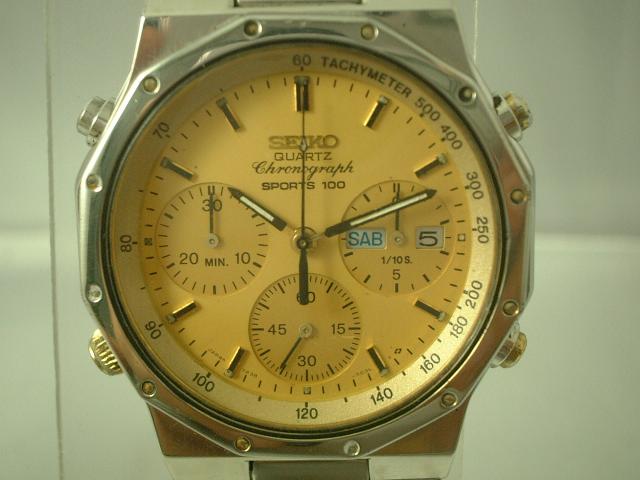

It was once a 7A38-702H, best described as your typical steaming Filipino polished turd, too. It's very very shiny. :lol:
I can't remember my reaction on receiving it, but soon realized my mistake and avowed not to do so again. I removed its original but highly polished B1171C bracelet and fitted it to my SpeedTimerKollektion franken 7A38-7020, which I'd bought two months earlier (as my other 'newbie' mistake).
The watch surprisingly actually kept good time and all the chronograph functions worked. I had planned to break it up for parts, but it ended up just being left in a takeaway container, with some other gash stuff, for at least 10 years ! :cry: This morning I came across said container and the memories of my earlier indiscretion came flooding back. Needless to say, the replacement battery (a Maxell) I'd fitted had been dead for a good many years.
I fitted a new Seizaiken #394 and amazingly it sprang back to life, albeit initially with a bit of hesitation from the 1/10s hand. I also found the very shiny non-original replacement bracelet that came on the SpeedTimerKollektion franken.
The resultant watch is what I call a proper polished turd ! :lol: I'm not sure whether I dare post a photo of it. :P
