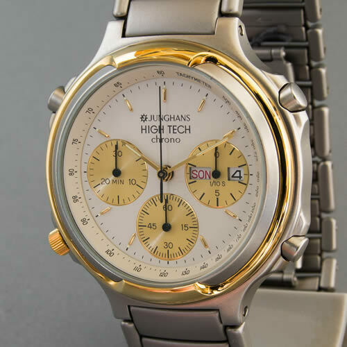

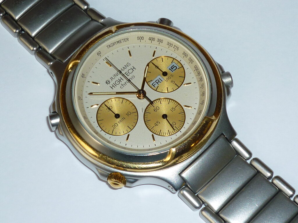

The Junghans 24/4610 High Tech Chrono is, to the best of my knowledge, the only re-branded 'Seiko 7A38' produced by a German manufacturer. It uses a generic unbranded version of the movement, (save for V906A printed on the battery positive plate), similar to the C.G.H. Shimauchi Ltd. V906 (used in Yema N8, etc.) and Cartier Ferrari Formula Cal.531, but fitted with an English / German (EG) day star wheel.
Other than the movement, the watch appears to be comprised of Junghans proprietary components. The watch case measures approx. 39mm diameter and a 19mm wide bracelet, with hidden butterfly clasp, is attached to a 14mm lug width fitting. The watch is coated in a silver anodized finish, with a gold plated (brass) decorative bezel ring. Other than that, only the crown is gold plated. The pushers are of the screw-in splined type, with double O-ring seals. The watch case construction employs plastic gaskets, giving it a questionable claimed water resistance of 50 metres.
Being a slightly quirky design in two-tone finish, they're something of an acquired taste and despite coming from a once hallowed German watch manufacturer, not a particularly popular choice among collectors of non-Seiko branded 7A38s. I've never been averse to two-tones myself and quite like them, personally. Here's an old wrist shot of one of mine, that I posted on the first page of the old forum's WRUW thread.
Thing is, other than posting the odd wrist shot and criticising one particular deceptively described example (fitted with a non-original bracelet) in the 'Wrong Un's thread, I can't remember writing very much about them on the old forum. My omission, which I intend to rectify here, is probably due the fact, that prior to starting the Webs forum in January 2012, I'd already written about them, at some length, in a thread on the UK RLT watch forum towards the end of 2011, here:

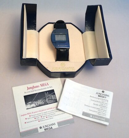

Bearing in mind that Junghans were developing their Mega 1 (the World's first radio-controlled watch) at the time, I still can't fathom what could possibly have possessed their marketing department to call this watch the HIGH TECH chrono. It's a complete misnomer and utter travesty ! :roll: These watches were presumably manufactured in late 1987 or 1988, when Seiko had already been producing their own 7A38's for nearly 5 years. Hence my deliberately facetious title suffix: Rückwärts Nicht Technik. If the movements had been supplied to Junghans as part of any fledgling technology sharing agreement, I'd opine that they got the short end of the stick ! :lol:

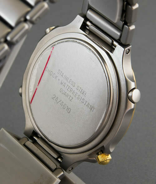

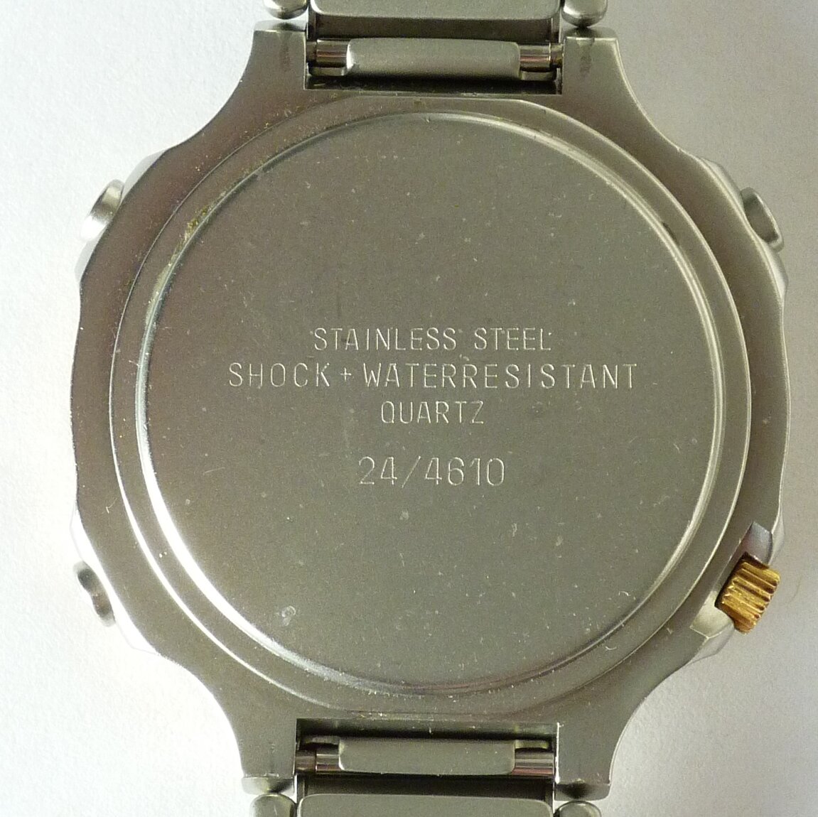

Note that the full catalogue number is 024/4610.44 (that '44' suffix was what made me wonder whether there might be another variant) - same as printed on the paper hang tag in a current eBay listing in a subsequent post. That also shows a retail price of 990 DM (equivalent to approx. 500 Euros). Whereas the watch's case-backs are only stamped 24/4610.
Note that there is no manufacturing serial number - so no means of telling how many were produced. The case-back is a press fit (from memory, the only 7A38 not to have a screw-down threaded case-back) - hence the flat at the bottom, to facilitate insertion of a blade for removal. The case-back is sealed and retained using a hard red plastic (Sanfil) gasket similar to these offered by Cousins UK - visible in my first photo in this post.

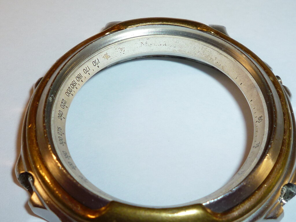

Other useful information can still be found in that old RLT thread, for example a suitable replacement generic crystal.
It was 30.4mm x 1.6mm thick, with no beveled edge. So I ordered a Sternkreuz MSM304 as a replacement.
It's almost identical, apart from being 0.1mm thinner, and indistinguishable from the original crystal when fitted.
A word to the wise (speaking from experience) ....
When replacing a crystal (I've done so in a couple of mine), ensure to check the condition of the retaining gasket ! :!:
The white plastic ones used by Junghans appear to be of an inferior quality and deteriorate over time, becoming brittle and prone to cracking. That's the worst one I've encountered, but I had another which still looked fresh, but broke into two halves when I pressed the old crystal out. I've used both Sternkreuz and Superparts Hytrel gaskets as replacements. Worst case scenario: a damaged gasket will allow water ingress, leading to ruined Tachymeter ring printing, like this:

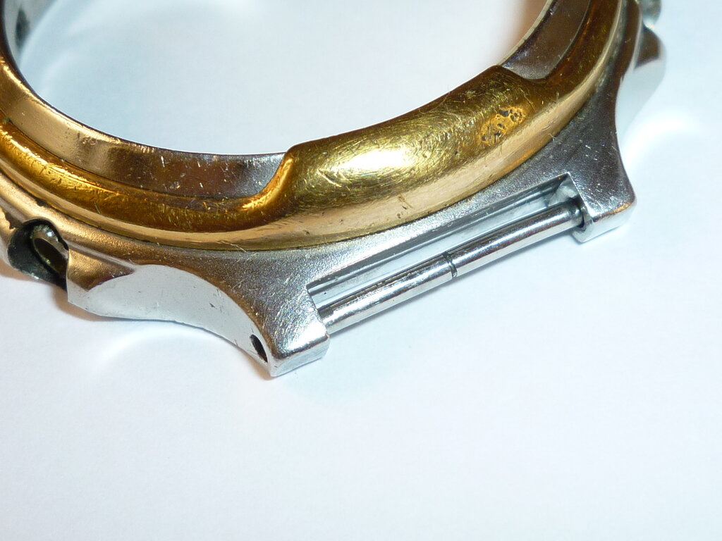

The links are 19mm wide by 6.5mm deep and removable ones are held together by the usual 1.0mm split pins.
Meaning that if you're planning to work on one, you'd be wise to invest a quid (£1) in a pack of Cousins p/n P20857P. ;)
As also shown in a couple of my previous photos, the bracelet is attached to the case using 1.4mm Ø pins and tubes:
This is a similar fixing arrangement to that used by the Yema Spationaute III and N8 Flygraf. However, the Junghans case has much narrower, shorter, more sharply tapering lugs, which makes it extremely difficult to press (or hammer) out the pins, without accidentally marking the lugs. The way I've gotten around it, when either cleaning or working on a 24/4610, is to leave both halves of the bracelet attached to the case, but shorten it, by pushing out the two 1.0mm Ø split pins nearest the case, thereby removing the adjustment links and butterfly clasp, which makes it less unwieldy.

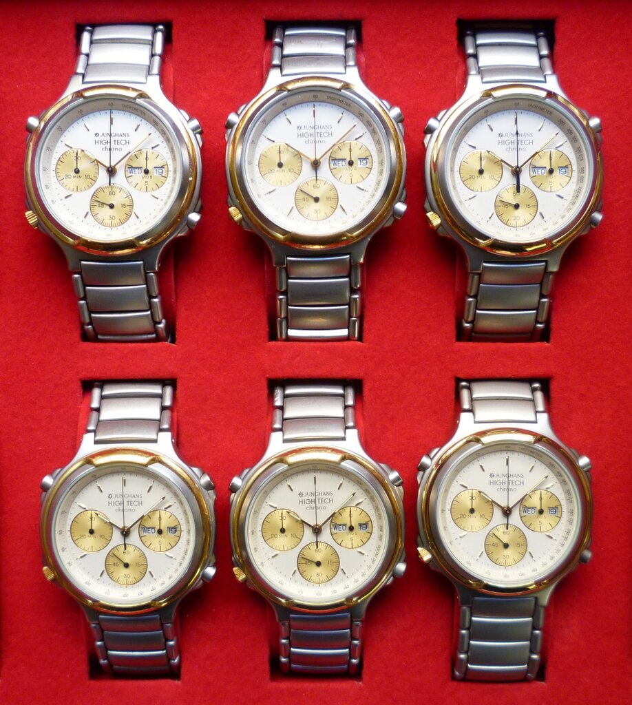

My little collection of them (4 so far). Left to right, in the order I acquired them, first 3 in 2011 and far right in 2018. The best condition example is third from left, which started out as a 'freebee' empty case and bracelet (see below). :)
Checking my records, I've paid less than 100 Euros each for any of them (between 46 and 94 Euros), albeit the majority were acquired nearly 10 years ago in 2011. Probably the best 'bargain buy' was the example I bought from German eBay seller bergjodler58 in November 2011, for 52.99 Euros. To my surprise, along with the watch, the seller generously included an almost mint / complete spare watch case and bracelet - gratis, as a Christmas present, which came with a handwritten note (that I've kept to this day). In an amusing coincidence, the seller (Klaus) lived only 3 kilometres from the Junghans watch factory in Schramberg. The full story (less photos) is towards the bottom of that old RLT thread.
From the various examples I've purchased and others seen listed on eBay Germany over the years, I've observed a couple of subtle manufacturing differences. Principally that Junghans used 3 different black painted sweep second hands. One looks like Seiko p/n 13SC06LC / 3AX130FOALB, but without the lumed arrowhead inlay and another like p/n 13SC04AB. The weight of the dial logo printing can vary noticeably, which may simply be due the tampo process. On some dials, the tiny lume pips at the ends of the hour batons have been omitted.
The one on the right is the first example I ever bought, in too much haste, back in October 2011. It had obviously been messed with, from the black day wheel (which has long since been rectified). It appears to be fitted with a non-original crown, which actually works better than the standard part. I'd also secretly held doubts about the correctness of the sweep second hand, which seems slightly too long, yet perversely has a short tail. I've since seen a couple of others fitted with the same hand - as per the one that's been re-listed on eBay Germany since February, in my post below.

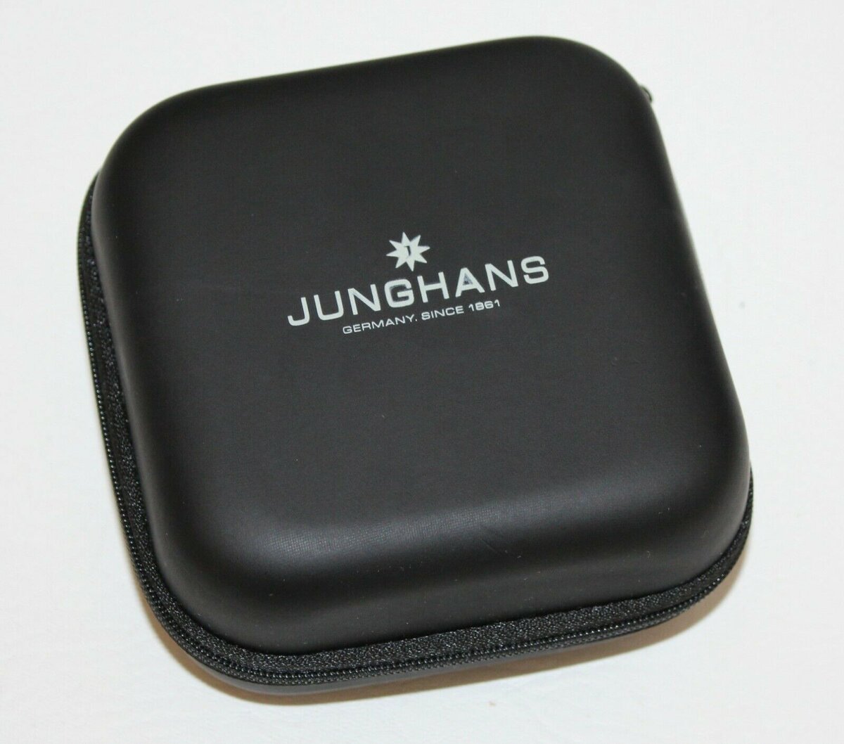

I haven't had any success finding pukka related accessories for them, in terms of the correct original presentation box, hang tag or even a Junghans user instruction manual (of more anon), other than these 3 plastic display stands that I bought for less than 10 Euros, back in January 2014 (German eBay seller's photo).

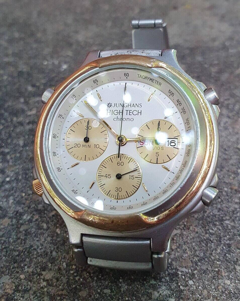

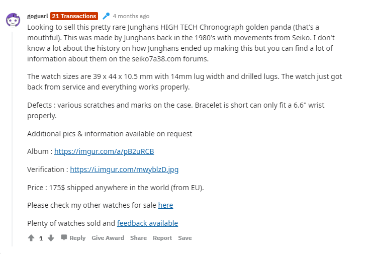

Here's a typical used example, in average worn condition (with unfortunately a rather short bracelet) which that been re-listed on Reddit Watch Exchange by Romanian forum member 'gogusrl' (Andrei) since at least* October last year.
https://www.reddit.com/r/Watchexchange/ ... 38_inside/
rsz_junghans-hightech-24-4610-stainless-gold-creamface-fs-reddit-oct2020-gogusrl-crop-1.jpg
rsz_junghans-hightech-24-4610-stainless-gold-creamface-fs-reddit-oct2020-gogusrl-crop-1.jpg (244.94 KiB) Viewed 503335 times
rsz_junghans-hightech-24-4610-stainless-gold-creamface-fs-reddit-oct2020-gogusrl-crop-2.jpg
rsz_junghans-hightech-24-4610-stainless-gold-creamface-fs-reddit-oct2020-gogusrl-crop-2.jpg (245.57 KiB) Viewed 503335 times
rsz_junghans-hightech-24-4610-stainless-gold-creamface-fs-reddit-oct2020-gogusrl-crop-3.jpg
rsz_junghans-hightech-24-4610-stainless-gold-creamface-fs-reddit-oct2020-gogusrl-crop-3.jpg (195.31 KiB) Viewed 503335 times
rsz_junghans-hightech-24-4610-stainless-gold-creamface-fs-reddit-oct2020-gogusrl-crop-4.jpg
rsz_junghans-hightech-24-4610-stainless-gold-creamface-fs-reddit-oct2020-gogusrl-crop-4.jpg (220.19 KiB) Viewed 503335 times
More photos in Andrei's Imgur album here. *Note the original upload date - 16th August 2020.
I remember asking Andrei where he'd acquired it, a while back. I hadn't seen that one advertised anywhere. Naturally, he replied eBay Germany, which is where these usually turn up. In fact there are currently three listed on there ....

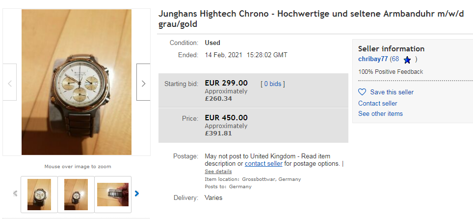

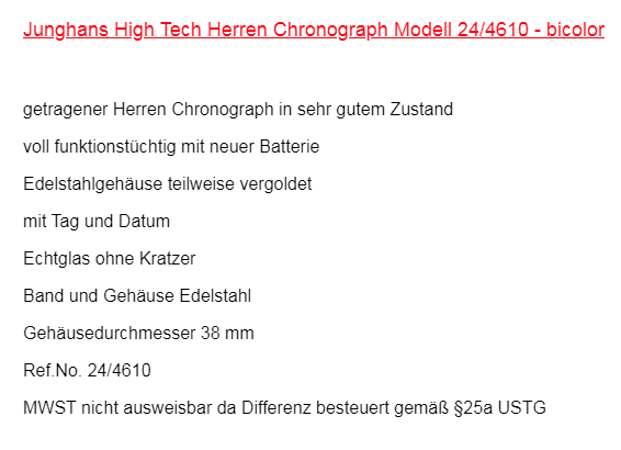

Re: Junghans 24/4610 High Tech Chrono on eBay Germany #1
This average condition example has been re-listed by the German eBay seller, ad nauseam since 7th February this year. Like his subsequent re-listings, it was a 7-day auction, originally with a highly over-optimistic opening bid price of 299 Euros, initially with the absolutely ludicrous option to Buy-it-Now for 450 Euros ! :lol:
https://www.ebay.co.uk/itm/Junghans-Hig ... 4343345861
Junghans-24-4610-HighTechChrono-Stainless+Gold-eBay(Germany)-Feb2021-Listing(EndedUnsold).png
Junghans-24-4610-HighTechChrono-Stainless+Gold-eBay(Germany)-Feb2021-Listing(EndedUnsold).png (132.98 KiB) Viewed 503375 times
Junghans-24-4610-HighTechChrono-Stainless+Gold-eBay(Germany)-Feb2021-(re-listed)-Description.png
Junghans-24-4610-HighTechChrono-Stainless+Gold-eBay(Germany)-Feb2021-(re-listed)-Description.png (19.5 KiB) Viewed 503375 times

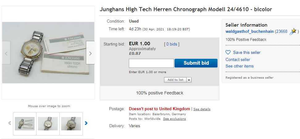

The current re-listed 7-day auction still has 3 days to run and still no sign of any interest yet.
https://www.ebay.co.uk/itm/224431512131
Junghans-24-4610-HighTechChrono-Stainless+Gold-eBay(Germany)-April2021-Nth-Re-Listing.png
Junghans-24-4610-HighTechChrono-Stainless+Gold-eBay(Germany)-April2021-Nth-Re-Listing.png (175.52 KiB) Viewed 503375 times

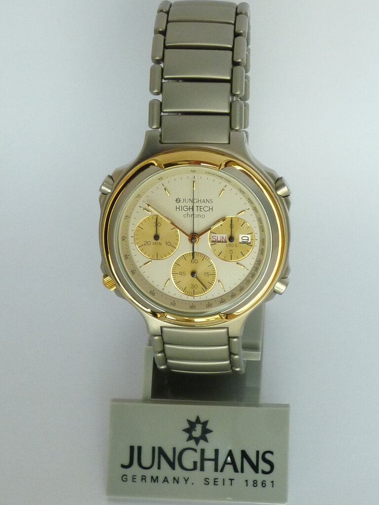

This almost NOS condition example, complete with box, manual and hang tag, was listed nearly 3 weeks ago - 7th April. The German seller's asking price is 295 Euros, which almost looks a relative bargain, compared to the previous example.
https://www.ebay.co.uk/itm/Herren-Armba ... 4723613513
Junghans-24-4610-HighTechChrono-Stainless+Gold-CreamFace-eBay(Germany)-April2021-1.jpg
Junghans-24-4610-HighTechChrono-Stainless+Gold-CreamFace-eBay(Germany)-April2021-1.jpg (47.97 KiB) Viewed 503368 times
Junghans-24-4610-HighTechChrono-Stainless+Gold-CreamFace-eBay(Germany)-April2021-2.jpg
Junghans-24-4610-HighTechChrono-Stainless+Gold-CreamFace-eBay(Germany)-April2021-2.jpg (54.72 KiB) Viewed 503368 times
Junghans-24-4610-HighTechChrono-Stainless+Gold-CreamFace-eBay(Germany)-April2021-3.jpg
Junghans-24-4610-HighTechChrono-Stainless+Gold-CreamFace-eBay(Germany)-April2021-3.jpg (33.67 KiB) Viewed 503368 times
Junghans-24-4610-HighTechChrono-Stainless+Gold-CreamFace-eBay(Germany)-April2021-4.jpg
Junghans-24-4610-HighTechChrono-Stainless+Gold-CreamFace-eBay(Germany)-April2021-4.jpg (33.87 KiB) Viewed 503368 times
Junghans-24-4610-HighTechChrono-Stainless+Gold-CreamFace-eBay(Germany)-April2021-5.jpg
Junghans-24-4610-HighTechChrono-Stainless+Gold-CreamFace-eBay(Germany)-April2021-5.jpg (27.41 KiB) Viewed 503368 times
Junghans-24-4610-HighTechChrono-Stainless+Gold-CreamFace-eBay(Germany)-April2021-6.jpg
Junghans-24-4610-HighTechChrono-Stainless+Gold-CreamFace-eBay(Germany)-April2021-6.jpg (39.13 KiB) Viewed 503368 times
Junghans-24-4610-HighTechChrono-Stainless+Gold-CreamFace-eBay(Germany)-April2021-7.jpg
Junghans-24-4610-HighTechChrono-Stainless+Gold-CreamFace-eBay(Germany)-April2021-7.jpg (17.3 KiB) Viewed 503368 times
Junghans-24-4610-HighTechChrono-Stainless+Gold-CreamFace-eBay(Germany)-April2021-8.jpg
Junghans-24-4610-HighTechChrono-Stainless+Gold-CreamFace-eBay(Germany)-April2021-8.jpg (22 KiB) Viewed 503368 times

Although much of it's been cropped out, I suspect he mounted it on one of those grey plastic Junghans stands, like this:

I've seen that generic light grey and red inner box used on much earlier models. Note the elaborately printed outer box. I've been running searches on 'Junghans Uhrenbox' on eBay Germany for a while, but have still not found what (I think) I'm looking for. :( There are literally dozens of these Junghans Travel / Service clamshell zipper cases on there ....
.... but I've steadfastly resisted the temptation. Like many other manufacturers, modern-day Junghans boxes are huge.

But the one that really caught my eye was this SEIKO blue spring-loaded clamshell Junghans box for a 1991 Mega 1. :shock:
It bears an uncanny resemblance to an Orient presentation box that one of my first J39's came in.
Note the paragraph at the bottom of that Junghans Mega 1 webpage (and ignore the typo's):
The 'PD Book' referred to is: History of the Modern Wristwatch, by Pieter Doensen, published in 1994.

Seiko7A38 wrote: Fri Apr 30, 2021 6:20 pm Here's updates on those 3 recent German eBay listings for Junghans 24/4610 High Tech Chrono's:
The 5-day auction for the rather grubby-looking example, with instruction manual and warranty booklet, ended a few moments ago, selling for 65.70 Euros after 21 bids.
https://www.ebay.co.uk/itm/363373001472

You may recall this 'word to the wise' from my lengthy first post:
Seiko7A38 wrote: Mon Apr 26, 2021 11:51 amMeaning that if you're planning to work on one, you'd be wise to invest a quid (£1) in a pack of Cousins p/n P20857P. ;)
Case in point: the first 4 split pins I pushed out were all very badly worn - and bar one, which I discarded as a matter of course, split into two halves. One pin was extremely reluctant to be pushed out. Turned out that some well-meaning botcher had replaced it with a length of brass wire. Instead of coming out cleanly on the other side, it bent double, inside the centre link section. Took me a while to extract. :x That's what remains of it on the left of the photo. :roll:
Seiko7A38 wrote: Mon Apr 26, 2021 11:51 am The way I've gotten around it, when either cleaning or working on a 24/4610, is to leave both halves of the bracelet attached to the case, but shorten it, by pushing out the two 1.0mm Ø split pins nearest the case, thereby removing the adjustment links and butterfly clasp, which makes it less unwieldy.
The initial clean-up, which simply involved painstakingly scraping off the years of accumulated crud, using the point(s) of a (good few) wooden cocktail stick(s) provided encouraging results after an hour or so's work:

This has to have been one of the filthiest watches I've had the disgusting displeasure to work on in a long time. After I'd carefully scraped away the worst of the crud, it took more scrubbing, rinsing and dabbing away with Rodico to get it to a reasonable standard of cleanliness. There were even bits of detritus under the crystal and around the top edge of the Tachymeter ring. Presumably they got in there when the watch-botcher had opened up the case to paint the hands.
When I was sure the case was completely clean and dry, I tentatively offered up the dial / movement, only to discover that there was a small scratch on the crystal, visible just above the 55 second mark on the constant seconds sub-dial. I can't believe I missed spotting it before. It was probably covered by the greasy film on the crystal, before I cleaned it !
I thought I had a new Sternkreuz MSM 304 crystal in stock, but when I popped it out of the packet, it turned out to be a used original Junghans crystal that I must have removed from one of my other 24/4610's. It had a couple of tiny chips on the edge and another in the middle. I'd obviously deemed it too good to throw away. :roll: I'm annoyed with myself. :x
There's absolutely no point in replacing a scratched crystal with another slightly damaged one. I've now belatedly annotated the packet and will add another Sternkreuz MSM304 to my next Cousins order. It'll have do do for now.

Seiko7A38 wrote: Mon Apr 26, 2021 11:53 am My little collection of them (4 so far). Left to right, in the order I acquired them, first 3 in 2011 and far right in 2018. The best condition example is third from left, which started out as a 'freebee' empty case and bracelet (see below). :)
I guess all that remains to finish off the thread, is for me to add a 'small' collection update. :)
Top Row are the 3 that I acquired in 2011. Left to Right: The first (now rectified) Wrong Un', the one I that bought from German eBay seller bergjodler58 (fitted with a donor dial / movement) and Klaus's 'freebee' surprise Christmas present. Note the three different styles of sweep second hand fitted (all are correct). 8-)
Bottom Row, left to right: the one I bought on a whim in 2018; the recently acquired 'grubby' one and my NOS example.
They're all fitted with the same, most common sweep second hand (which appears very similar to Seiko p/n 13SC04AB).
It was the devil's own job capturing all six watches in reasonably sharp focus and suitably lit (blame my equipment). :P The NOS example is still on its original full length bracelet (with two more adjustment links than all the others), so was reluctant to sit properly. Just when I thought I'd got the perfect shot, I noticed something looked awry with the top LH outer bracelet link on the 'grubby' one. It's just a bit of lint and reflections. Trust me, it's fine. ;) That will have to do !

Seiko7A38 wrote: Mon Apr 26, 2021 12:32 pmThis average condition example has been re-listed by the German eBay seller, ad nauseam since 7th February this year. Like his subsequent re-listings, it was a 7-day auction, originally with a highly over-optimistic opening bid price of 299 Euros, initially with the absolutely ludicrous option to Buy-it-Now for 450 Euros ! :lol:
Junghans-24-4610-HighTechChrono-Stainless+Gold-eBay(Germany)-Feb2021-Listing(EndedUnsold).png (132.98 KiB) Viewed 502367 times

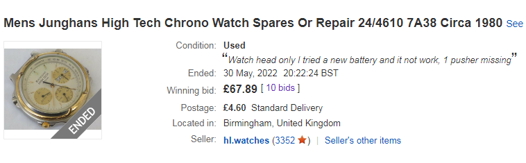

As you've probably gathered, Junghans High Tech Chrono's rarely come up for sale (on eBay or anywhere else) outside their native Germany. Last week I was surprised to see one offered by a UK eBay seller. That said, it wasn't the best of examples, being a 'head only', a non-runner and missing one pusher. It was listed as a 5-day auction with an opening bid price of £10. I did think about buying it for spares, but the bidding soon went well beyond what I was prepared to pay* for such an example, selling for £67.89 after 10 bids. I suspect it was the seller's inclusion of '7A38' in his listing title that helped it to achieve that figure.
https://www.ebay.co.uk/itm/144570968243
Junghans-24-4610-HighTechChrono-Stainless+Gold-CreamFace-HeadOnly-eBay-May2022-Ended-Sold-67.89.png
Junghans-24-4610-HighTechChrono-Stainless+Gold-CreamFace-HeadOnly-eBay-May2022-Ended-Sold-67.89.png (49.54 KiB) Viewed 498249 times
rsz_junghans-24-4610-hightechchrono-stainless-gold-creamface-headonly-ebay-may2022-1.jpg
rsz_junghans-24-4610-hightechchrono-stainless-gold-creamface-headonly-ebay-may2022-1.jpg (241.6 KiB) Viewed 498249 times
rsz_junghans-24-4610-hightechchrono-stainless-gold-creamface-headonly-ebay-may2022-9.jpg
rsz_junghans-24-4610-hightechchrono-stainless-gold-creamface-headonly-ebay-may2022-9.jpg (241.26 KiB) Viewed 498249 times
Judging by the staining on the movement back-plate (and the positive battery plate, which is missing its 'ears'), it appears to have suffered a localized but fairly catastrophic battery leak, so I suspect the PCB will be toast.
*That's rather more than I paid for my grubby but complete example last April.
